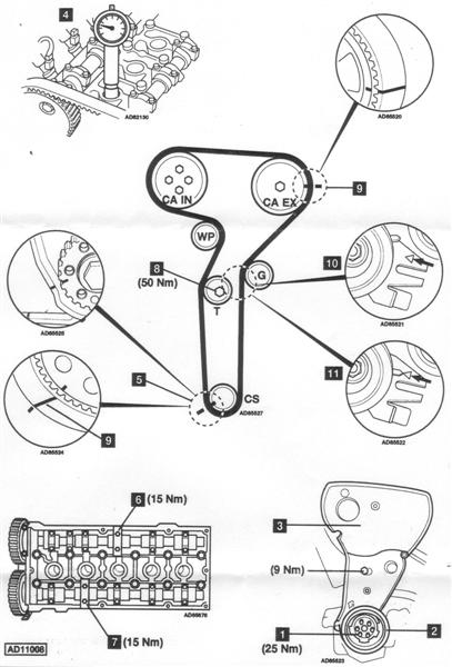

i've had to rebuild my 20v engine over the past week and i have now hit a small problem .Both cam shafts had to come out to fit new valves but on refitting them there isn't any pre marked zero points .
can anyone help with this? :confused:
Do these help?
thanks polecat but the only way to time the cams is to use the locking tool.
this is unavailable to buy anywhere and fiat will not sell these items.
having said that my local fiat dealer loaned me his set of locking tools and the jobs a goodun
thank you very much for your reply. :) :) :)
