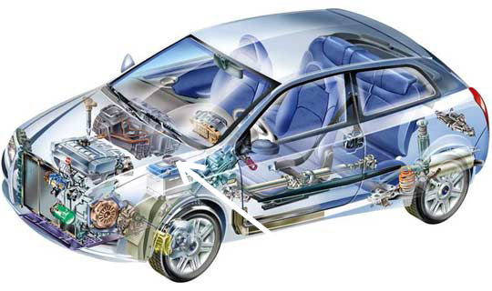

A lot is talked about the D4 connector as mysteriously it didn't appear on early Maintenance CDs and is nicely hidden away from view. However, it is very sensitive to atmospheric moisture, especially when driving through deep puddles. It is the connector for most communications from the engine bay to the dashboard.
To gain access, remove the battery cover, disconnect the battery, and then remove the fusebox retaining screw (1a) as shown below.
