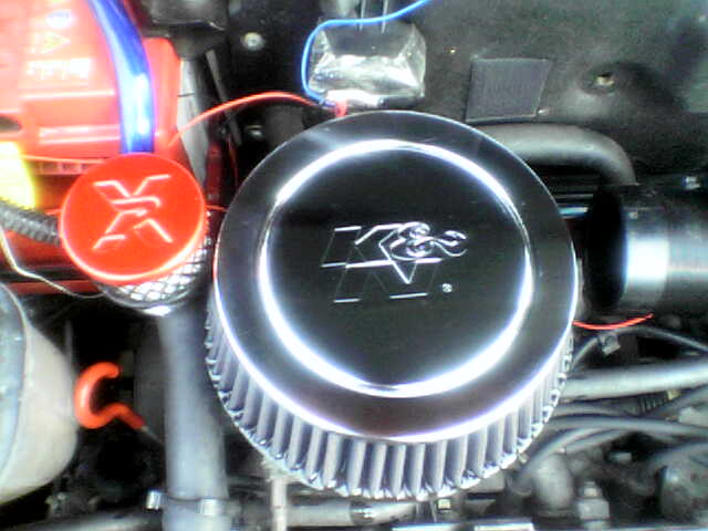

the most commonly bought are the straight on the top of the TB K&N,green,pipercross etc type
in that picture you will see a pipercross breather filter as well.these are now an emissions fail(though some have passed MOT's with them)
the problem with this type of induction kit is they sit right on top of the engine so are surrounded by hot air.
not good for performance.
you can fit a cold air feed which helps but is not perfect

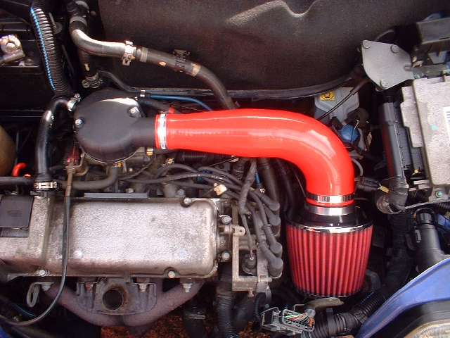

now other options involve fitting the filter remotely to move the filter ot a cooler part of the engine

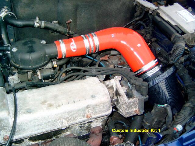

this is liams home made one
if your making your own then you need an 899cc bob for the TB(available from fiat,scrappies etc) a reducing elbow silicone hose either samco or SFS and of course your chosen filter.
obviously there are other options and varients but this just covers the basics

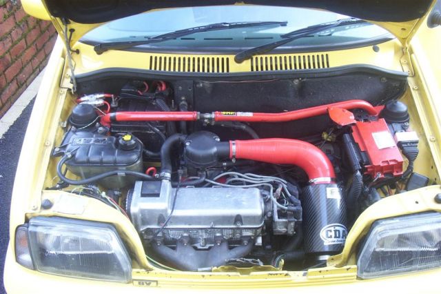

heres arc's with the BMC CDA

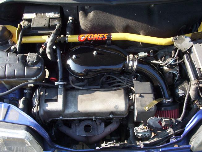

this is an induction kit by a forum member named ArturK
again this has proven gains however being a non uk kit it uses an atmospheric crankcase vent(seen to the left of the TB top)
this is now an MOT fail so be aware of this if considering purchasing one of these kits
