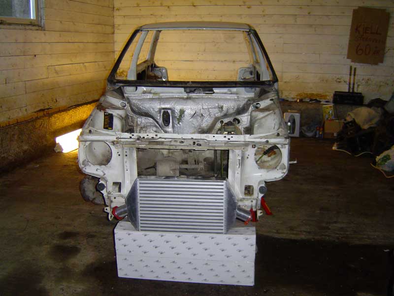

Finally started my project, which I would like to call "FerrUNO" Ferr of Ferrari as the car is going to be painted in Ferrari Red. More about the car will come in another post. Sorry for my frequently bad english :yuck:
The car/enigine is an 1986 Fiat Turbo I.E ( Mk1 ) 1.3l
The car is not going to be registrated on the road for ordinary road use
My plan is to get around 200bhp of the engine, but iam not very experienced in engine tuning. What kind of modifications should I do ?
This is some parts that I've already purchased :
- Brand new uppgrade Mitsubishi Evo8 IC ( Good for 4-500hk) ( BIG! )
- Brand new Clutch from techniclutch in england. Should hold 220bhp or so.
- ('95) Saab 9000T Injectors
Planning to purchase:
- Building new custum exhoust system 2.5" the whole way.
- Chip the engine management ( If its possible ?!? )
- Upgrade the turbo with a larger exhoust-house ?!?! ( is it necesary ? )
Haven't buyed so much parts yet, but i have the whole winter on me to build the car !
Any suggestions on parts that I should buy, and what I should do to make a "200bhp" engine ?

Buyed the IC because the orginal was so small, and because it will look very nice on the car ! Got it cheap to (y)
