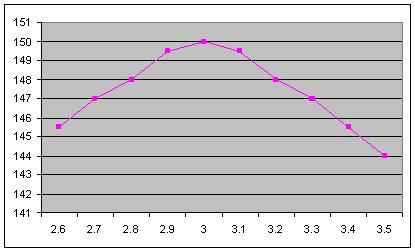

the standard fuel pressure regulator was tested and found to release at 3.05 bar, this produced approx 150bhp. the standard power boost vslve was set at 3.2bar and produced 148bhp, although both the power and torque curves were noticably smoother. with the power boost valve adjusted to 3.5bar the power dropped to 144bhp. those are the only results i have, but using them i've created a curve which shows the effect of the fuel pressure regulation value on power.
obviously i only have 3 results so i have to assume that below the stock valve of 3bar the effect on power will be the same as going above that value (i.e. stock value creates most power), i also assume the curve will be fairly smooth. if this curve is correct it would suggest that the stock fuel pressure regulator is already set at the best possible value for the car.
