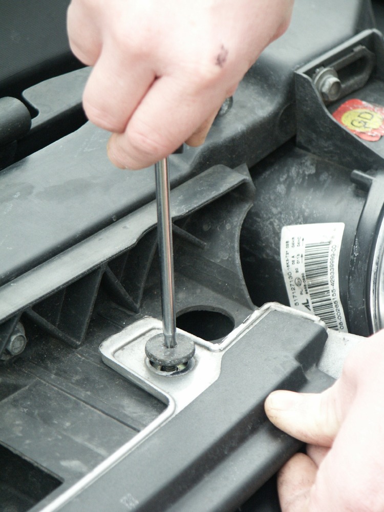

First, undo the torx bolts that hold the top of the bumper on.

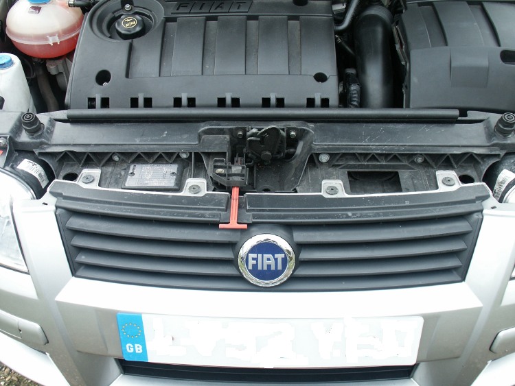

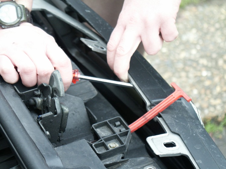

Next, gently pull the bumper forward and look behind it - you should see the lugs that hold the grille in place. With the prybar (or screwdriver) very gently and carefully lever the lugs out.

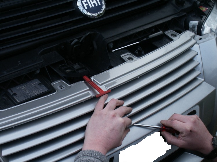

The bottom lugs are a little more difficult so be patient! Place the screwdriver underneath them and gently lever them towards you - you'll hear them pop once they're free.

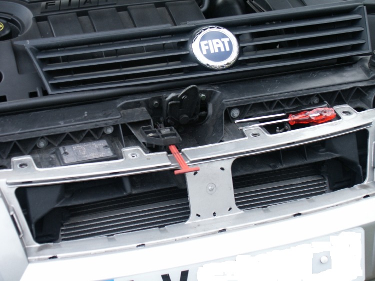

You should then be left with the sight of this ....
