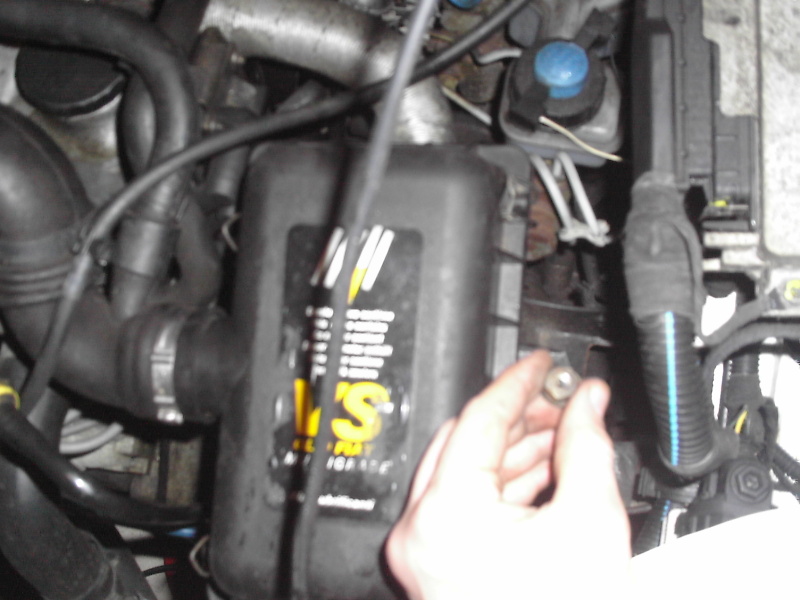

  1. Open the bonnet and undo the 13mm nut that holds the air box in (to the right as you look at it). No need to open the air box or remove the air filter!
  2. Gently pull the air box straight up, a forward and backward wriggle helps get it out of the rubber inserts it seats into. There are 2 pipes which are a push-on fit that have to be carefully removed. The 1st is a rubber pipe which comes from the front of the engine bay and attaches onto the lower-half of the air box. The 2nd is a corrugated warm-air feed from the exhaust manifold
  3. With the air box free, it will flex on the main air pipe (gently now) and lie on top of the engine, with a little wedging.

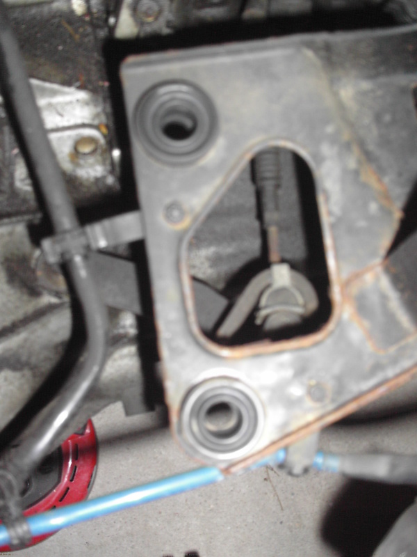

  4. With that out the way, look down through the air box supporting frame and you should be able to see the clutch cable come through the pivot arm and rubber ‘stop’ and be secured with an adjuster and locking nut.

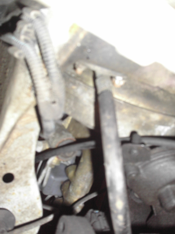

  10. Look at where the clutch cable leaves the pivot arm from where you seen it from above and follow it towards the bulkhead. It bolts onto it with 2, 10mm flanged nuts at a strange angle (try and remember this for re-fitting). You may need to clean these off with a wire brush and give them a good scoot with WD40 or similar. You DON’T want to snap these. If you look at your new cable, you will see that the farther away mounting point is actually a slot. I thought I could take off the nearer one and only need to slacken the other one off a little…. Guess again. After you take off both, keep them safe – they’re teeny! Give a little tug on the cable and break the dust/mud/rust seal which may have formed.
  11. Return to the bonnet and look for the two nuts on the threaded section of the cable. Give the thread a clean to help nut-removal. Grab the nut furthest away from (adjuster nut) you with an open-ended 10mm spanner and put the 2nd spanner on the nearest nut (lock nut), ensuring one spanner-per-nut. Move the nearer spanner to your left and either hold the back one still or do a scissor-action on it to separate the two nuts. Remove both nuts and grab the square section piece of metal before it falls under the car. I presume the rubber stop comes off too, but mine just stayed in place with the power of old age.
  12. Push the threaded part through the pivot arm and through the bracket on the bell housing and tuck it out of the wheel arch where you were sitting a moment ago.
  13. Go back to the wheel arch and carefully remove the cable from the front-end 1st (you may need to untangle the cable from the flexi-hose and side repeater wiring) before removing the cable from the bulkhead (most likely the hooked part of the cable WILL catch on the hole it goes through – show it who’s boss) and remove the cable from the car. Sorry looking thing isn’t it?!

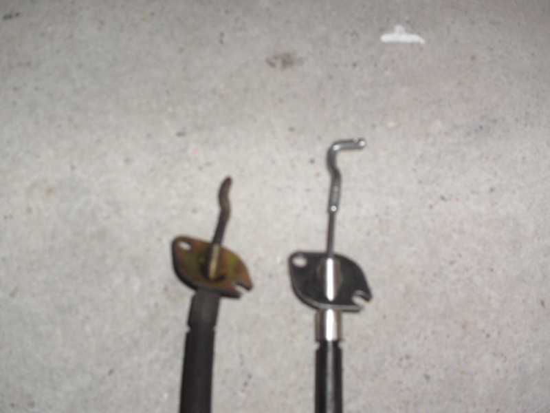

  1. Grab a hold of the new cable and carefully feed it back up the way the old one came out – the object here is to get as little rubbish on the threaded end of the cable and down the outer sheath. Do the threaded end 1st so it is poking out where you can grab it from above.

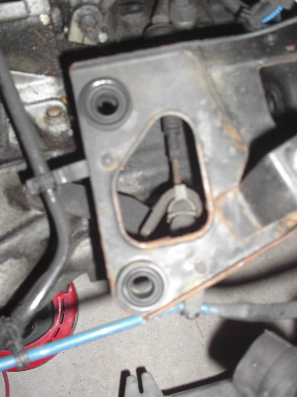

  2. Return to the under-bonnet and find the end u just fed-up. Carefully guide the threaded section through the bell-housing bracket and pivot arm at all the way, then the concertina boot, all the way until the big rubber stop comes up against the bell-housing bracket. Be especially careful not to split the concertina boot section as this will allow all kinds of demonic ingress. Put on the square-section washer and then either refit the old ‘adjust’ and ‘locking’ nuts (after a clean) or, as I did, replace them with M5 new ones (10mm across).
    Important: only put the nuts on the very tip of the cable at this point – you’re going to need all the slack you can get to re-attach the other end!
    Side note – on the old cable I took off and also on the (OEM) replacement I got, what looks like the word “SNAP” is stamped onto the bulkhead side of the fixing plate. No wonder people complain about them breaking – that’s a blatant jinx!
  3. Go back to under the wheel arch and carefully guide the right-angled other end of the cable through the bulkhead before pushing the fixing plate back over the studs (I am SO glad FIAT made these studs and not threaded holes for bolts!).
  4. Take a bit of multi-purpose grease and put a thin smear on the studs before re-fitting the 10mm flanged nuts. DO NOT over tighten – those studs would be a nightmare to replace.

  6. back beside the passenger footwell, you should see the new right-angled end of the cable smirking at you in the corner. With the help of an assistant, or a carefully selected object, prop up the clutch pedal as high as it will go.
  7. This next part was tricky for me – you need to guide the cable back through the quadrant from whence the old one came. With the quadrant fixed in place, either with nimble fingers, or nimbler long nose pliers, gently grab the cable end and pull/push it through until it is all the way back. Don’t give it a chance to jump back out - take a suitable object – I used a fat-handled screwdriver to keep the end as far though the quadrant as it can go.
  8. Now, the REALLY fiddly bit: you need to put the gold washer back over the bit that’s sticking through and then secure it with a NEW split pin. DO NOT use the old one – you are asking for trouble. I lay upside down under the dash to do this – a torch really helps as does the angled long-nose pliers. The split pin feeds in from the side nearest the driver. Once that bad boy is in place bend his little legs back round the pin.

  1. Return to the engine bay and coat the threaded part lightly with multi-purpose grease. Try to avoud getting any on the cable gaiter just behind here. finger tighten the adjuster nut (back one as you look at it from the front of the car) till it is up against the square metal washer.
  2. Go to the driver seat and remove your makeshift pedal prop. MAKE SURE the car is in neutral and the hand brake fully on start the car. Depress the clutch pedal and tentatively try 1st gear. For me, it went in no probs, with a nice, low biting point of about 2cm from the floor. With the old one, it only bit about ¾ of the way up.
  3. This really is a personal preference thing. If you want to make the biting point higher, tighten the lock nut (back one) till the desired point is found. Once you have, finger tighten the lock nut (front one as you look at it from the front of the car).
  4. Tighten the lock nut onto the adjuster nut by placing an open-ended spanner on the adjuster nut to hold it still then tighten the lock nut onto it (turn towards the passenger side). Give a generous coating of grease to the threads for future adjustment
