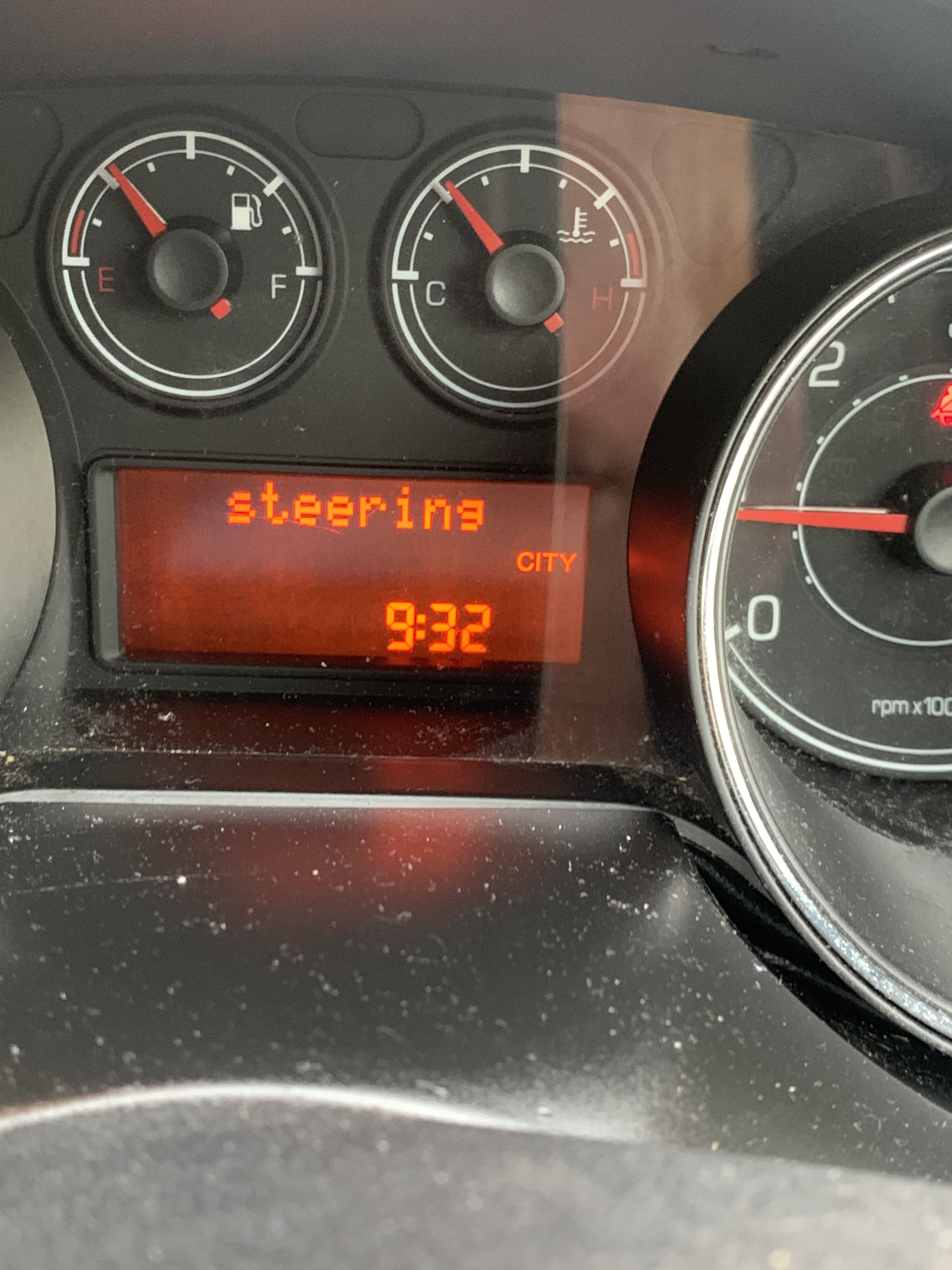

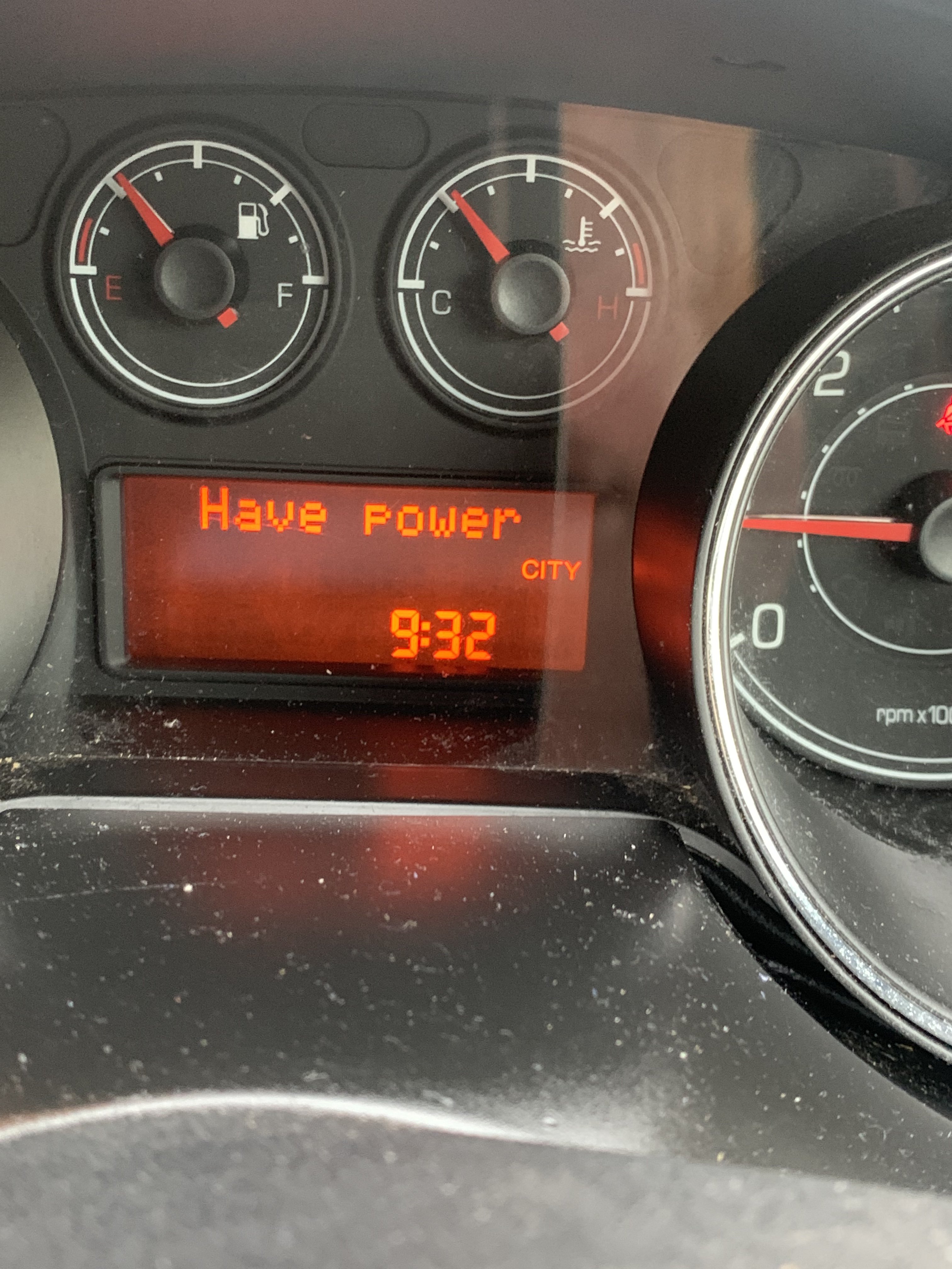

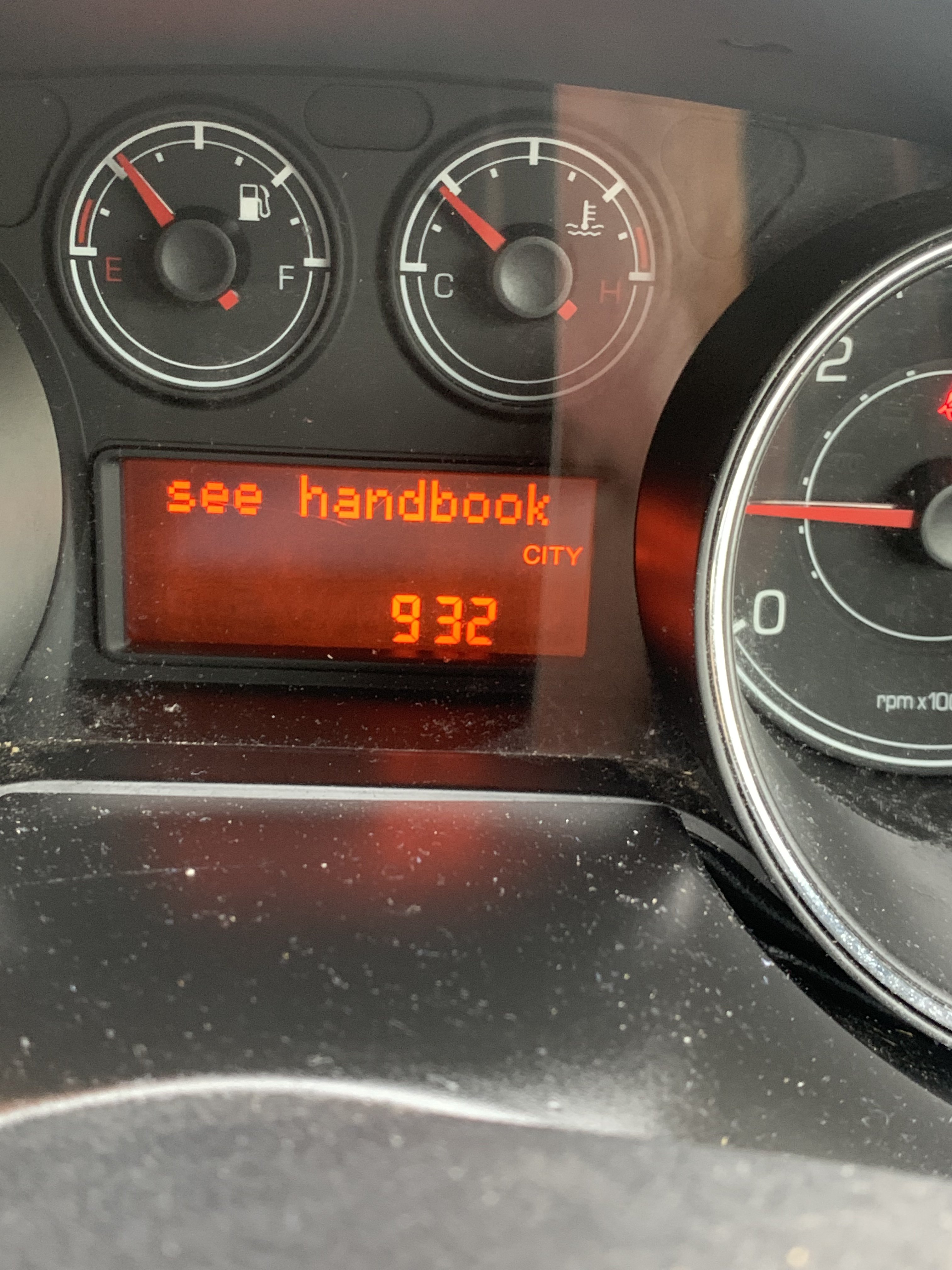

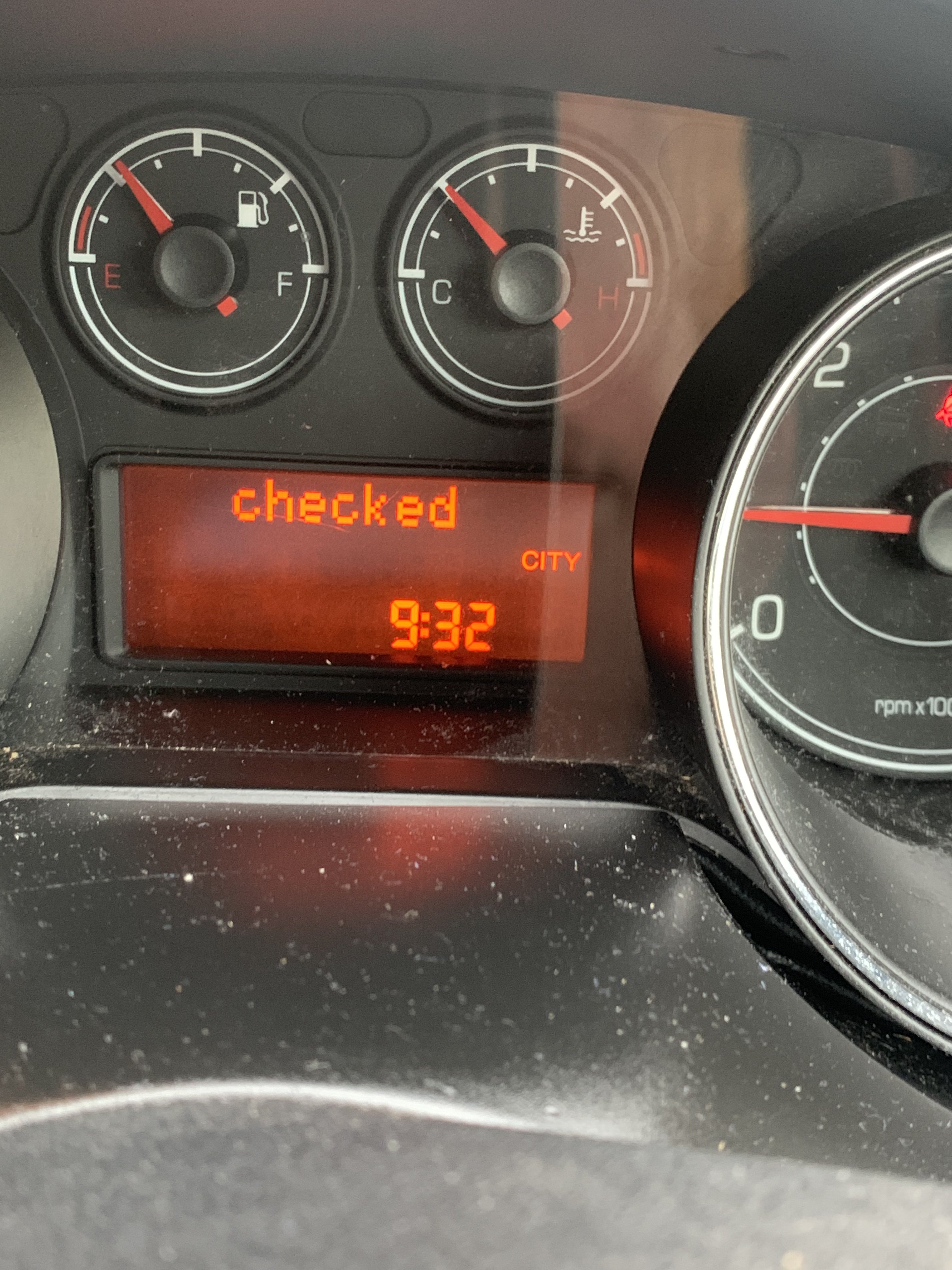

Once the used column was fitted the steering worked flawlessly. But I would still get the “have power steering checked” message and the light on when switching the ignition on.
The fault code the EPS ECU gave was C1103. You could clear the code. And drive the car perfectly without it coming back on until you switch the ignition off and back on. At which point the code and message would reappear.

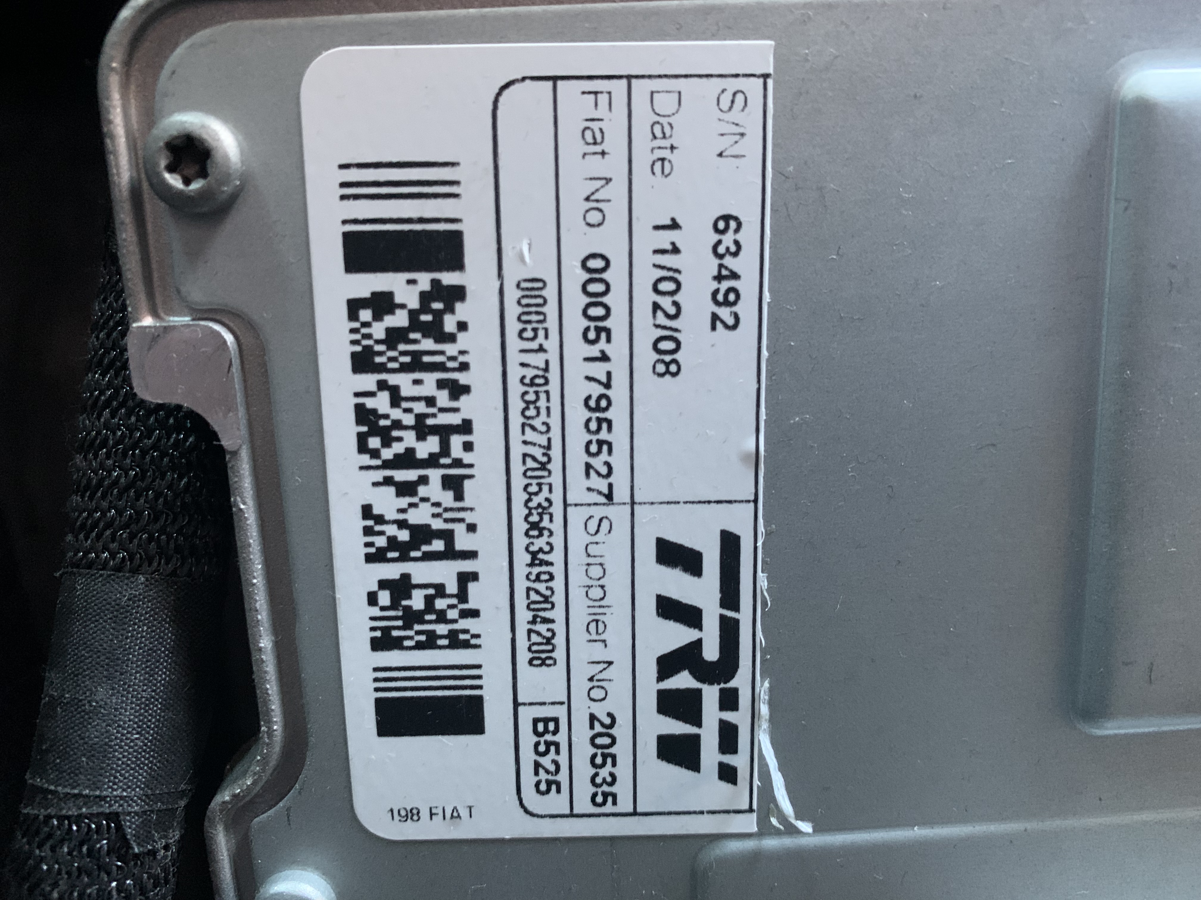

So I assumed that the problem was that the used part I fitted had a different fiat part number (even tho the TSW number was the same) as the fiat number is listed in the ECU parameters.
With that in mind I ordered another used unit. With the correct fiat part No. which I fitted today. However with this one the exact same fault is still there. So it wasn’t the part no mismatch.
