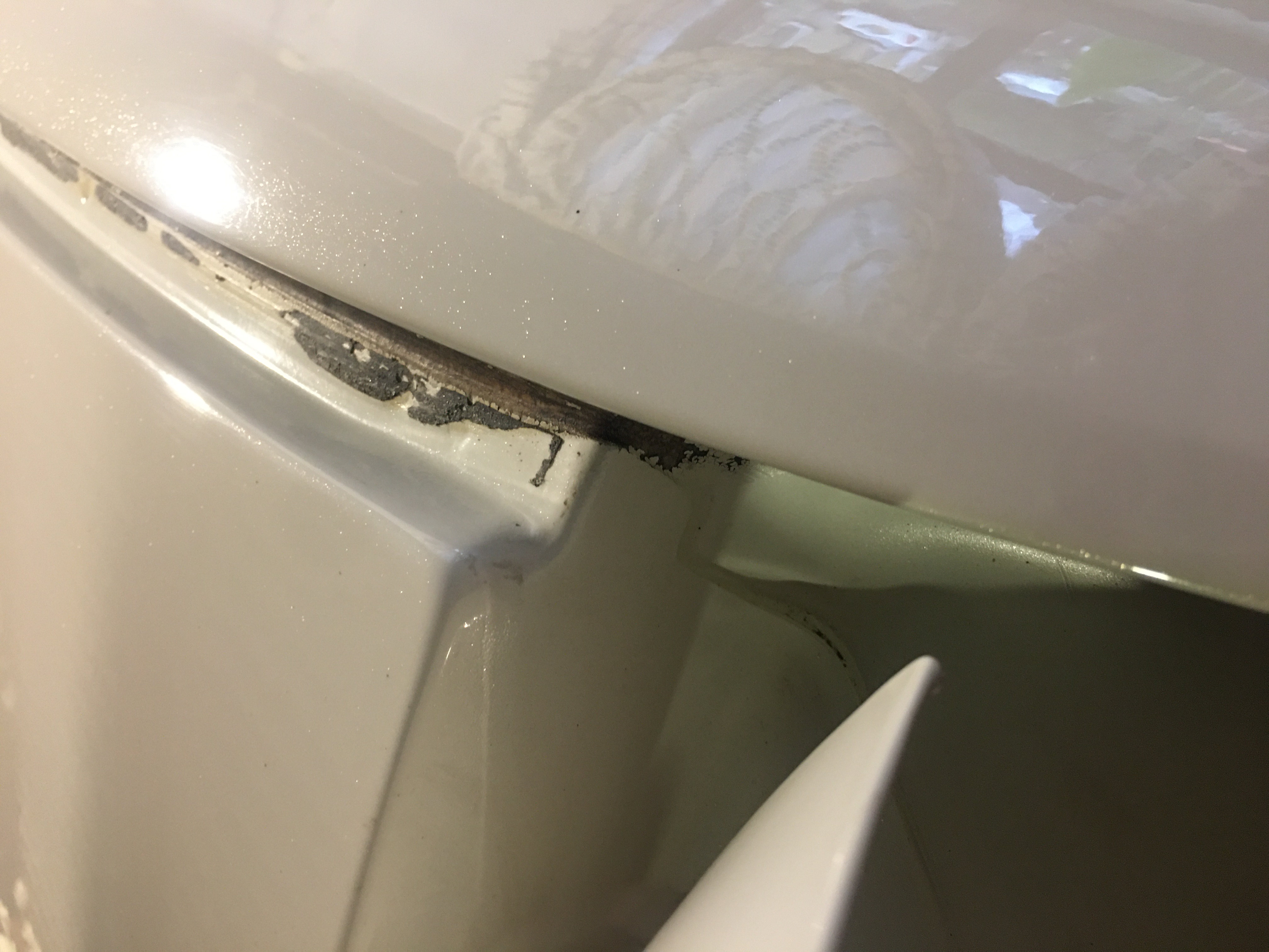

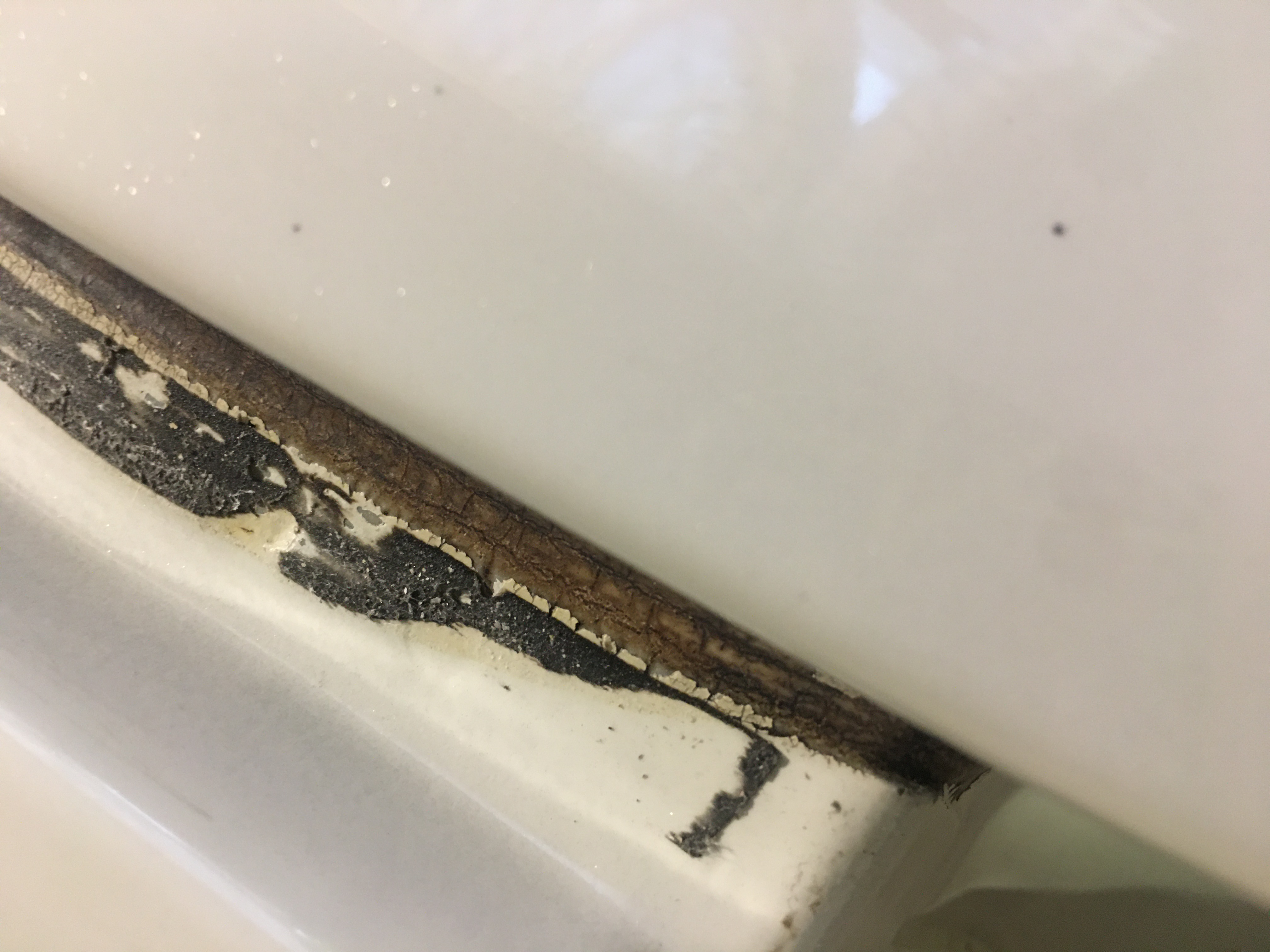

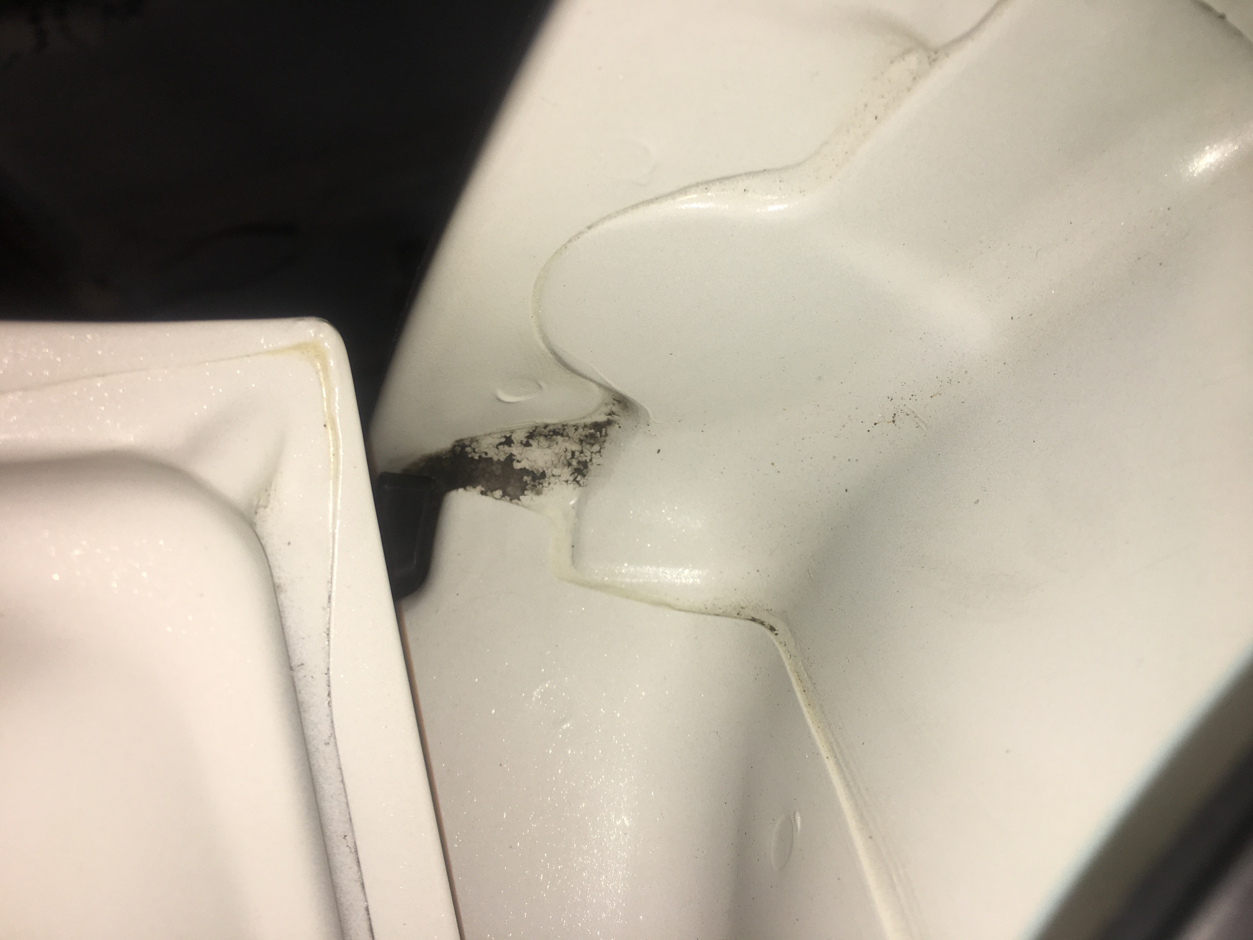

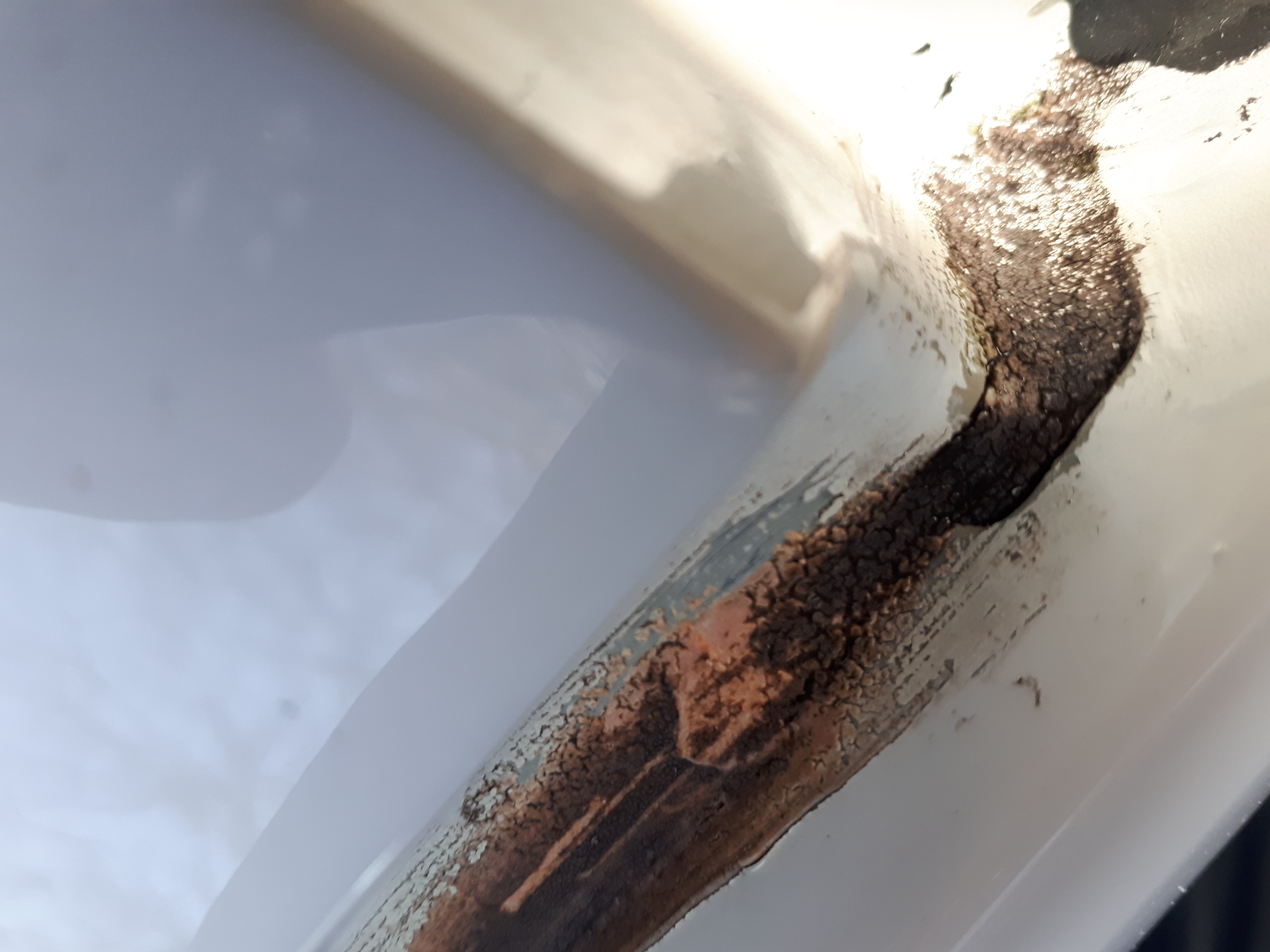

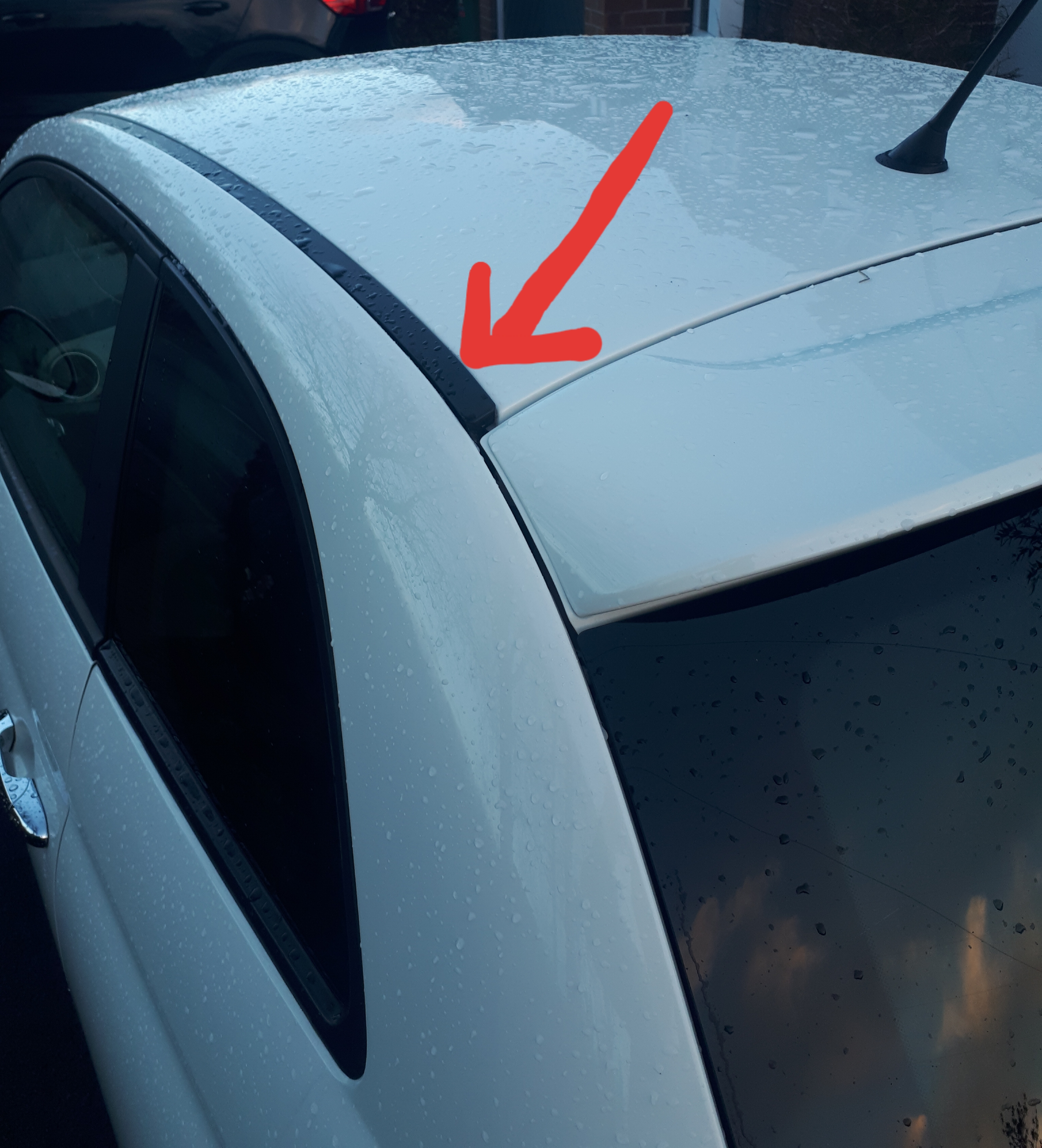

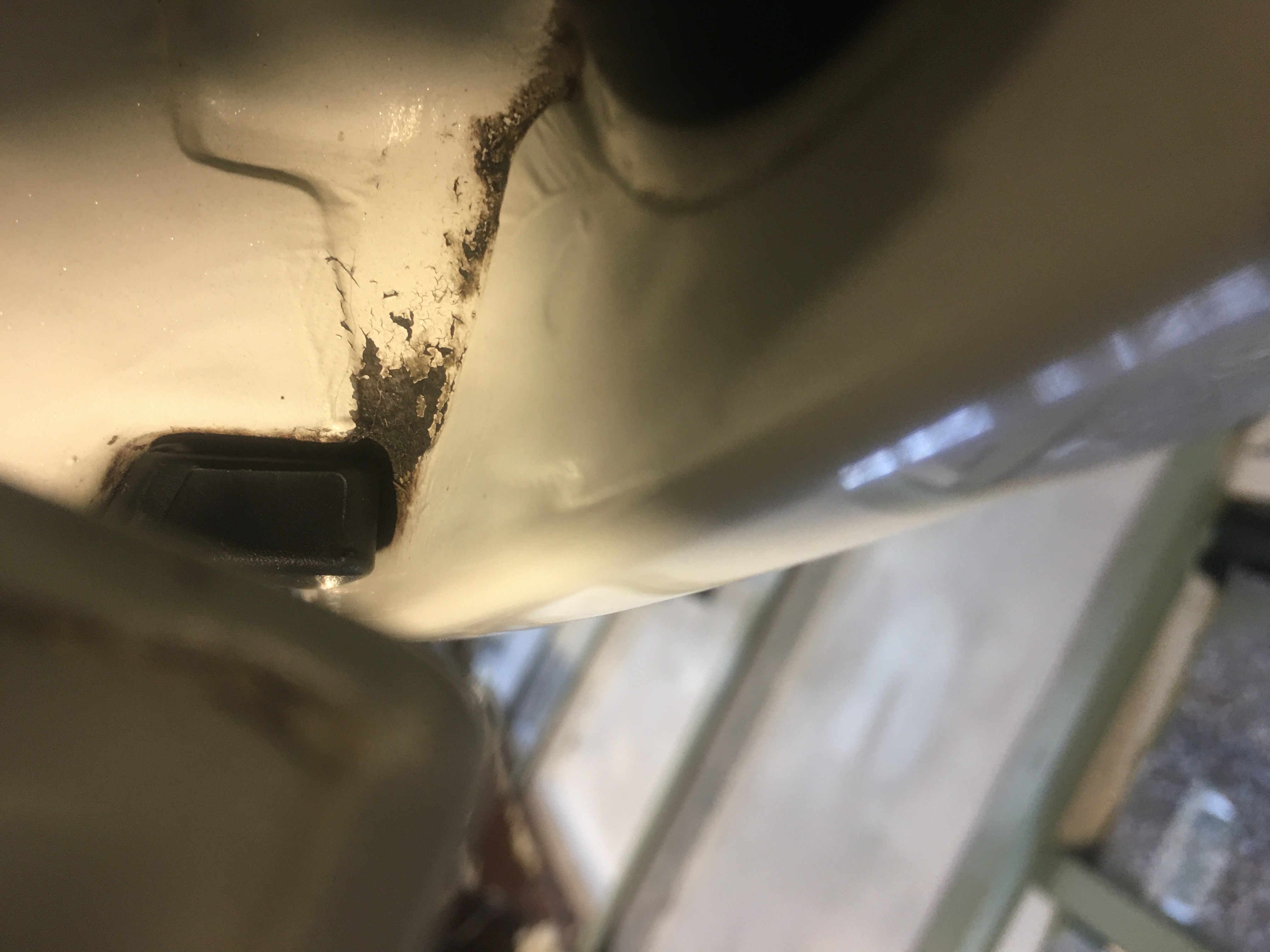

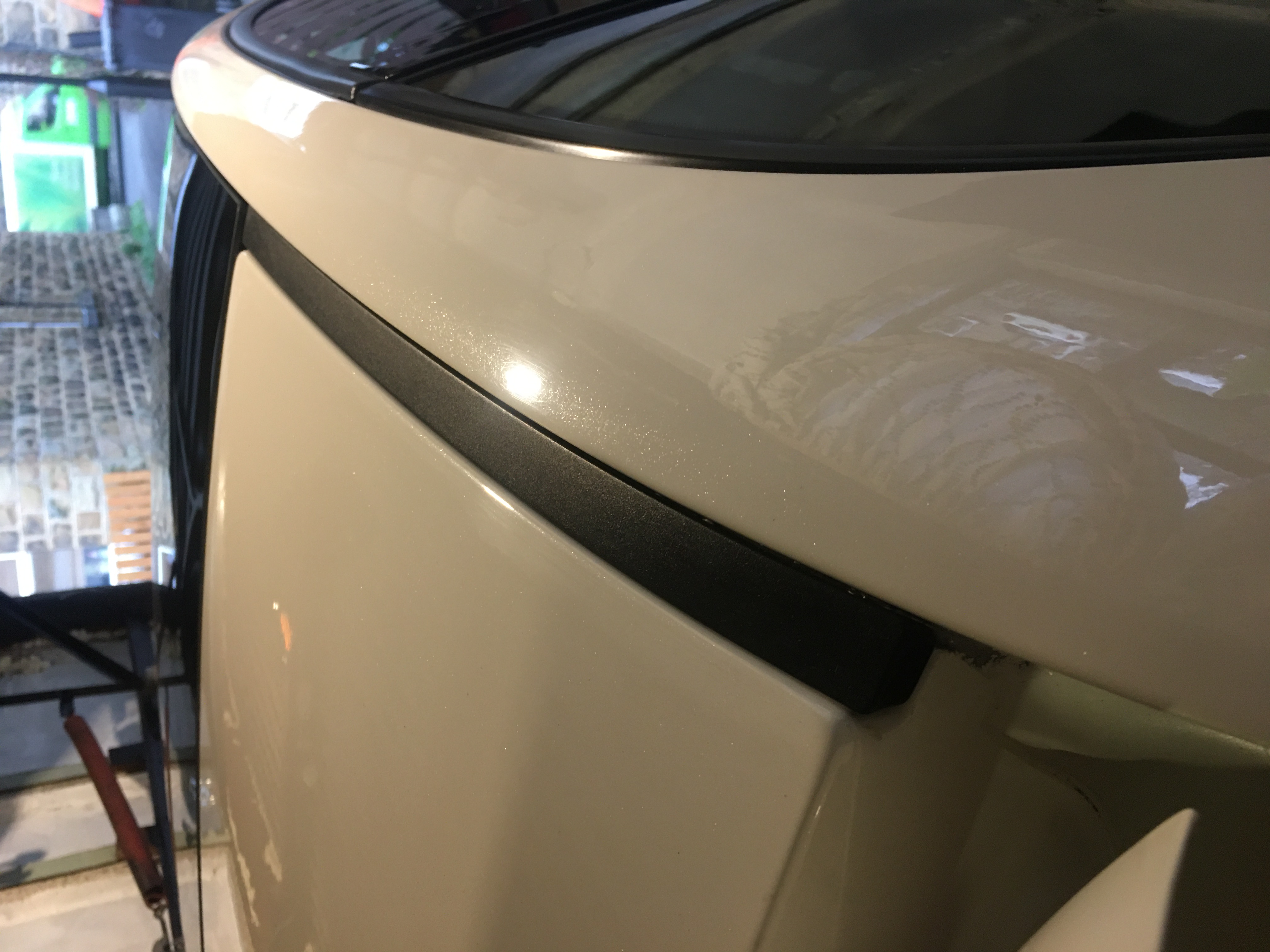

Water traced to coming in through upper rear corner pillar, ending up in the boot and rear passenger footwell. Thought it was the wiring loom as a dodgy repair had been completed previously. Replaced, still leaked. Next the Arial as a small amount of water was getting through. Replaced, still leaked. Thought it may have still been the wiring loom so sealed the joint with guttering sealant as a test. Still leaked! Water...gravity....i know how it works!....in a last ditch attempt removed the plastic roof rail....turns out slight corrosion on the rear joint hidden by the rail. Temp fixed with guttering sealant.....now dry as a bone! The attached picture is taken looking towards the rear looking at the corroded joint with the roof rail removed.
