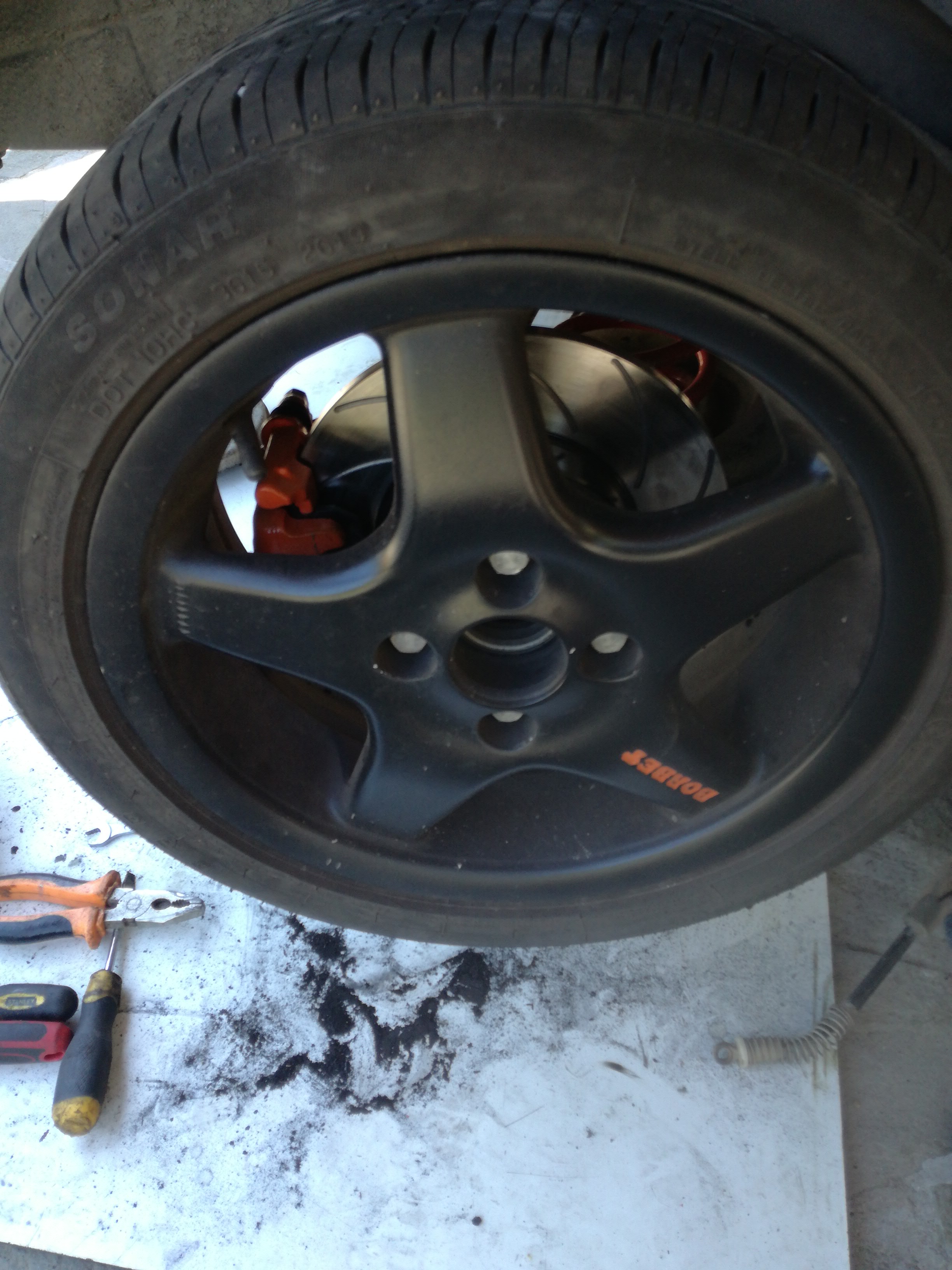

the old rims were very damaged, and I decided to restore 14 Borbets with 2cm spacers and new tires
I installed a new Sparco knob, a sports steering wheel, water temperature gauge, oil, oil pressure and a voltmeter. New Sparco mats. The future, long-term project is to mount a nice 1.4 16v engine underneath and for this I am updating the braking system with 257mm discs at the front, and 240mm at the rear. As a set up I went on Eibach -3cm springs and Bilstein B6 shock absorbers.

thanks for your interest. It's been a long time since I wrote and there have been some updates. The brake calipers have been overhauled, painted and mounted with new discs and pads.
I also adapted the handbrake cable so it finally works as it should. another step was to mount the trim and camber plates.

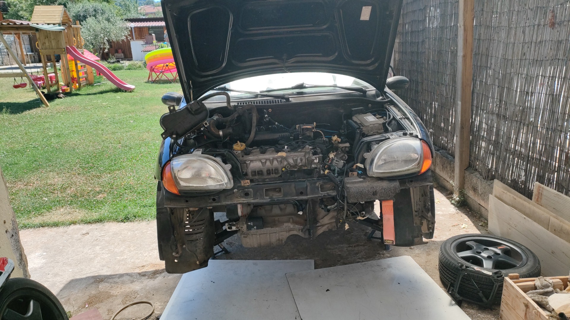

It's been a long time now, for family reasons and no, I had to postpone the swap several times. But this time I started for real and it's my first time to change an engine. The first day I disconnected all the wiring, taking care to write down the various types of sensors and managed to pull the motor down. Today I started fitting the new clutch, cleaning the gearbox well but they called from my daughter's school and I had to stop to pick up the baby. I will resume work next week and I think I will turn to you for advice and help. some photo
hi guys, as you can see the works are going on and the engine has been mounted under the car. Obviously the clutch, timing, spark plugs, spark plug cables and more have been changed first. From Monday we will start with the cut and sew for the wiring and something else that needs to be adapted. Could someone be able to help me with the coolant hoses and the petrol vapor filter? I am looking for information on connections.
