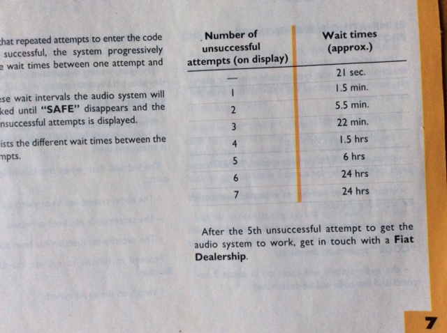

A copy of my handbook page is here. It gives waiting times corresponding to how many unsuccessful attempts have been made up to 7 tries but after the 5th attempt a visit to a Fiat dealership is required.
Maybe I am missing something but that seems a bit daft. Perhaps "lost in translation" applies?

You may have to have the ignition on and the radio showing safe for the required waiting time before safe disappears and you can enter code.
Thanks Jackwhoo, a good idea. I will be away from home and the B for about 16 days from tomorrow but will give it a go on my return. Is it okay to leave the ignition on for say 24 hours without doing any damage? Will hook up a CTEK battery conditioner/charger, an excellent bit of kit by the way.
I do not know if the radio and ignition have to be on for 24hours continuously or if the the 24 hours counts down continues every time both are on.
I also do not know if it is safe to leave the ignition on for that length of time and do not want to guess.
Apologises.
Fingers crossed someone on forum will be able to say for sure.
May I suggest you have radio on showing safe every time you drive , hopefully safe will disappear.
