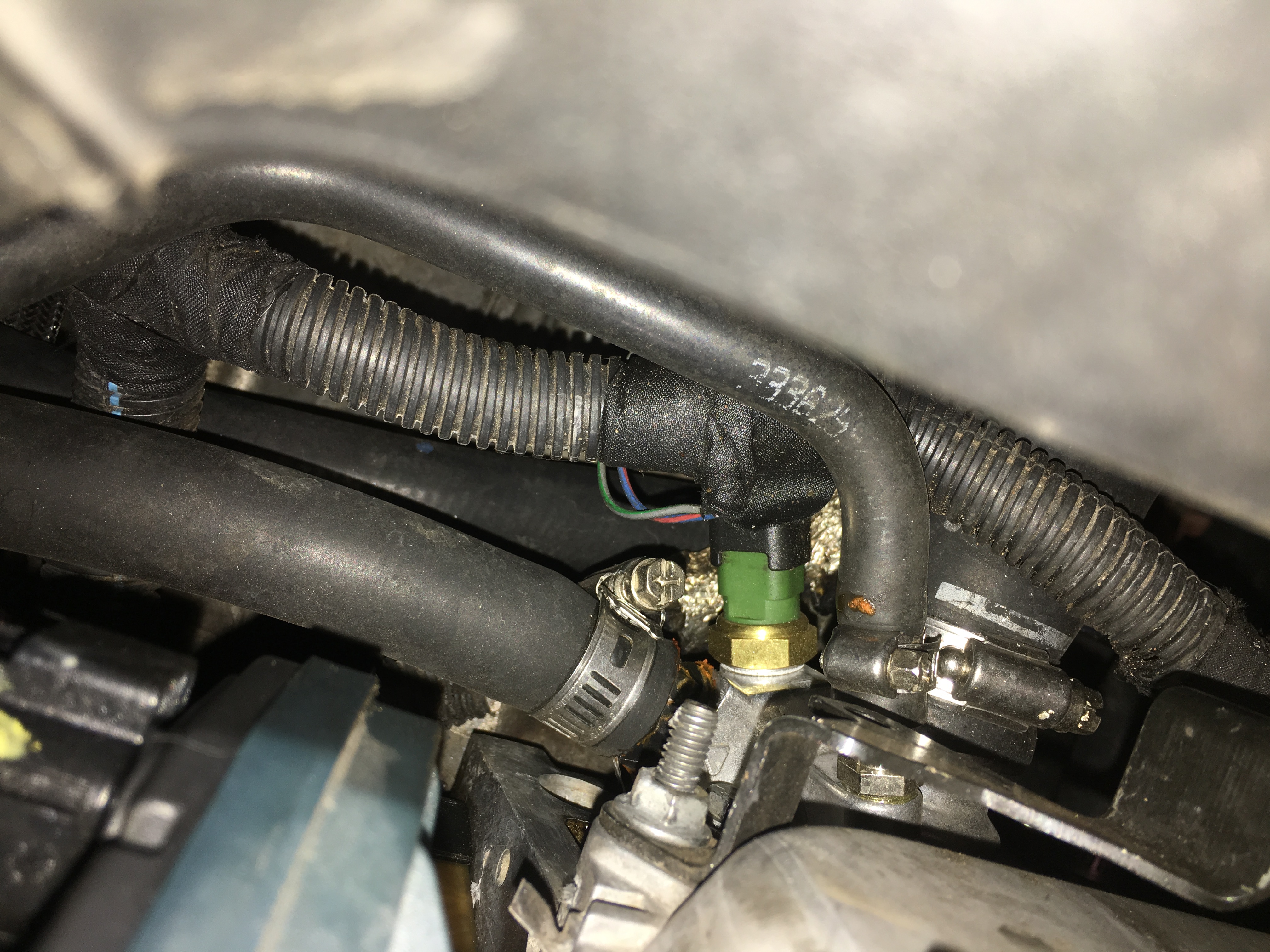

From what I can tell the 1.4 has only one sensor too, right on the thermostat housing. I cannot recall the color of the one that came off but I know that the replacement was a different color. This is why I took a temp reading.
I’m also starting to think that the reader might be at fault because the temp is through the roof, even if I convert to degrees Fahrenheit it doesn’t look accurate. Also O2 sensor upstream should fluctuate between .4 and .8 and mine is between 1.4 and 1.8v. Why the extra volt? All I can think is that the reader might be adding the ambient and the water temp together? Also adds 1 volt to the O2? I don’t know, it is a very reputable brand this side and the software is up to date. It was a pretty expensive reader and we use it for the workshop everyday all day. Can anybody recommend a reader that can stream live date with a quick response and offer scoped readings?
At first glance the plug looked fine but when I had a closer look and compared with ngk’s pics it is quite clear that its lean. It’s burning white as in a4 page white.
As always thanks for all the help guys
Just replaced my (100HP) thermostat and the sensor was brown (opening temp 88 degrees) My son's Tjet MiTo uses a fysically same thermostat (ordered at the same time) with a green sensor (opening temperature 80 degrees).
So although I could switch them out, the MiTo thermostat would open too soon anbd leave the engine too cold. Dial in the dash would still be in the middle though as long as the enginetemp stays between 80 and 100 degrees.
gr J
The new sensor is green. I do recall the old one being brown.

I think I might still have the old one. I’ll have a look thank you for the advice.

Update: I removed the catalytic converter, cleaned 02 sensors, checked injector spray pattern, cleaned injectors, replaced the temp sensor. Still inaccurate reading from it
