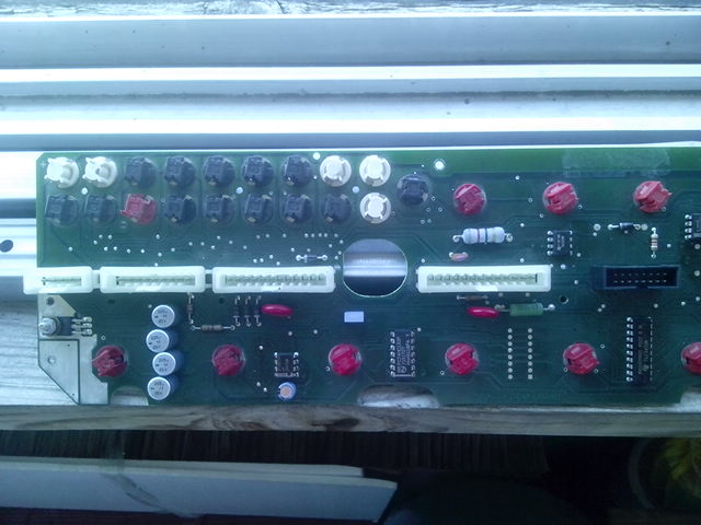

A asliyucegsm New member Joined Jun 12, 2009 Messages 1 Points 1 Location kırıkkale Dec 11, 2019 #1 my friends tempra borg dashboard pinout tempra dashboard need connectors to work on table +12 volt and gnd thanks Attachments 1 picture.jpg 77.2 KB · Views: 317

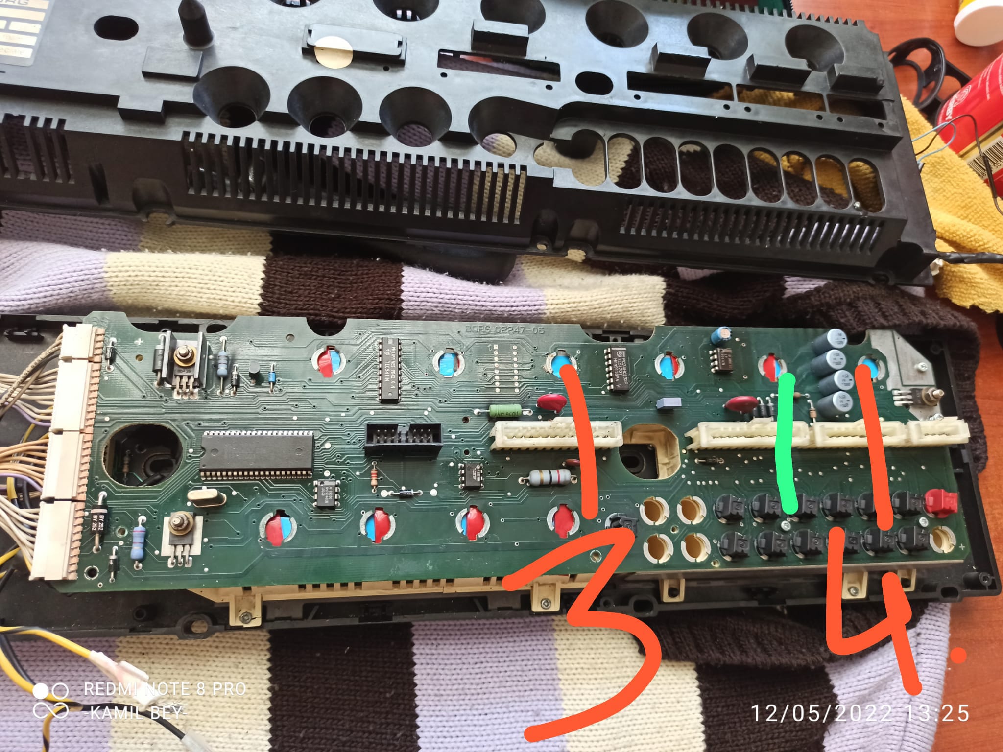

Kamil Akkan New member Joined May 19, 2022 Messages 1 Points 0 Location Türkiye / izmir May 19, 2022 #2 Resim göre sağdan sola Kırmızı renkler eksi şase yeşil olan 1. Pin artı 12 v Attachments IMG-20220512-WA0012.jpg 408.8 KB · Views: 122
