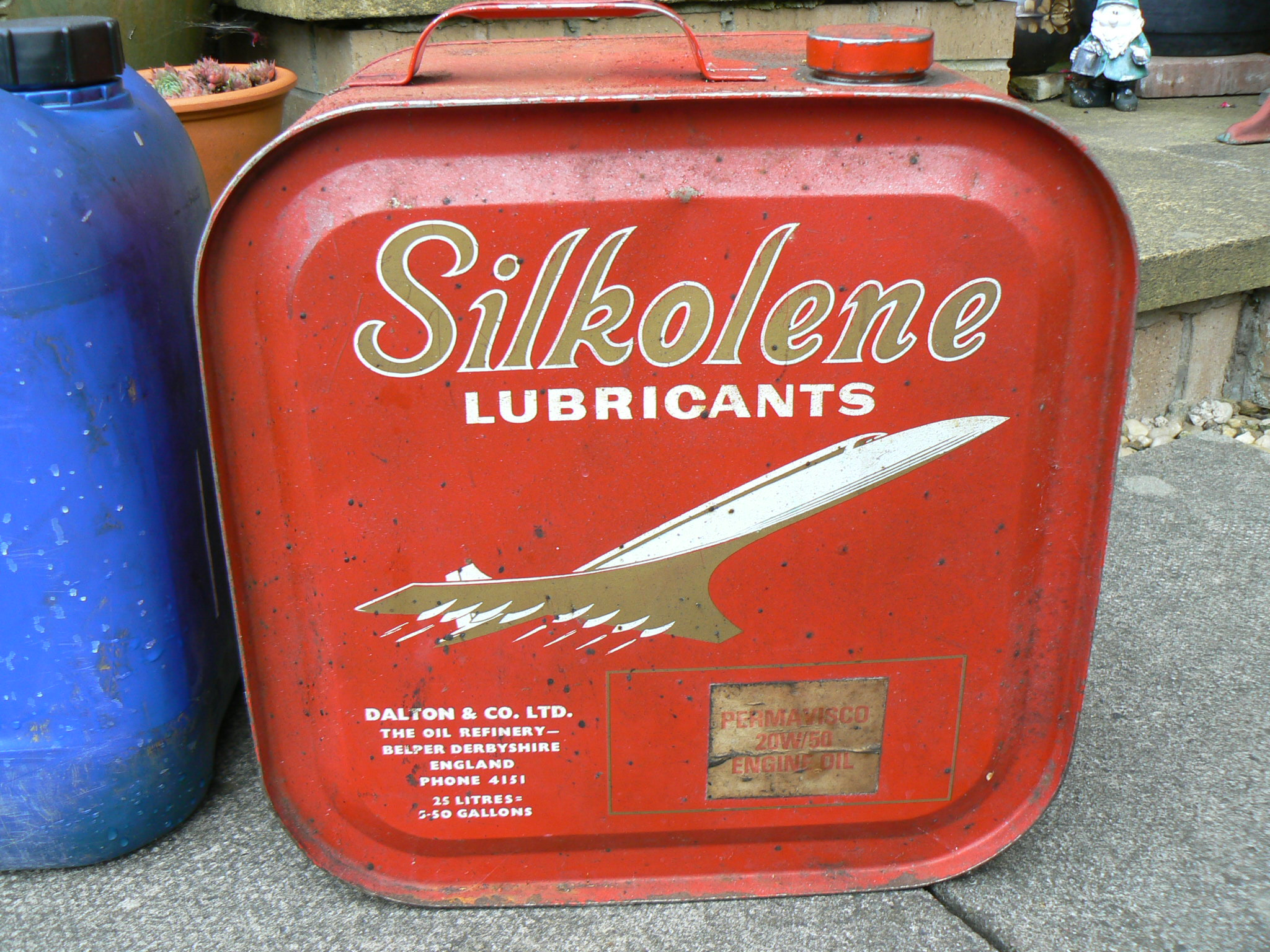

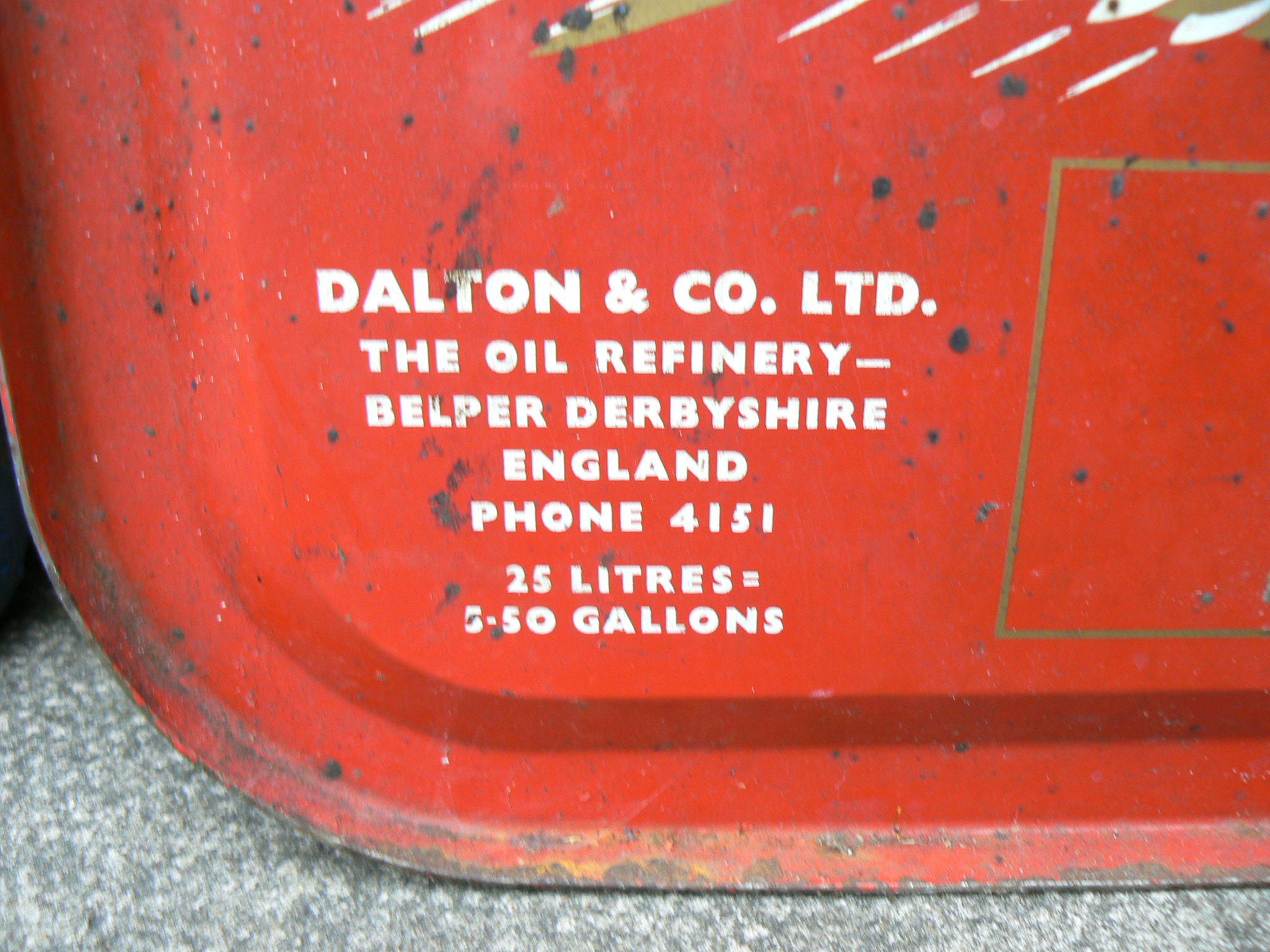

Oh, by the way Saxon 78. I discovered, a wee while ago, That Fuchs are now the supplier of the Quantum branded oils to TPS. (TPS, as you may know, are a trade parts business owned by VAG as far as I can learn.) Fuchs openly announced this a while ago. Previously it was Castrol (from what I've read). So, if this info - all gleaned by Googling - is correct, I would be tempted to assume that Fuchs know a thing or two about formulating VAG suitable oils?
Yup, as far as I know Silkolene is a Fuchs owned brand and seems to be heavily angled towards motorcyle products.
Until I have enough to be worth a trip to the recycling centre I keep my waste engine oil in two large old cans (around 5 gallon size) The one I use most is a heavy duty plastic container which originally contained diesel oil. The other?
You can see a little bit of the more modern blue plastic container to it's left. I've had the Silkolene can for so long I don't remember anything about when or where I acquired it! Hopefully it'll outlast me. At 5 gallons when full they are both just about liftable up to the inlet to the tanks at the recycling centre. Just of late I have to admit to not filling them to the brim though! Here's a couple of other details which might be of interest.

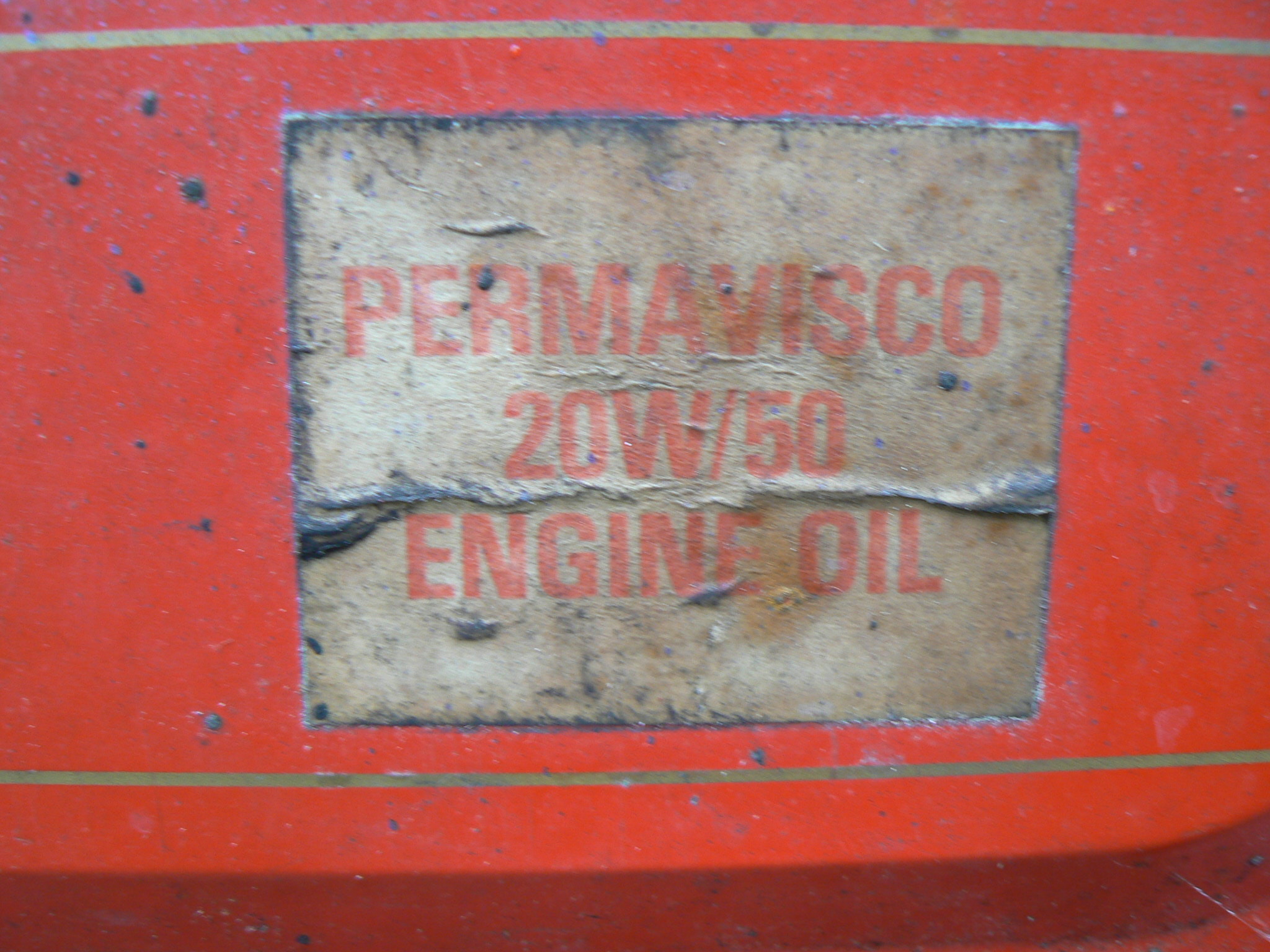

I especially like the stick on label describing the contents - Takes me back to simpler times when you could tip 20W-50 into just about anything that wasn't air cooled (they would take SAE 30 in summer and SAE 40 in winter - yes, 2 oil changes a year ideally, and they were all the better for it!
