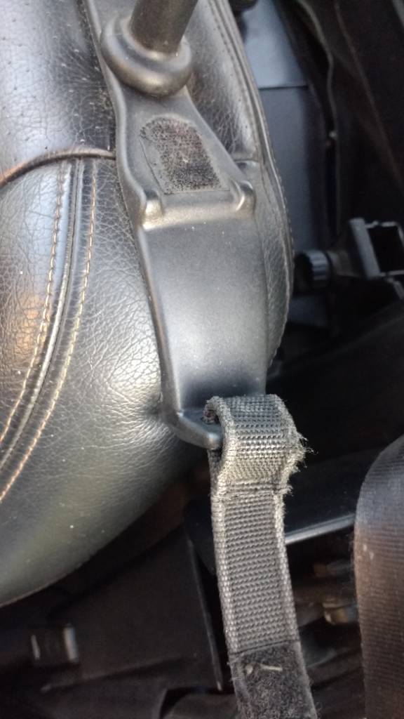

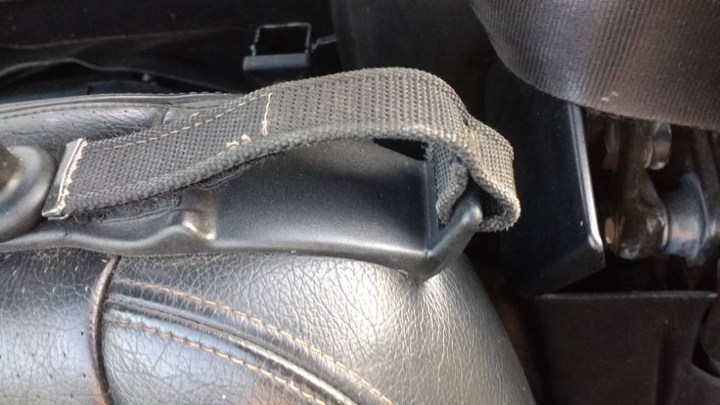

Anyone know hope to detach the plastic bit that guides the seat belt on the top of the seat? It goes around the head restraint posts, do I have to take the head restraint of by dismantling it with the screws on the underside....
I just wanted to replace the velcro as it's not gripping any more, it would be a bit tricky to use a sewing machine in mid air!

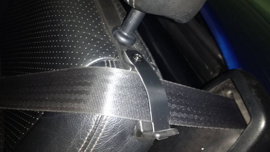

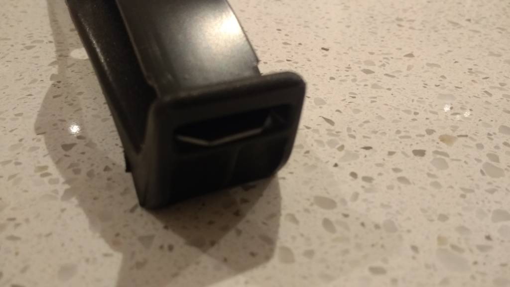

Here you go. Looking at it I think it would be quite simple to replace the strap with a bit of flexible black plastic that can 'latch' into the slot the current strap is attached to....next job after I've painted my garage floor! IMG_20190927_182419733.jpegIMG_20190927_182407436.jpeg
Well, I've 'engineered' a solution that looks much neater and works better than the velcro straps. I fashioned some flexible black plastic in to a shape approximately 100mm long by 23mm wide, gave it a little tongue so it can slot into the slot where the old velcro was looped round, and put a small nut and bolt at the other end. It then stays in place until you manually bend it out.
A spot of black paint on the bolt head and job done.
By the way, the headrest can be removed if you turn the posts 1/4 turn clockwise, I used mole grips, but protected the plastic with a cloth.[emoji16]IMG_20191020_191617307.jpegIMG_20191020_191628458.jpegIMG_20191020_193049430.jpeg
