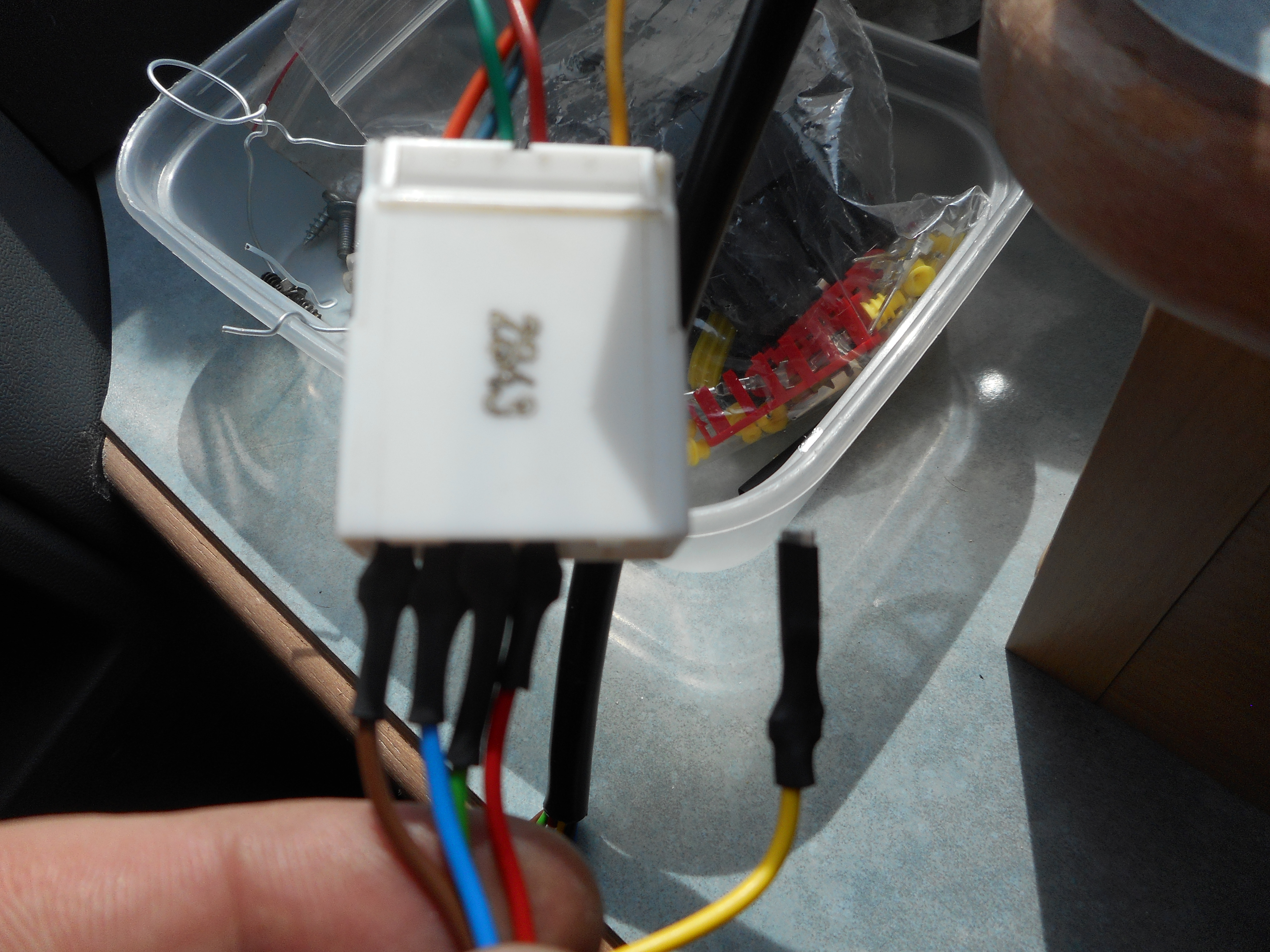

4 of the 5 cruise stalk wires excluding the yellow connect into the 4 on D018A as seen in my pic- this is just to illustrate the connections, connecting themas per the Italian diagram below- watch the mating of one colour toanother as they do NOt match, I pushed the stalk wires into the black connector to see how well they fit/could they be reused? Short answer, they fit Ok but are hard to put in place so I had a plan B. Then you will need the wires extended across to the the steering column, whether left or right. I used spare 7 core trailer wire as I had some, if 13 core trailer wire is used, so much the better as it contains an orange one that is not in the 7 core and you can match stalk wire colours 100%. I had to sub the brown for the orange, and not forget I had done so.
I chopped the thin wires where they entered the black connector and used an ex PC 4 way Molex connector as the pins were easy to extract with the correct tools and it will handle the current OK. This was soldered to the thin wires, extending them a little to make more slack to work with. Things are tight!
From the output of the Molex, the 4 wires via the 7 core were passed under and behind the heater controls/map bin, above the pedals- beware steering column rotation and secure well from pedal interference! Then up to top of column, with lower cover removed.
I originally cut the pins off the stalk wires after removing from the plug, but ended soldering them back on. I had some terminal connectors from a superseal type 6 way plug and socket, the female terminals fit the Alfa pins 100%. I believe the are Delphi GT150 female and are available to buy seperately. After soldering them onto the relevant connectors on my 7 way, I covered them with heatshrink and could then plug them onto the Alfs pins on the stalk wires, which I had meanwhile placed back in its original plug. Note that the yellow is not connected to anything at this stage.
