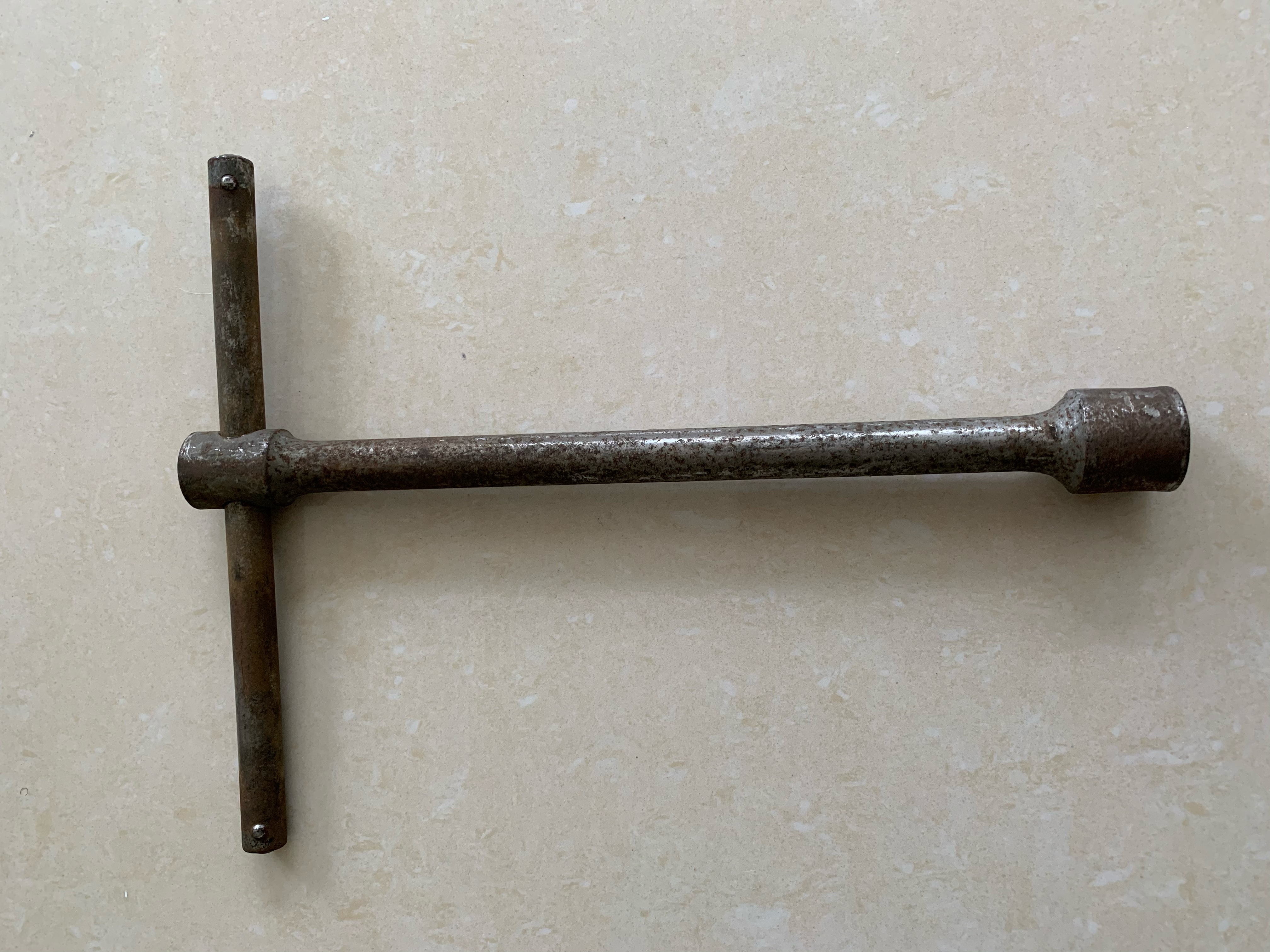

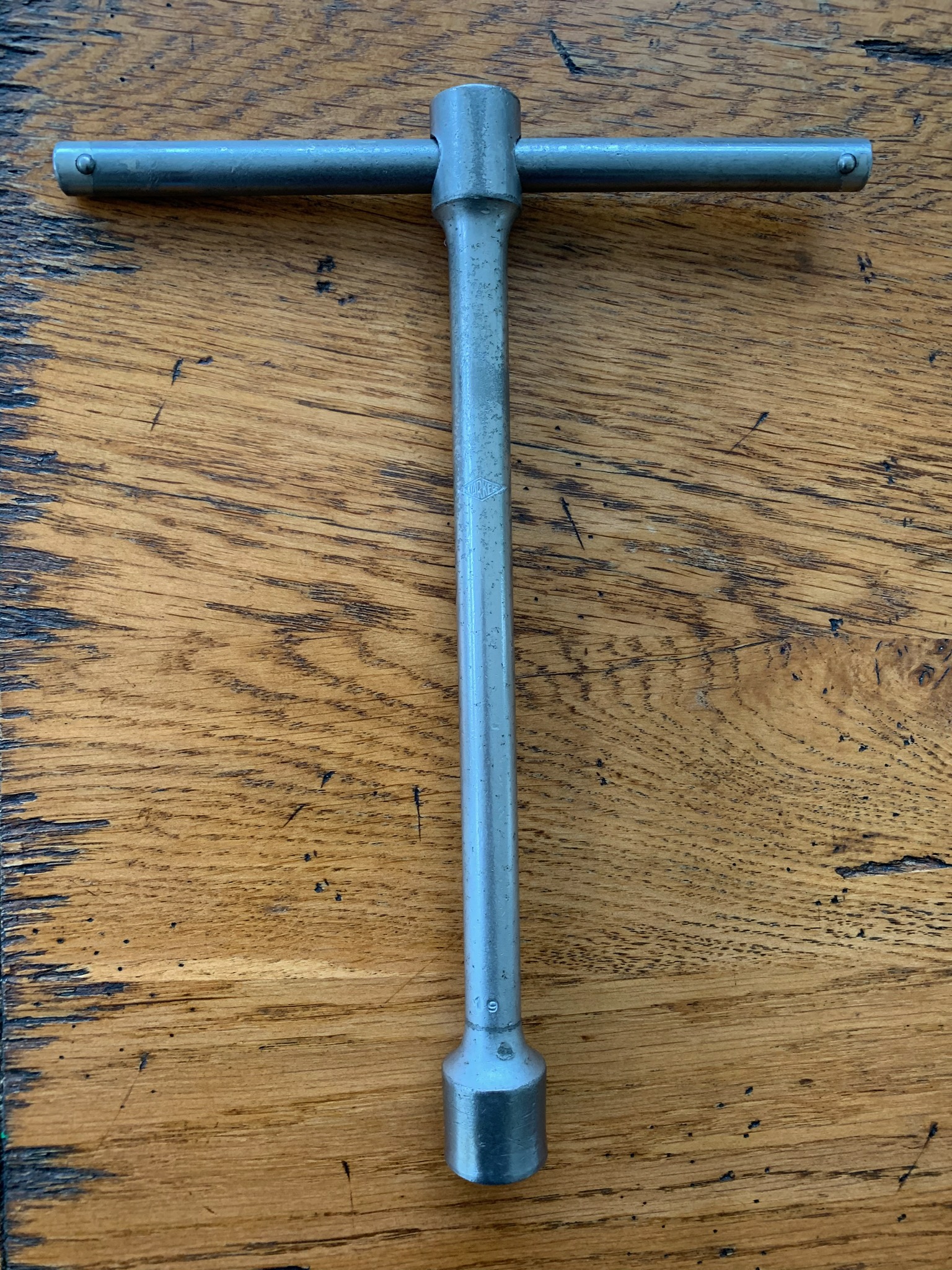

I’ve used white vinegar to restore tools. Worked great. Soaked overnight, then washed off with some wire wool. Then off to be rechromed. Success!
