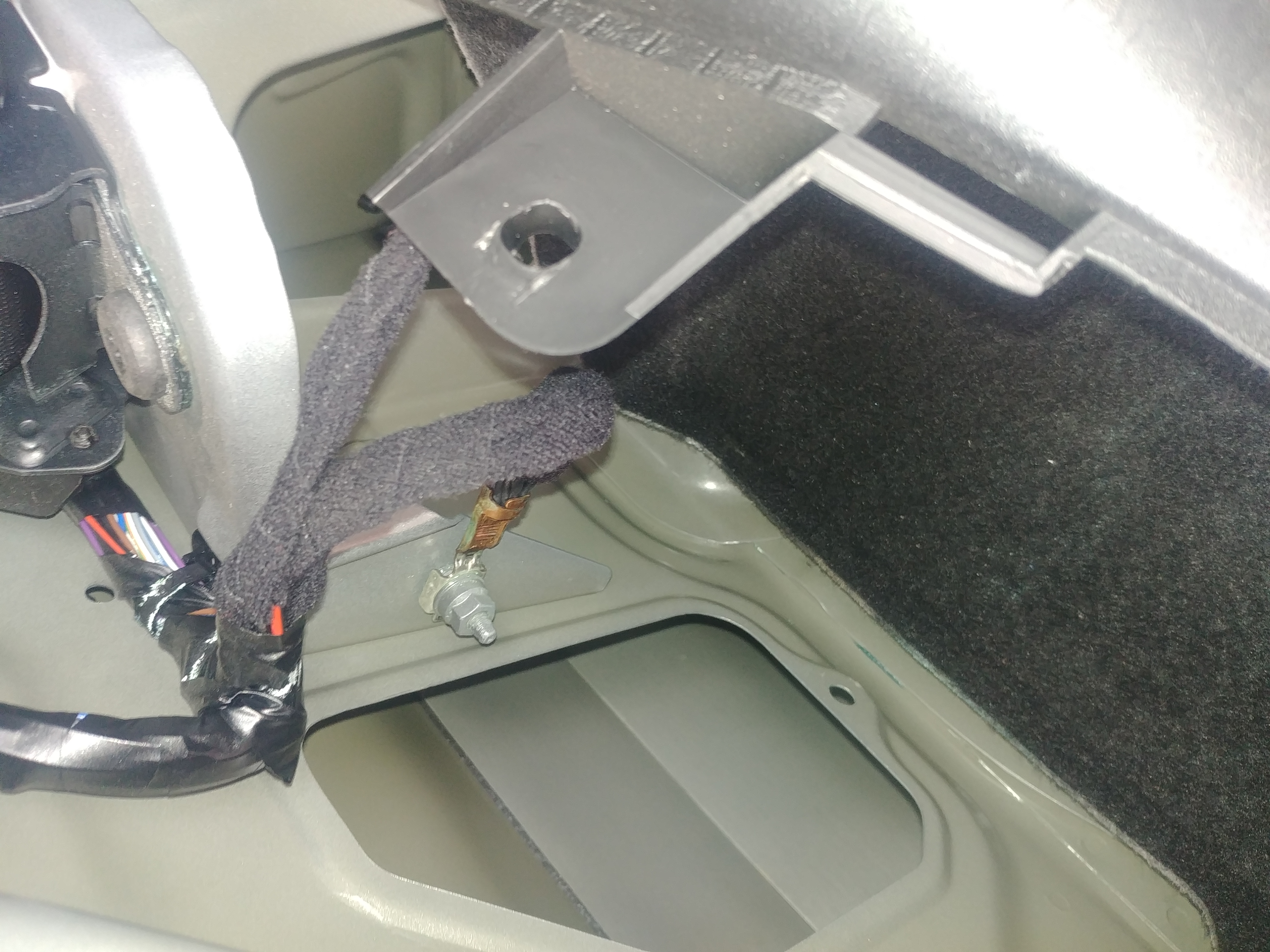

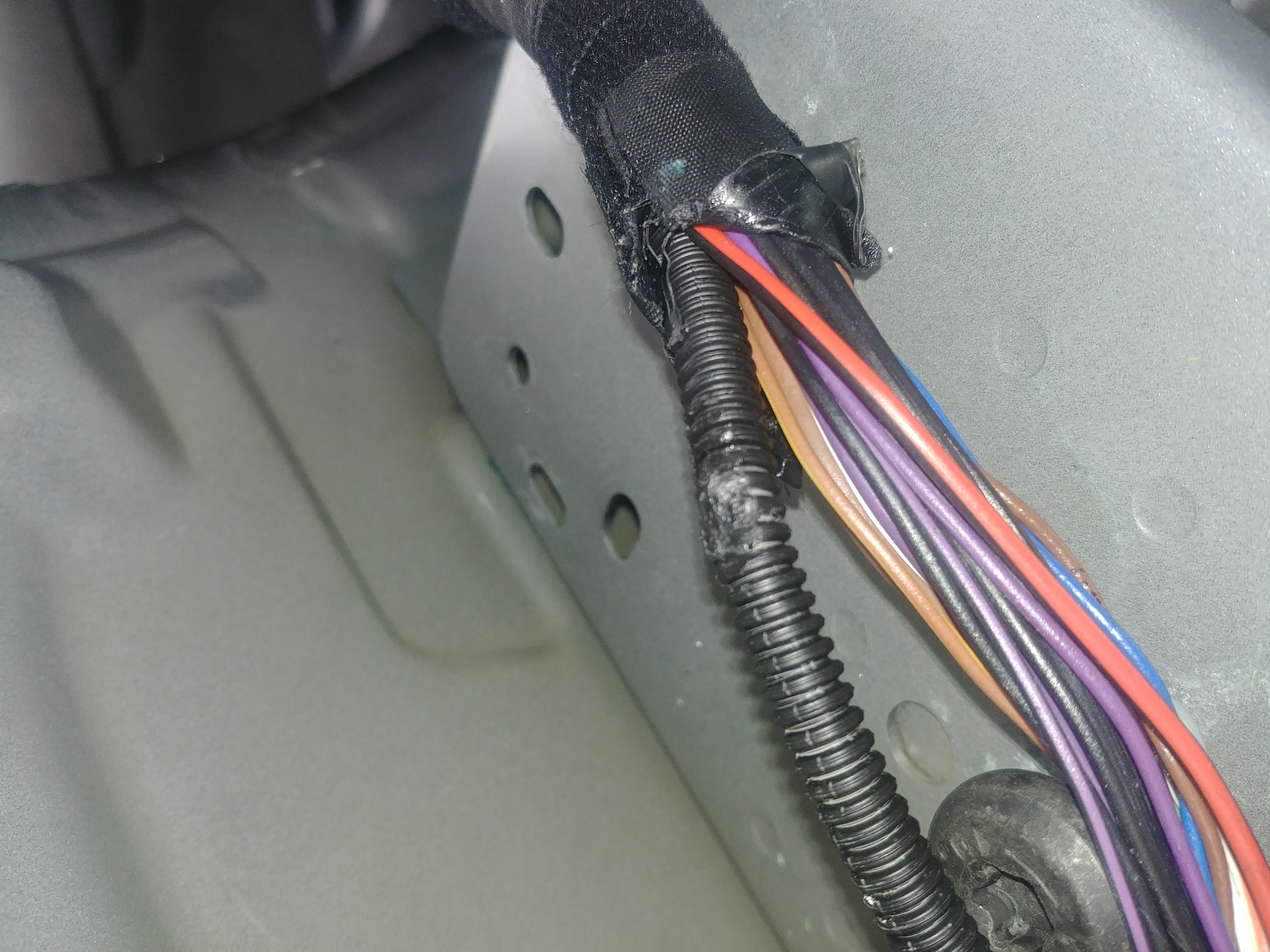

Assume it's been leaking since got the car
Only noticed it after giving it a very long spray and found water running down the side of the rear seat
No warranty on the carAhhh I wasn't actually expecting to be right! At least the faults are consistent.
Are you in warranty? Failing that then I expect it's a hard job (one I wouldn't fancy but I'm sure others would).
We need some guides on things like this if it's a common problem, if you fancy having a go ?

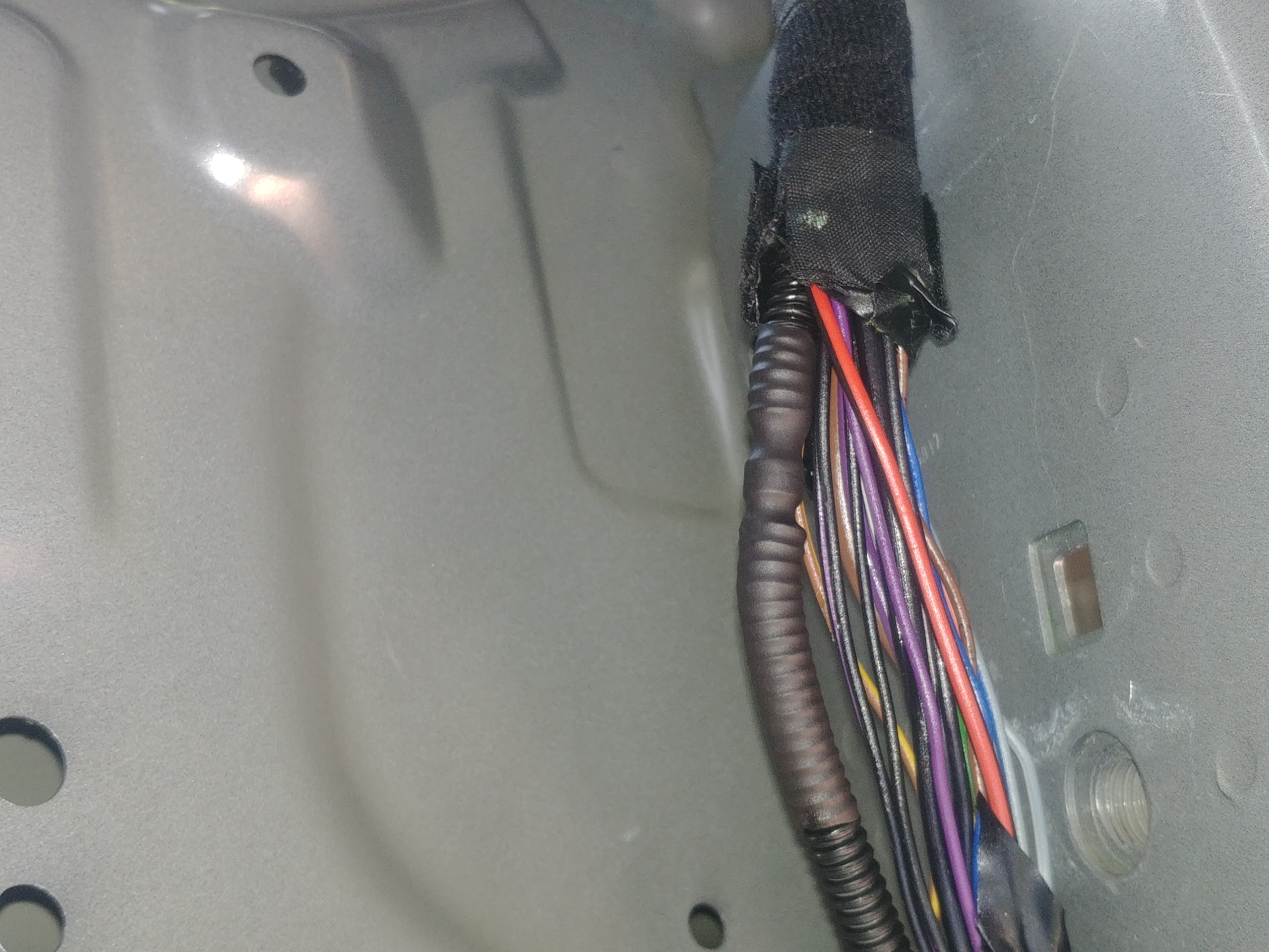

Look at the center of the last photo you can see damage to the ribbed pipe that carries the screenwashGreat progress!! No time.like the present.
Your leak sounds in a different place to mine but nevertheless good work in tracking it. Where actually is the leak and is it a fitting that has failed?
Nice work. I didn't realise they ran it with the loom.
