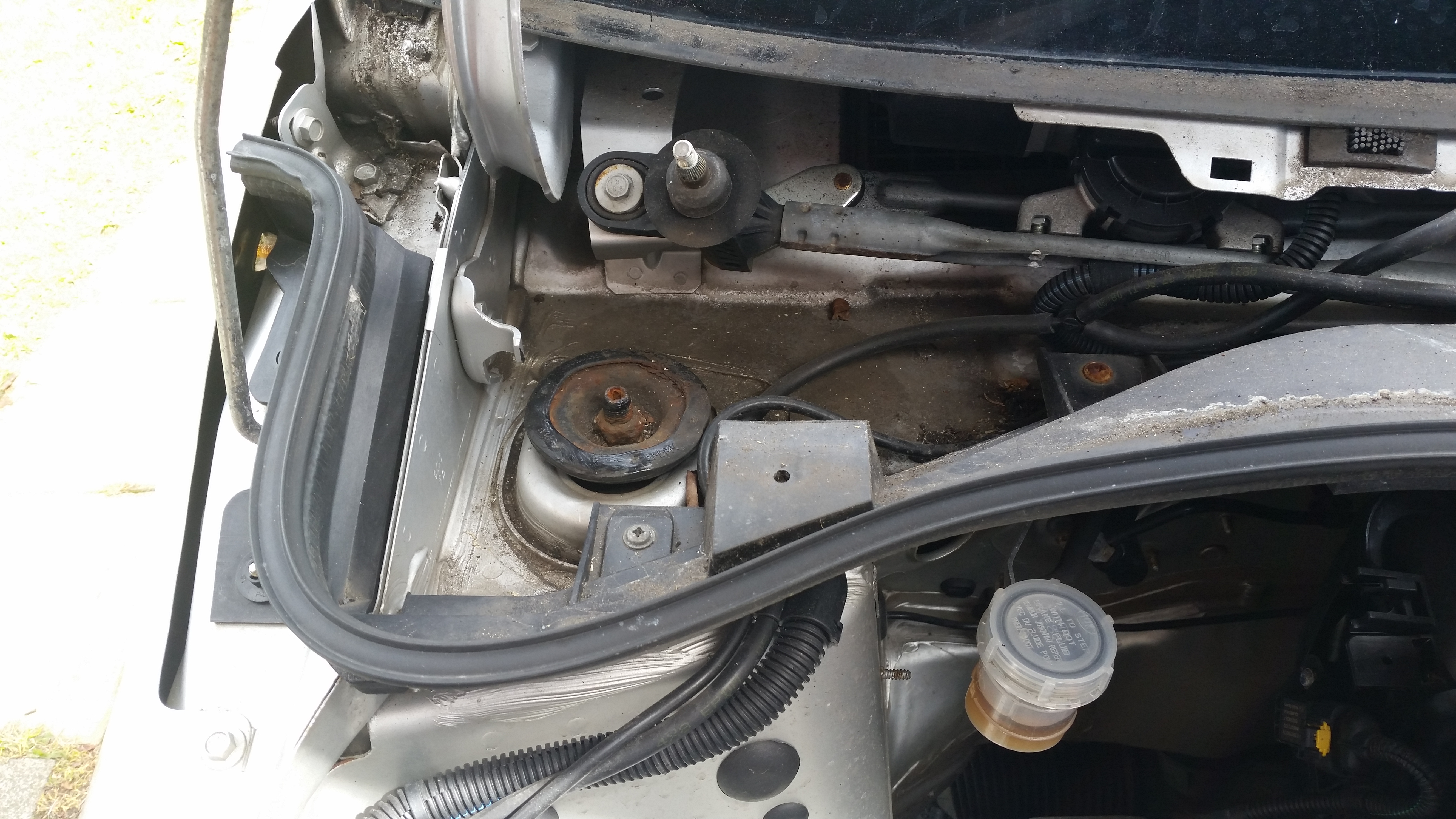

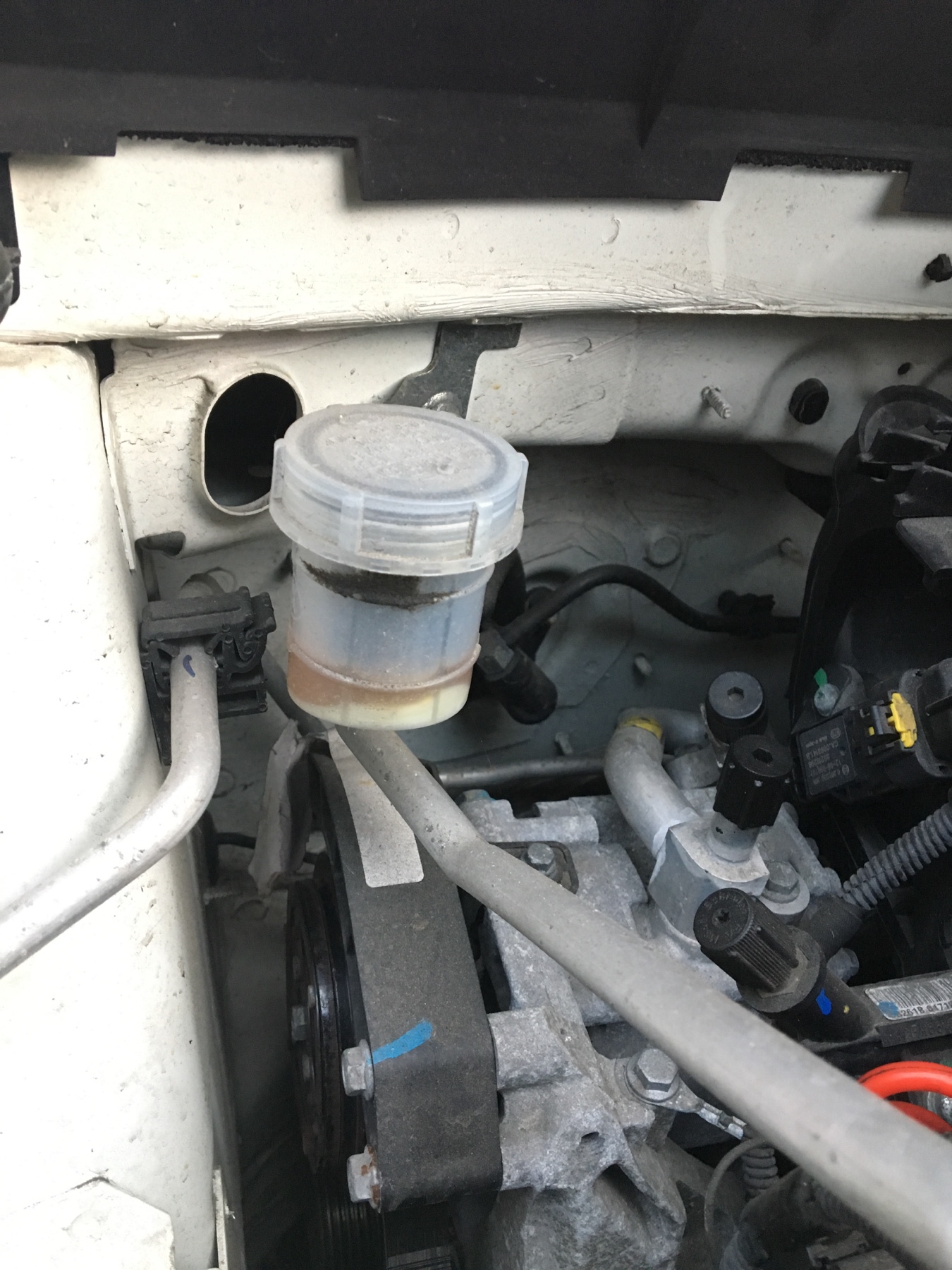

Woah! hold on there! Earlier picture you posted shows an almost empty clutch fluid reservoir. Lack of brake fluid and air in the system is going to give you exactly the symptoms you have.
Now, with out any remedial action having been taken, someone is telling you you need a whole new clutch and maybe a gearbox too! Well they might be right but I would bet on there being a leak somewhere in the hydraulic system - maybe at the quick connector, maybe a worn slave cylinder, maybe the master too. Whatever. This is what's causing your immediate problem.
I would take a systematic approach to this. Sort out the leak first. Even if master cylinder and slave both need doing, which is quite possible, these jobs are relatively simple and don't involve any major stripping out of components. Having sorted out this problem I suspect you'll end up with a working clutch. Having done this the clutch operation can be properly tested and an opinion formed as to it's condition - you can't see it, you'd need to remove the gearbox to do that so you really need to be able to drive it properly to form an opinion. If it then turns out that you need a clutch the gearbox will have to come out to do this and the slave cylinder will have to be separated from the bell housing again but only two bolts hold it on so you're not really incurring any additional costs by doing the hydraulics first.
