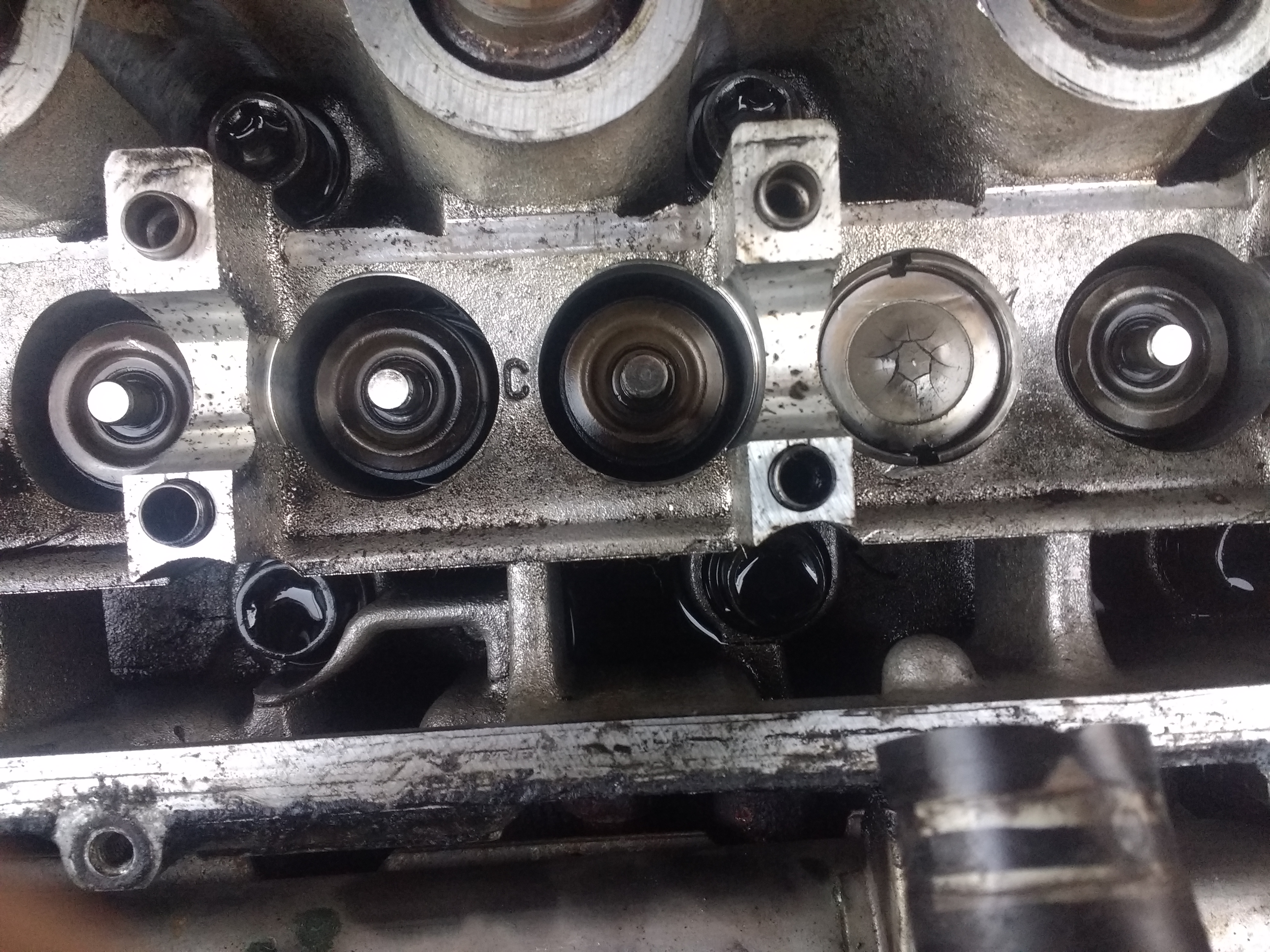

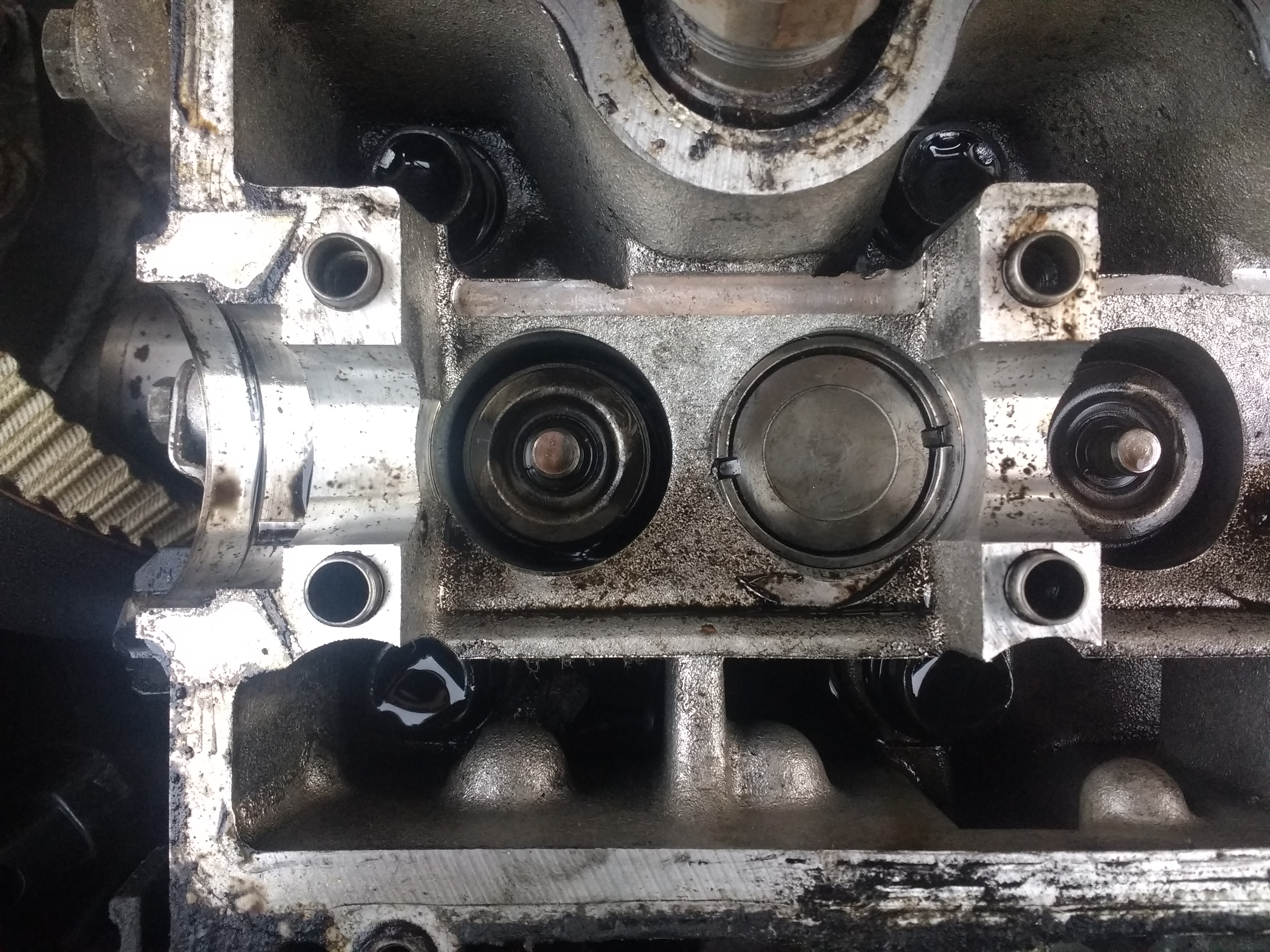

6 of the 8 lifting tappets (I think they are called) lifted out with a magnet. 2 of the shims were broken. From OSF to NSF the two that are broken are nos 2 and 7. I lifted the broken shims out but the tops of the lifting tappets are bashed upwards and the tappets won't lift out.
Not sure how to get those 2 out, anyone got any ideas? Obviously they'll need to be replaced so I don't mind if I need to damage them.
Had another go at them this evening and they seem to be stuck fast.
Does anyone have any tips to try and break whatever seal there is before I have to think about taking the head off?

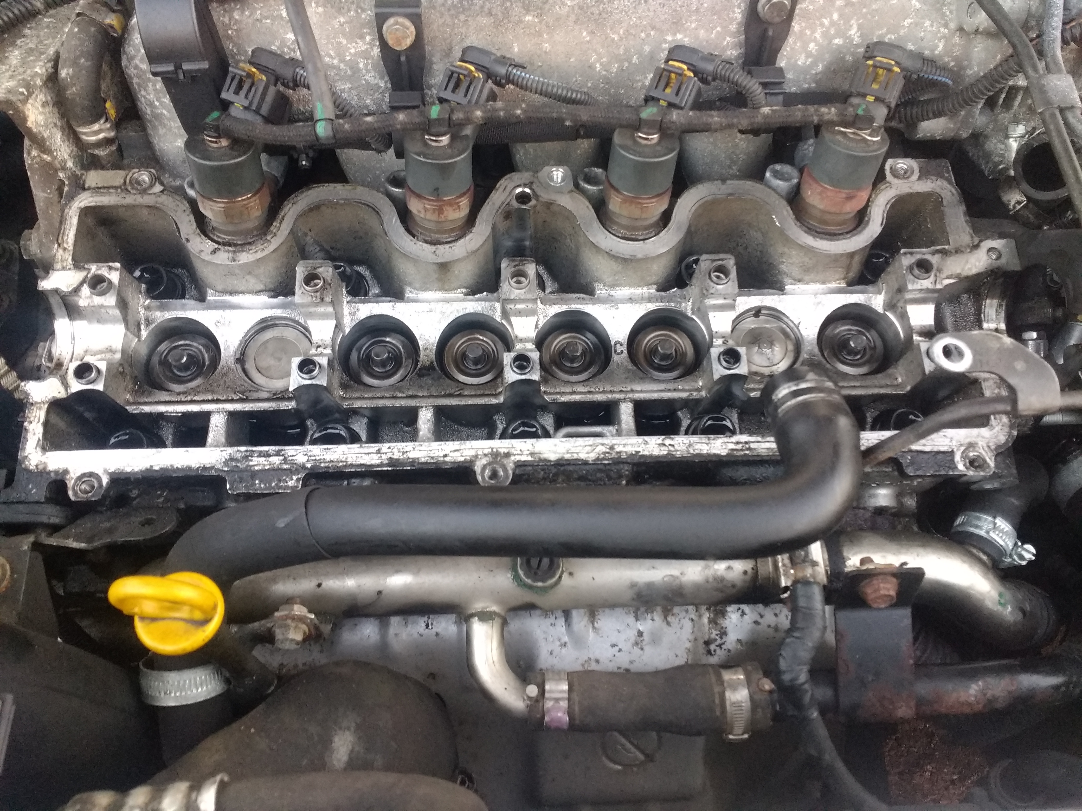

Please see pics of 8 valves, 6 of which the lifting tappets came out easily and 2 of which are tight. The adjusting shims are off, just the tappets to come.

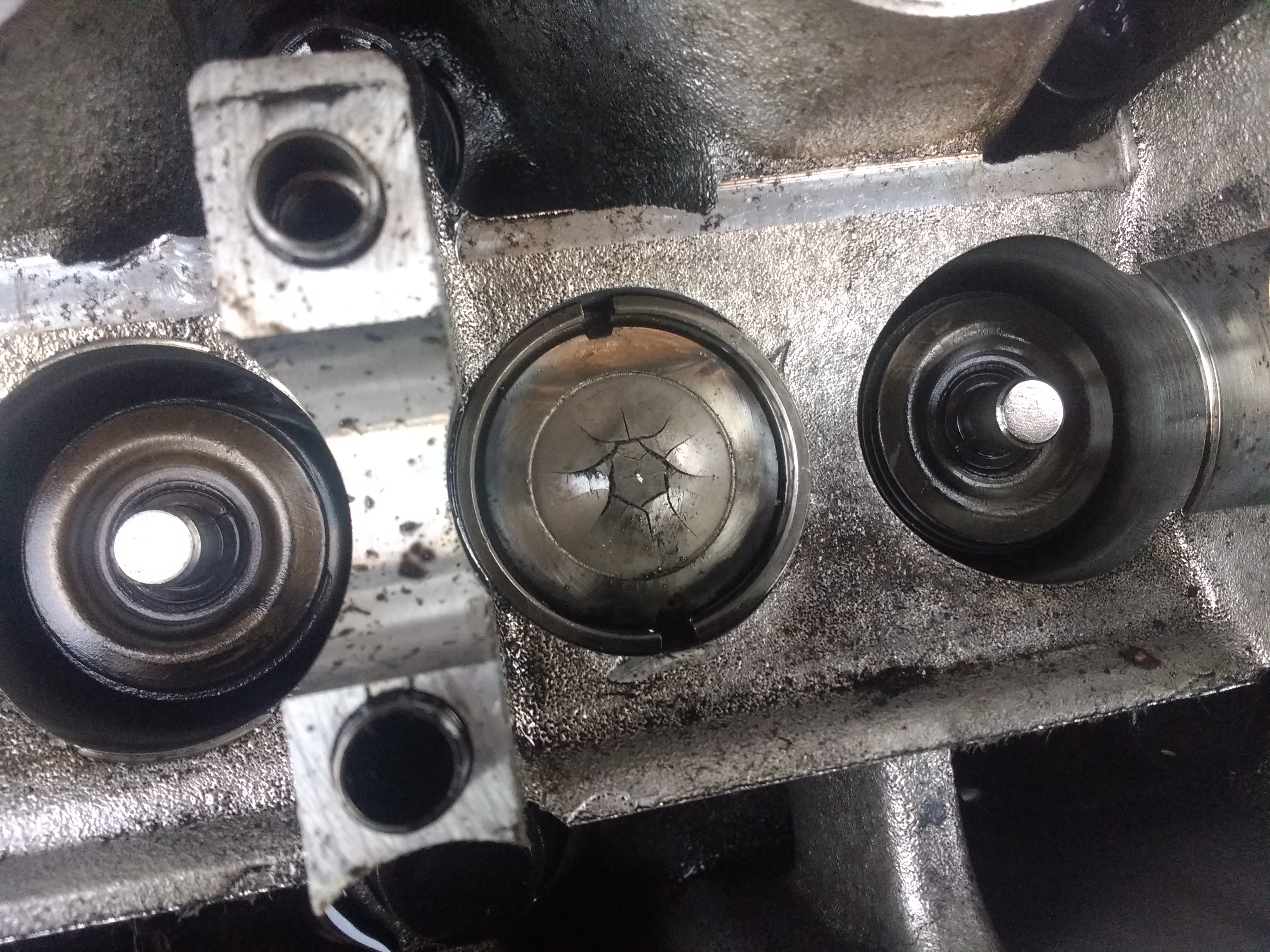

Last one for now. You can see the damage to the top of the lifting tappet on the one I'm calling no.7 quite clearly in this one. No.2 on the left isn't as bad.

I'm thinking maybe attach a magnet and then drill a few small holes, maybe not even all the way through just to weaken it enough to lever it out or maybe drill a self tapper in and give it a good pull?
Looking at the pictures it certainly looks like both tappets/followers has tilted over in the valve/tappet bore?
The right one with the more damaged centre has most probably deformed from cylindrical shape.
Have you tried to gently tap the raised sides down to see they will square up in the bore?
They also have those notches/cut-outs. You could try knocking up a key to engage with the cut-outs and see if the tappets can be twisted in the bore. You may be able to wiggle them out.
As for drilling / cutting then the tappets/followers will be pretty hard steel and/or case hardened. Could be tough going.

That No 7 does look a right mess doesn't it Brian - commiserations!
You'll find components like cam followers are very hard indeed and can't be drilled with ordinary drills such as the likes of you or I might own.
I've been magnifying up the image you've posted of that No 7 and looking carefully at the left side of the follower bore. I think I can see a small curl of picked up metal at around 8 o'clock, as if the top edge of the follower has dug into the bore? If this is the case, as S130 suggests, it's likely the follower is tilted in it's bore and if this is the case probably the head is scrap (sorry). Tapping it with a hammer and, maybe, punch, at around 2 o'clock might just straighten it and shear off the swarf curl so you can get it out but I suspect it'll be a lot of effort for nowt if the bore is damaged?
Of course it is extremely likely these (No2 and No7) valves will be bent and there may well be others less obviously bent. When a valve is hit hard by the piston it's not unusual to find damage to their guides too, maybe even piston damage.
Could be your easiest - and most satisfactory - solution will be a used head from a scrapie? I've actually never done a Fiat diesel but BMC/BL were my bread and butter with some earlier VAG (VE engines) too. So, just to alert you, in case you don't know (and I don't know if Fiat are like this) but there are often a selection of head gasket thicknesses on diesels depending on piston protrusion (you have to measure TDC piston height relative to the block face and use the appropriate thickness of gasket.

As expected 2 of the valves are bent but the others seem ok and the block looks and turns over ok.
