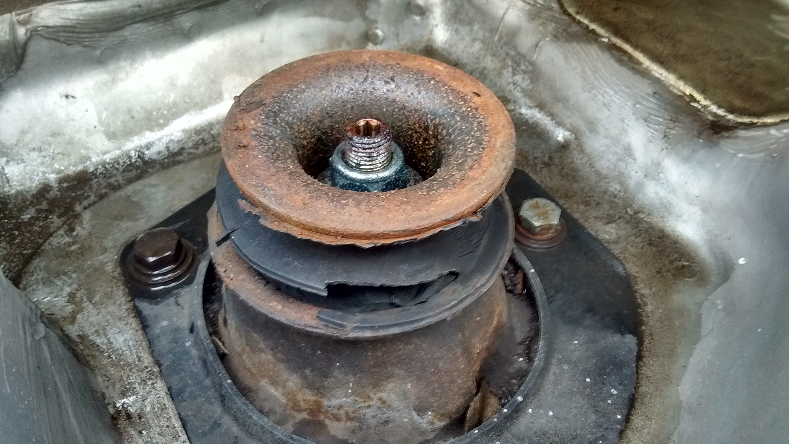

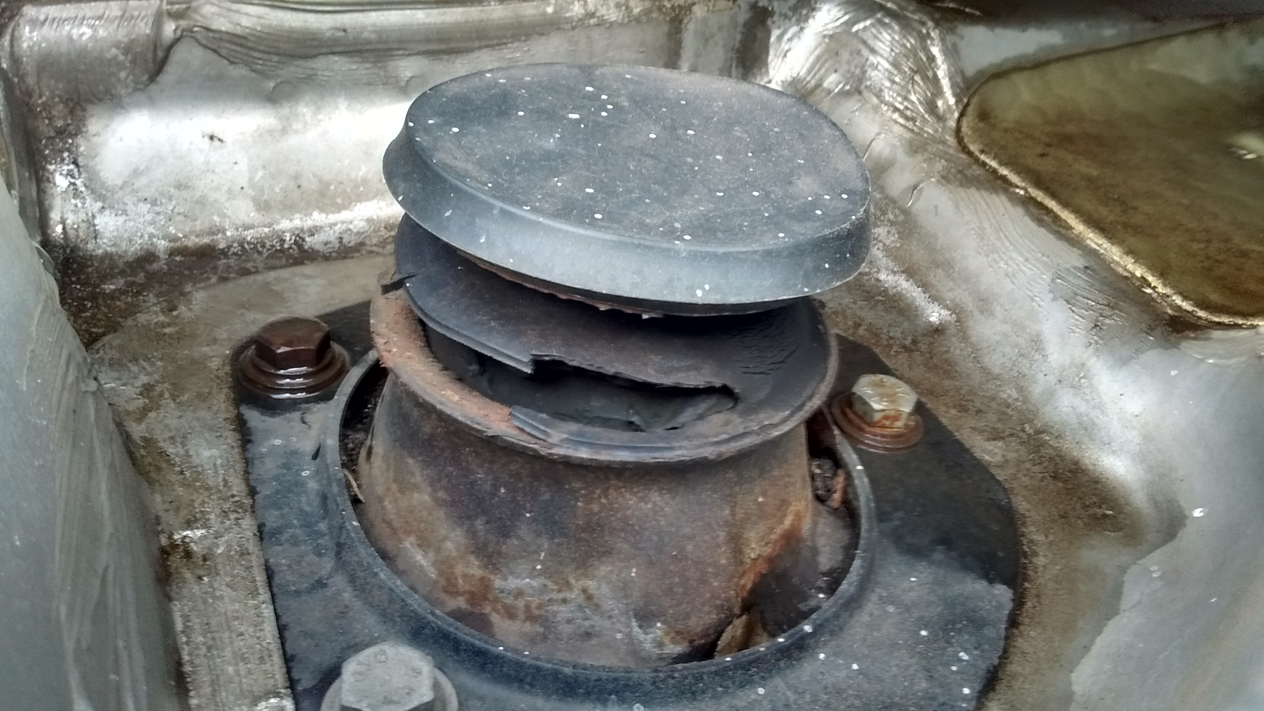

The OEM design in situ is different from the replacements offered
The bearing and housing appear to come thru from below, but there is then an open shroud which cloaks and secures it all to the bodywork
Looking at the rplacement, it might be possible to replace it in situ IF the spring can be safely compressed.
I was hoping with the "for spares" identifier, l could at least do one job on the Dobbie without having to dismantle and identify the parts before buying them, but alas no.
