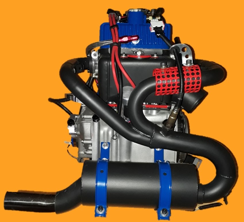

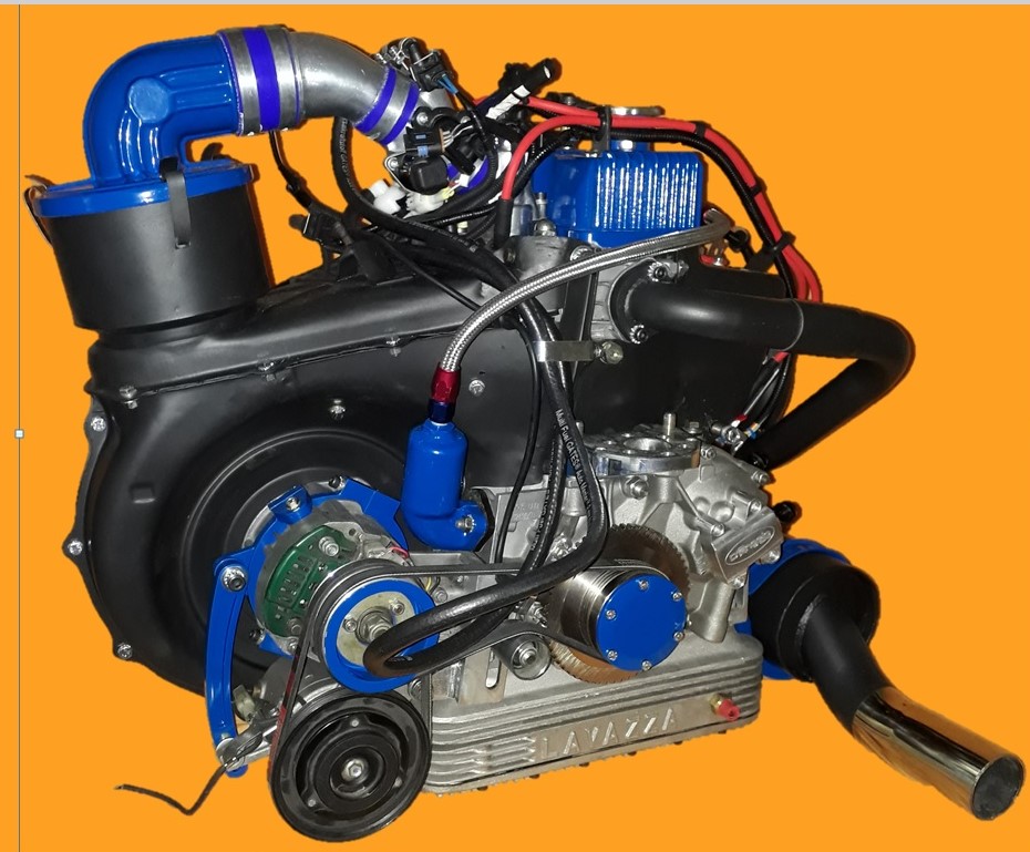

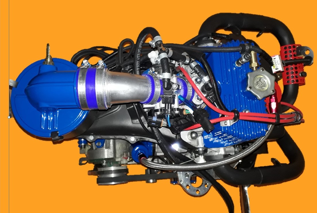

I did it. It can't be done any more since Ecotron has stop producing EFI kits. They also stop their technical support. Quite frustrating since if a major item will brake, like the ECU, there is no direct replacement for it. The outcome however was very pleasing. I've got a 34mm throttle body kit. Cost was around 1400$ for the whole kit. I had to design and manufacture the intake manifold and the piece between the throttle body and air filter. The system has two injectors inline. One in the throttle body and the other is closer to the head, mounted on the intake manifold. They say it's a patent they have. They switch between injectors according to engine RPM for better fuel / air mixture. The engine has several more upgrades. It has the 540cc pistons and cylinder kit, sport camshaft, huge valves and sport Exhaust. All that brings the car to a top speed of almost 130kmh and cruising at 100 - 110kmh is easy. 0-100 takes about 30 seconds. I intend to upgrade to 695cc. Since I'm using the original car 110F engine block, the only safe way to do it is as Abarth did, with 76mm pistons and 76mm crank travel. Nanni offers this kit. I mainly going to do it for the extra torque when going uphill. If all roads were level..., I wouldn't have change a thing.

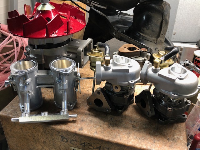

That throttle body hobbler mentioned is a very cool pc of kit. I was a vw bug nut when i was younger, and although efi conversions were kinda rare due to the limited availability of standalone efi ECU's. The weber DCOE "style" carbs were very popular in the air cooled bug world. With a large classic vw community and their demand for "customization goodies" i was able to recently find a DCOE style efi throttle body. It has a mini fuel rail, throttle position sensor, and accepts std bosch injectors (cant remember what version off the top of my head).
Again fitting something like this to a small stroke engine wouldn't be the best solution. But there are ways depending on how many grey hairs you want. You could in theory, cut the efi DCOE in half, and only use one throttle body with the fancy injector setup.

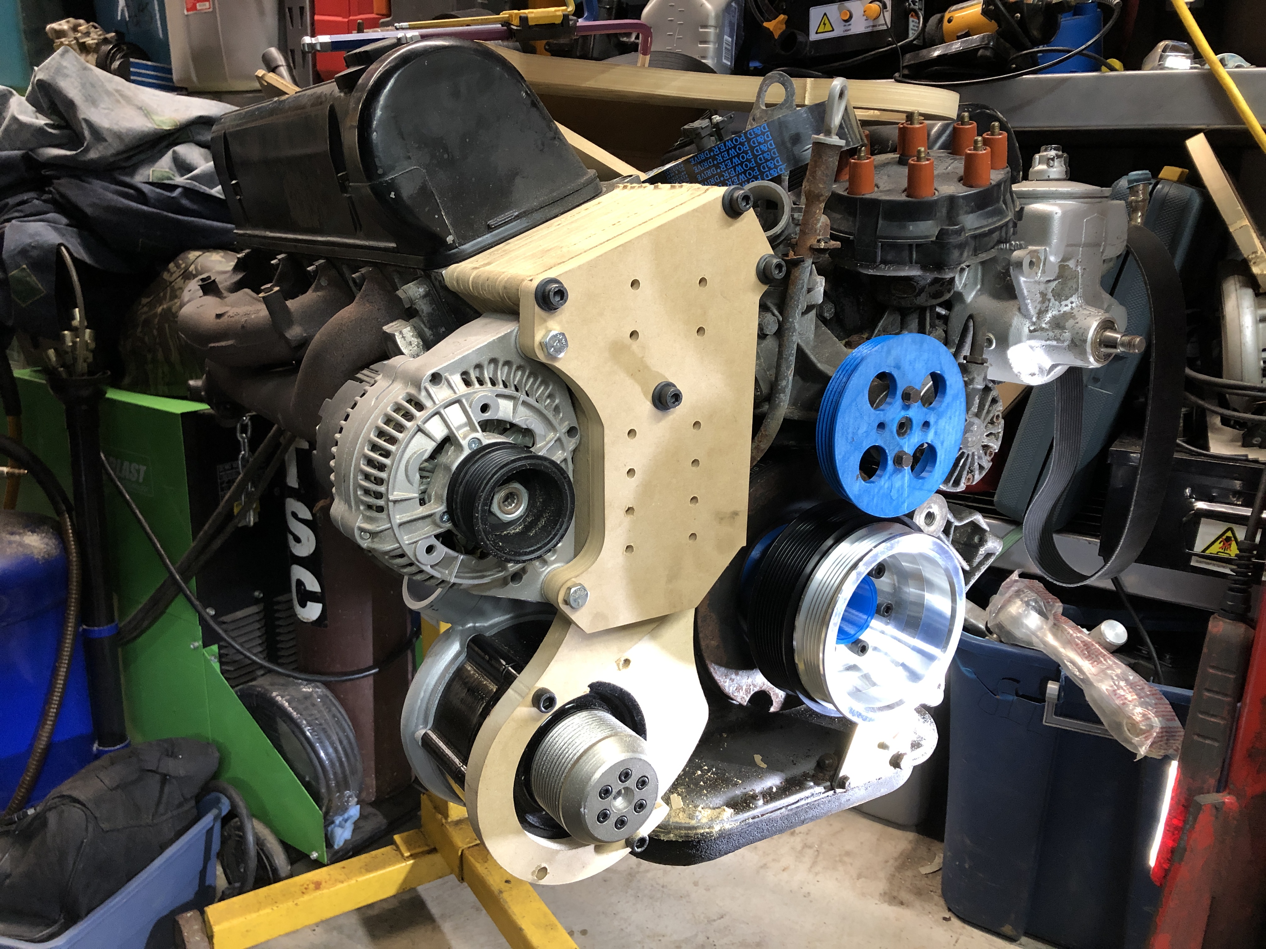

On/Off For the past 4 years i have been building a classic MB supercharged V8 with a full efi and i am using the megasquirt pro ECU for it. I hope to have it atleast start this year. Currently converting all the drive accessories to a modern serptintine belts have been a chore. But i want to see it atleast run on the test bench. Its definitely been no small feat. Ive attached 2 old mockup photos as i was doing layout.
