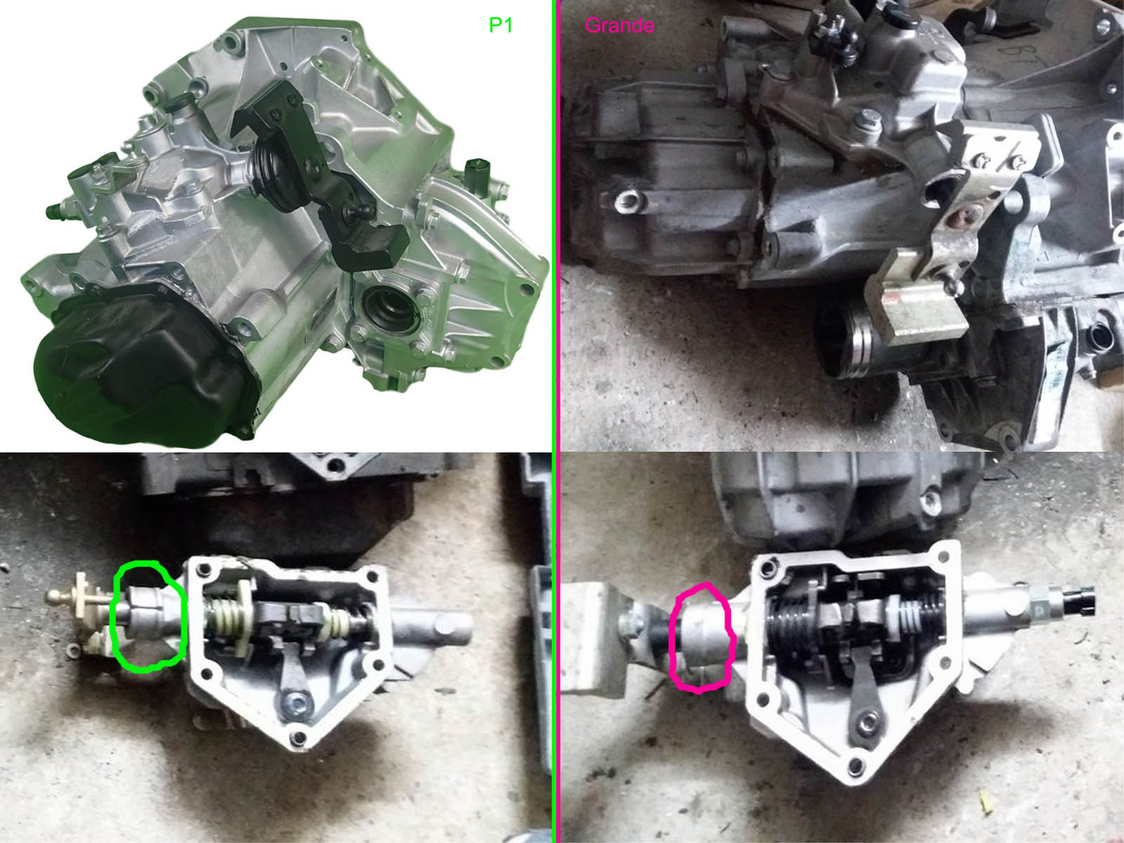

My Grande Punto 2008 1,2 gear box looked like this:
I thought that drive shaft seal was leaking but I was advised it probably was a gear shift seal leak. It actually was the case:

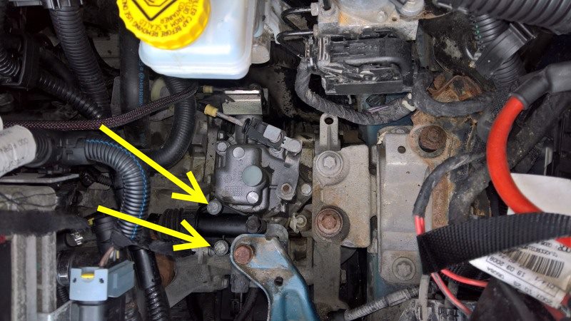

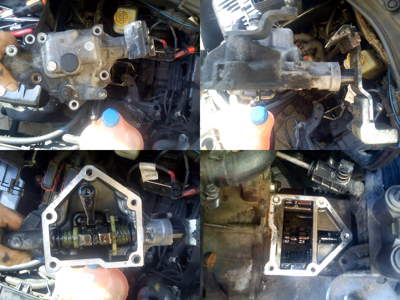

Gear shifter is attached with five screws (13 mm socket):
Gear shifter removed:

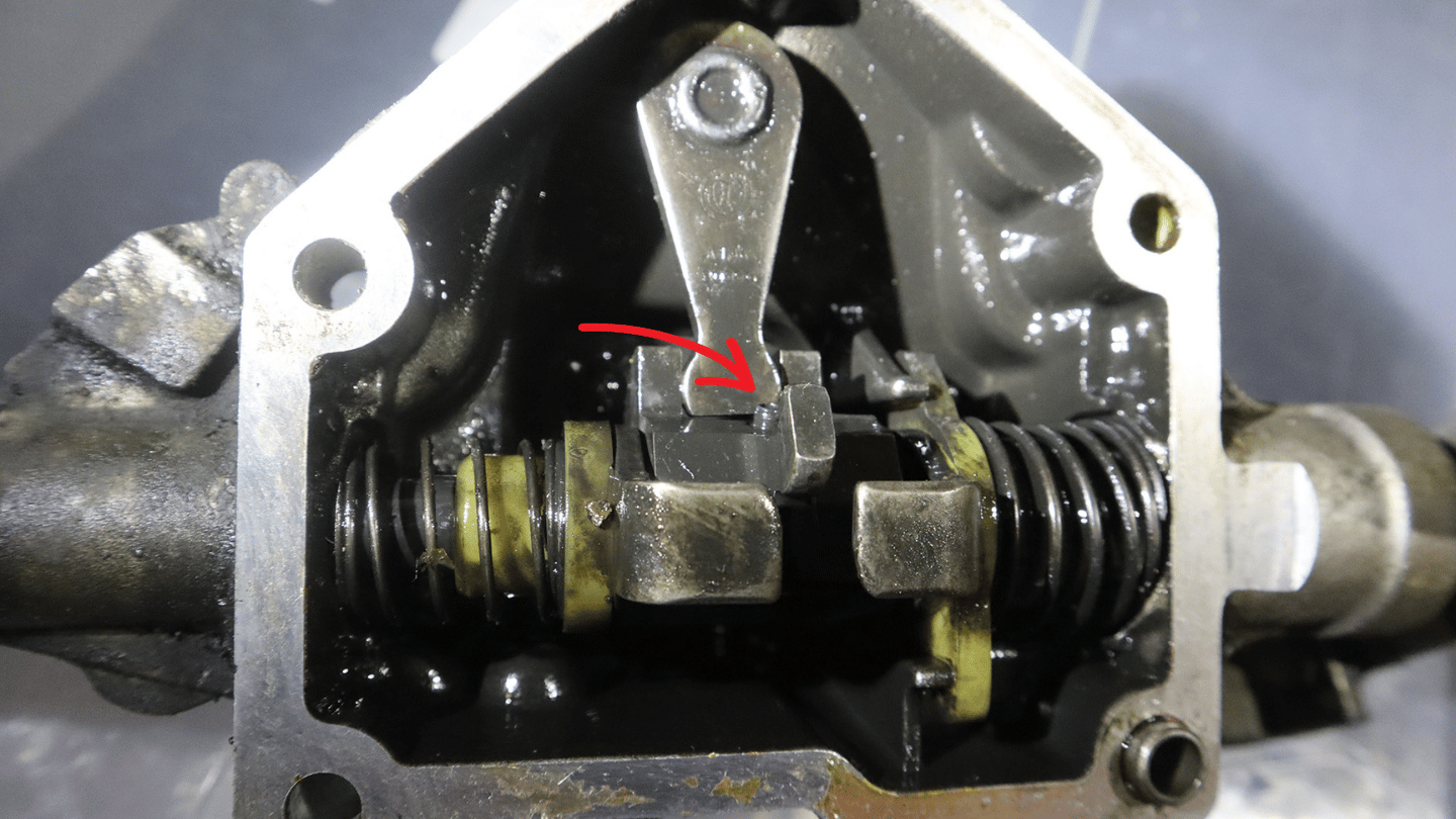

Remove lock pin with a punch:
Remove a seeger ring with a screw driver:
Gear shifter disassembled:
