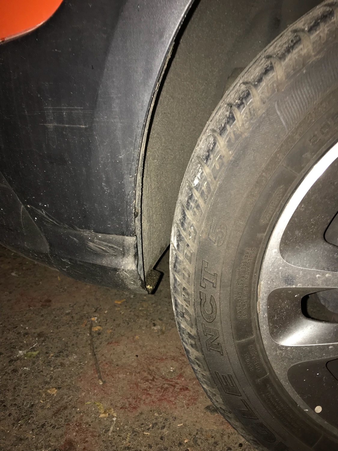

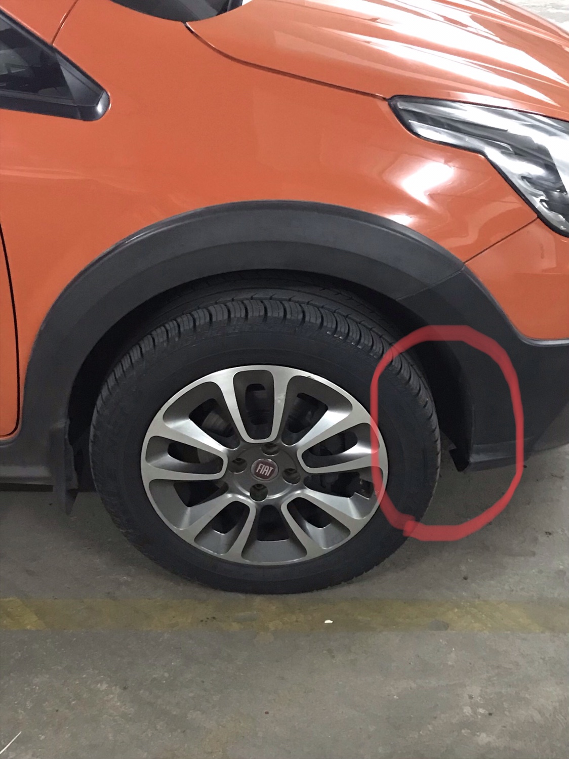

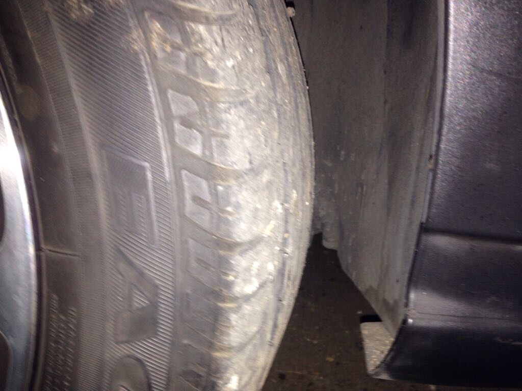

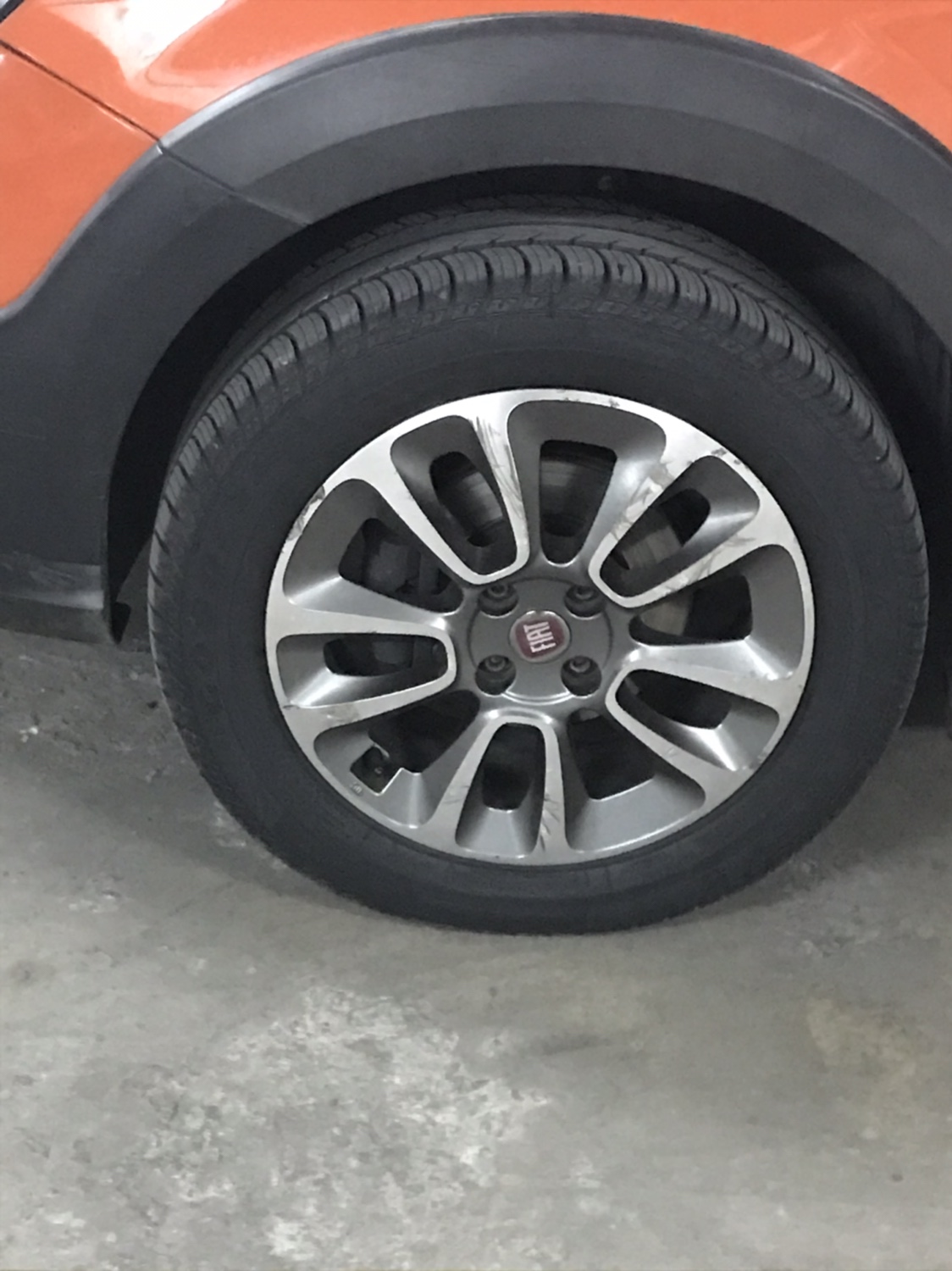

You’d need to post better pictures, of the whole wheel in the whole wheel arch to be able to see what is going on for sure, but in essence either the wheel is in the wrong place because the wheel alignment has been knocked out, or the bumper has been knocked out of place.
We never got the avventura here, this car was specifically built for areas with poor roads, at the end of the day it’s a normal punto with the suspension jacked up, however this makes it more liable to suspension damage as it’s not really an off roader so not built to take much abuse
You have a failed component.
Something is physically loose.
This needs investigating NOW..!!

Yes something weird in front wheel, last week it’s damaged my Right wheel disk plate. I have changed last week .

quite possibly a related issue :bang:
these are the parts likely to be at fault
http://eper.fiatforum.com/eper/navi...INT_MODE=0&EPER_CAT=SP&WINDOW_ID=1&GUI_LANG=3
they tie the position of the front wheel hub ( that the wheel attaches to)
Idea.. :idea:
carefully Place a wheel wrench on the head of a wheel securing bolt ( there are 4..) apply "tightening pressure"..
load the pressure on the Left hand front wheel,
see if the wheel moves around in the wheel-arch ( the gaps you have shown)
then do the same with the Right Hand wheel
if there is anything badly worn / broken .. you should be aple to replicate the movement with hand force.. from the wrench.
this is how I discovered damaged rubber mountings in the suspension arm of my FIAT
do let us know what you find.
View attachment 193588View attachment 193589
This is the Exact Problem . Front wheel Fender gap is different in both the wheels . Left side is perfect , but right side is having gap
