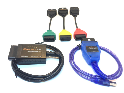

1. Get an OBD2 interface
I've got myself some ODB2 to USB2 interfaces (ELM and KKL) and KKL adapter cables. There are several sources of these (I chose iDiagnostics).
