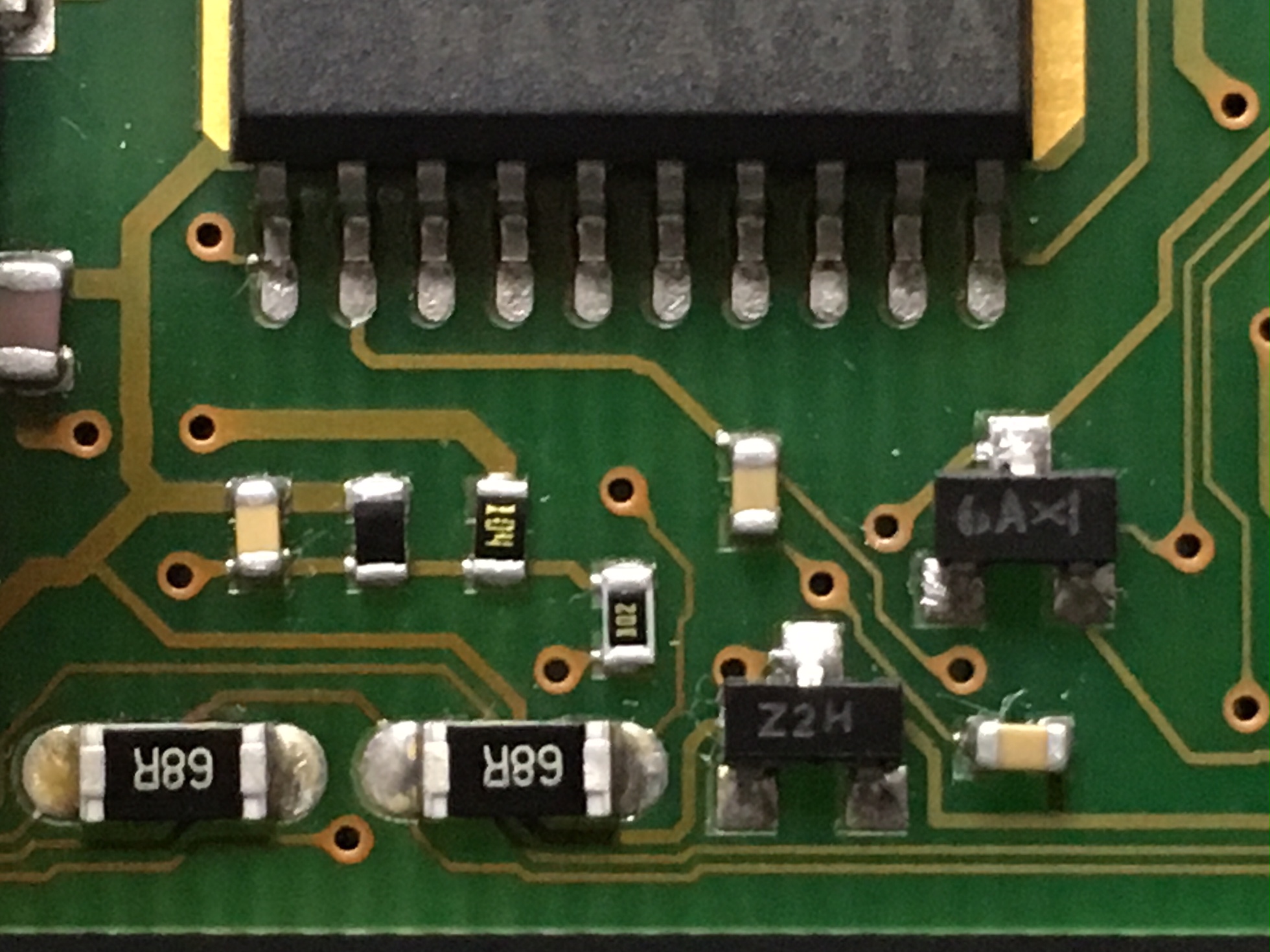

Tracing down the circuit, i found a burned transistor of the LED array on TFT board. The failed part was getting real hot consuming up to 2 A.

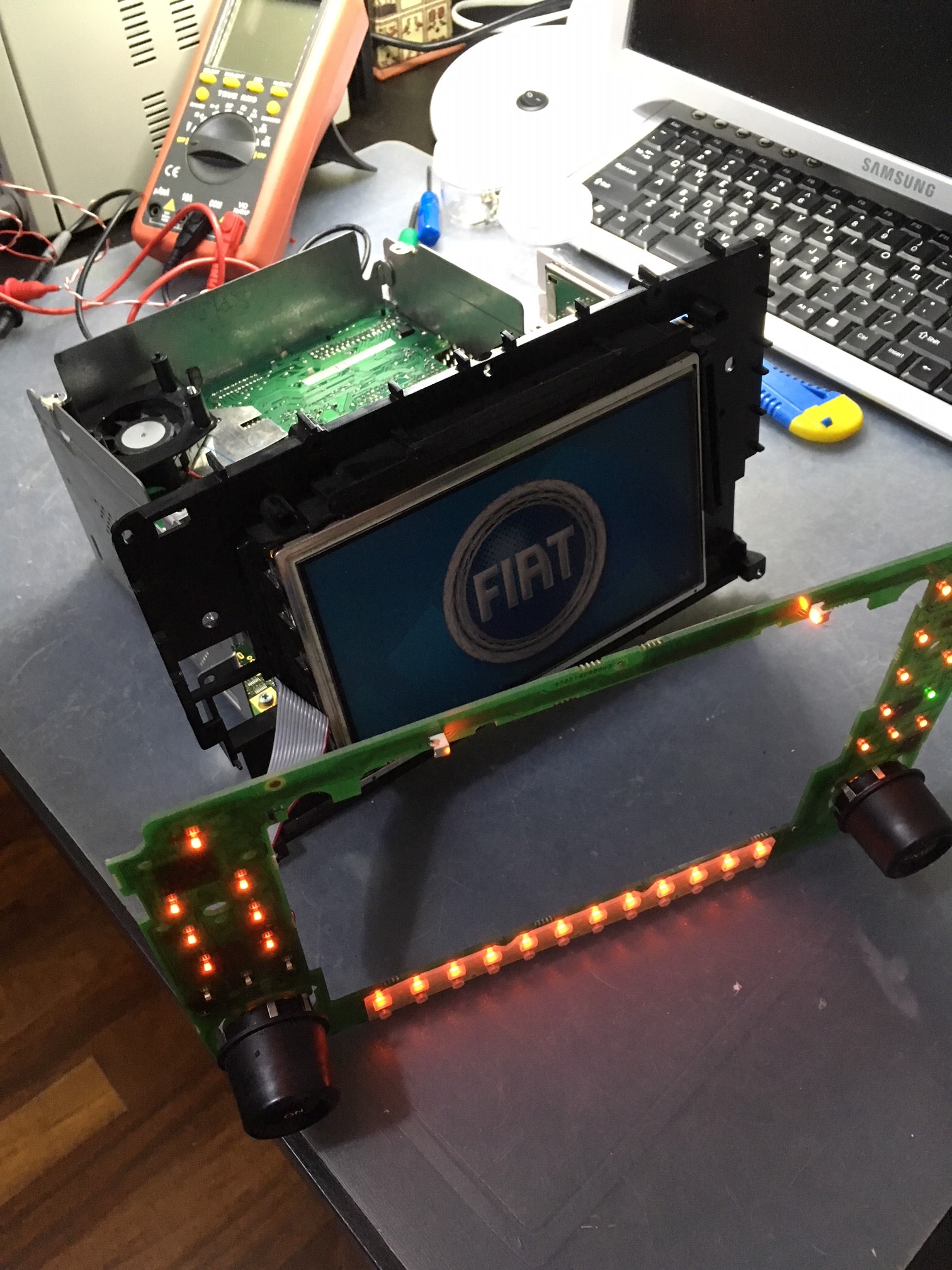

I replaced the transistor, backlit on keys was back then, but system continue to fail booting.

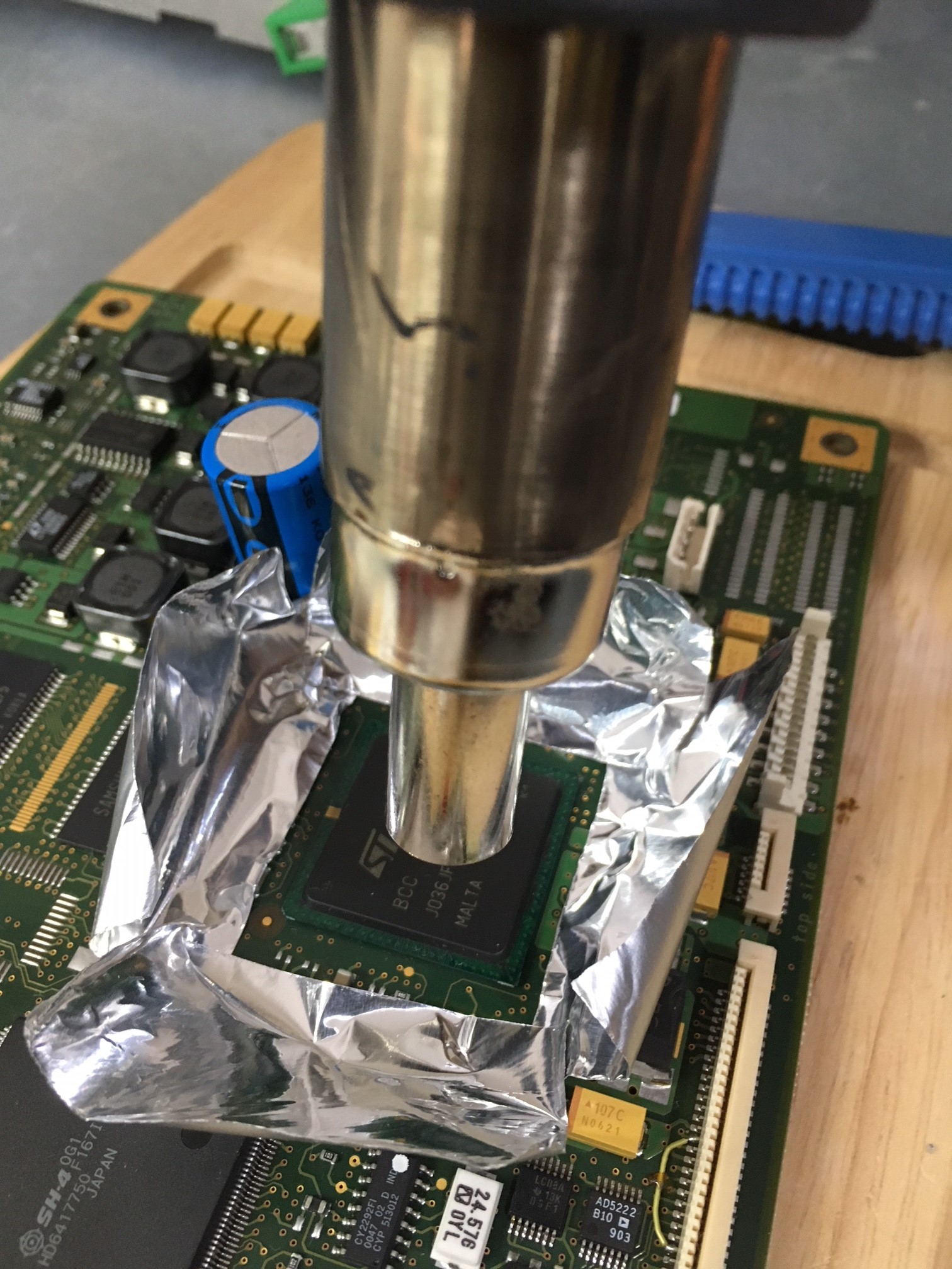

So I took apart all boards and assumed the problem was corroded solder especially to memory and eeprom chips.
Using a hot air station, I reflowed these parts using flux. That was a real success!

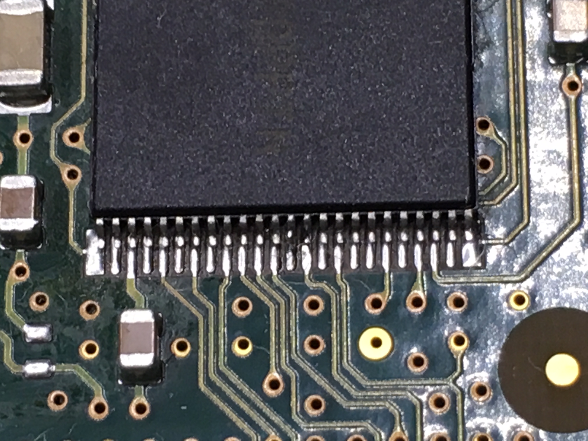

Traced down the problem and it was on some pins of top eeprom chip so the system wont start.
Now its running smoothly
