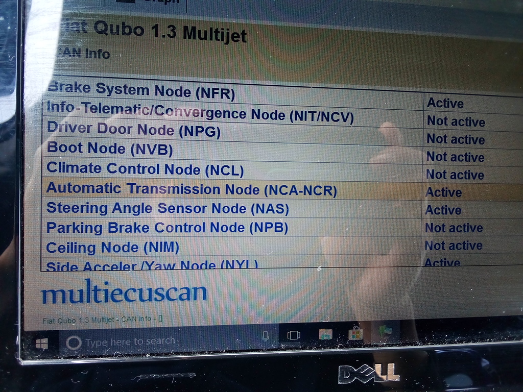

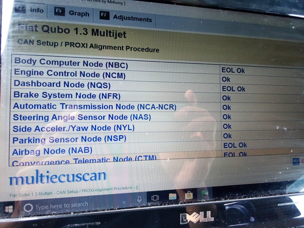

Hi all,
An error code -- P0710 Temperature ( from CAN ) shows on Multi Ecu Scan, erased and came back on.
On the dash , no warning lights whatsoever, no leaking fluids on the pavement, driving is fine.
Found something on the website suggests ---- P0710 means that your transmission is overheating, or that the sensor is faulty. This could be due to leaking, low, or dirty fluid, or a bad sensor
P0710 FIAT Description
The Automatic Transmission (A/T) fluid temperature sensor detects the A/T fluid temperature and sends a signal to the Transmission Control Module (TCM).
Had a suggestion from HonestJohn , it could be the faulty temperature sensor.
Any advise is much helpful, many thanks.
Scot
