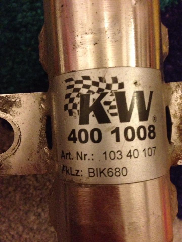

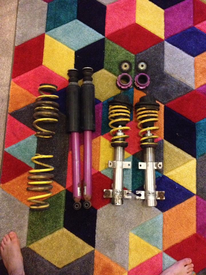

The previous owner said they were meant for the diesel/ Abarth but he had them on his 1.8? Any help would me much appreciated thanks.

I bought some coilovers, the data sheet said it was for my engine - ********...
Our 1.9 Mulitjet has wider brackets on the shockers for the hubs to bolt in on the front.
The rear will fit and be ok, but the front wont.
You need to find some that are for the 2.4 Abarth.
Our 1.9 Multijet 150 uses the same hubs (same fitment).
If the 2.4 is a similar weight, shouldn't be an issue however i gave up after wasting over £500 on parts and kept getting sent wrong parts.
Eventually - i did some digging with Bilstein and their catalogue - check their part numbers for 1.9 150hp diesel and the 2.4 170hp petrol and you will find that the Bilstein B6 and B8 (front and rear) are the same part number and used on the 1.9 (150hp) and 2.4 (170hp)
The springs are different though, well they only list springs for the 1.9, not for the 2.4.
So that confirmed it for me - if bilstein kits are identical part numbers and kit numbers - they must use the same shocks / springs fitments.
ePer is slightly different, shocks are different for multijet and 2.4 in
eper, however - i would trust bilstein.
