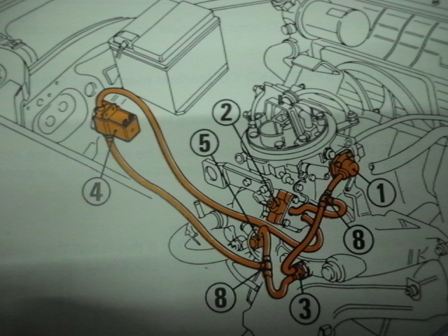

I'm informed (by a slightly dubious source) that this electro valve controls the fuel flow when A/C is in use. I have the unit with carb and vac pipes won from a scrapper, but no idea where the live cable runs to/from.
I'd be much obliged if anyone can help.

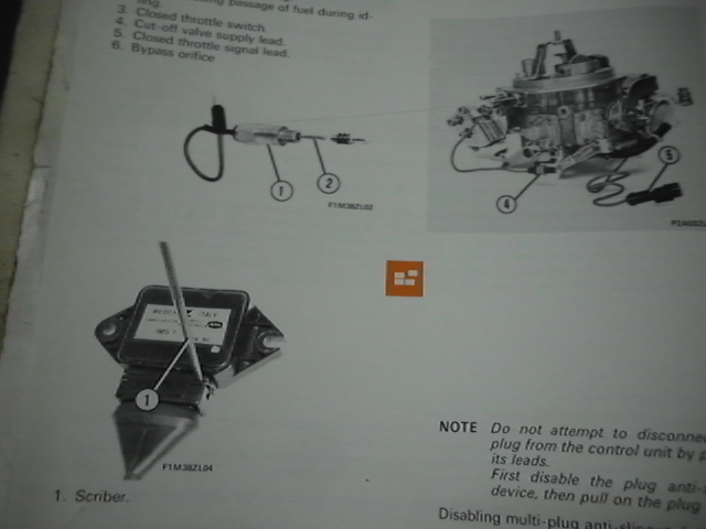

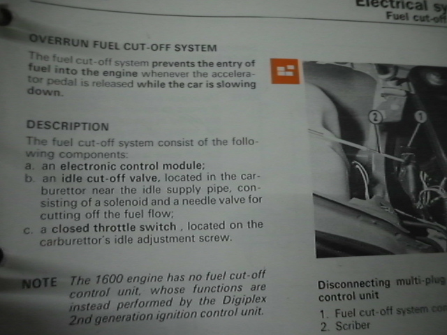

This solenoid does not appear in my service manuals and I wonder if the UK models are different to the Tipo in your country ?
However part 5 in your picture appears to show the electronic fuel cut off module, in my Tipo this is Mounted near the back of one of the headlamps and its purpose is to cut off the fuel supply when decelerating, the solenoid in mine is screwed into the side of the carburetor, so I am assuming yours not been a UK model has the similar set up with just a different solenoid and mounting position.
Have a look at the photos and let me know if you need any more info ?

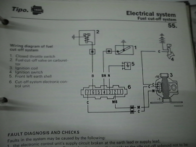

Here is the diagram for mine and it shows the live wire for the solenoid goes to pin 6 of the electronic fuel cut off module.

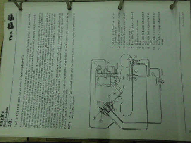

the solenoid is part of the fast idle circuit and opens only when the air con is switched on allowing the vaccum coming from the inlet manifold to act on the carburettor stage 2 fast idle valve.

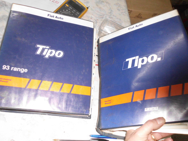

Where can I get copies of the manuals you're using? No information about them to be found on the web.
This is a total mystery, despite featuring in the service manual the solenoid is not showing in any of the wiring diagrams,the only thing I can think of is there must be perhaps a separate manual covering operation of the air conditioning.However let's examine this,the purpose of the solenoid is to increase the engine tick over speed only when the air con is switched on ,the air con compressor is likely to draw a high current so will almost certainly be controlled by a relay ,so the most likely place to feed a 12 volt supply to the air vaccum solenoid would be the output of the air con relay.Sorry I can't be of anymore help .The service manual s I use would have been supplied to Fiat dealers and would therefore not be on general sale,your only hope of obtaining these now would be a closing down Fiat main dealer.

PS: I'd be most obliged if you could post the diagram that goes with the page:
Engine
Fuel system____________________________
10
TWO STAGE FAST IDLE (for versions with air conditioning)
