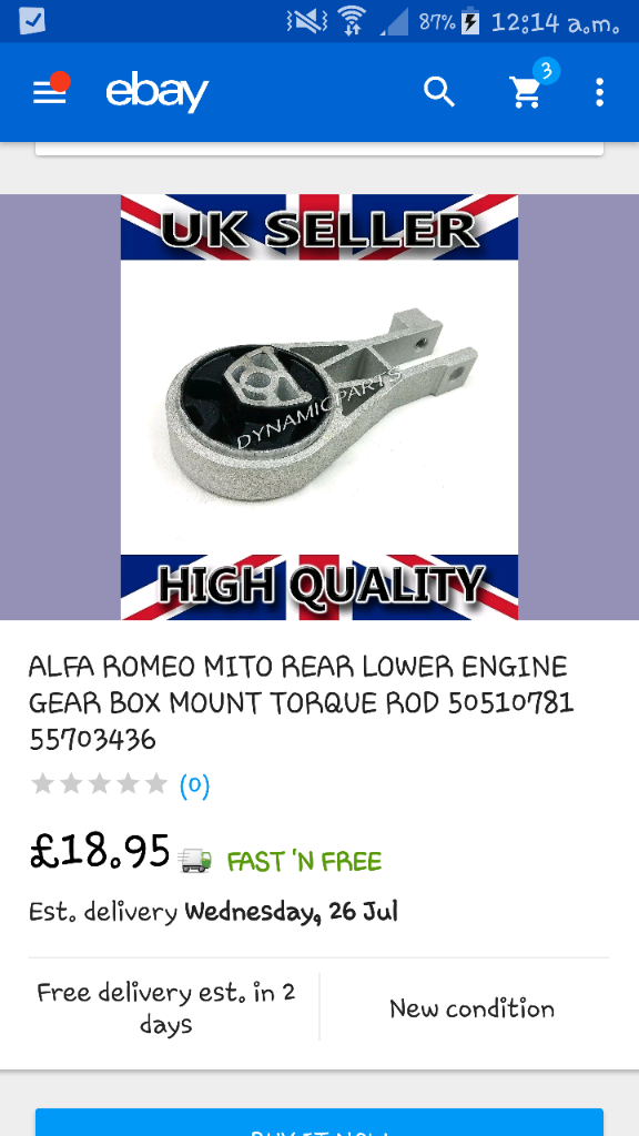

Hey guys
Have a GP TJET SPORTING 2009.
Been having a.mare trying to diagnose this front clunking sound, but am determined as I want to be sure I can diagnose properly.
Has anyone heard of your dog bone mount causing clunking and also does anyone have any information / idea on how to change it.
Thanks fiat family
Not sure what a dog bone mount is .. never heard of them.
