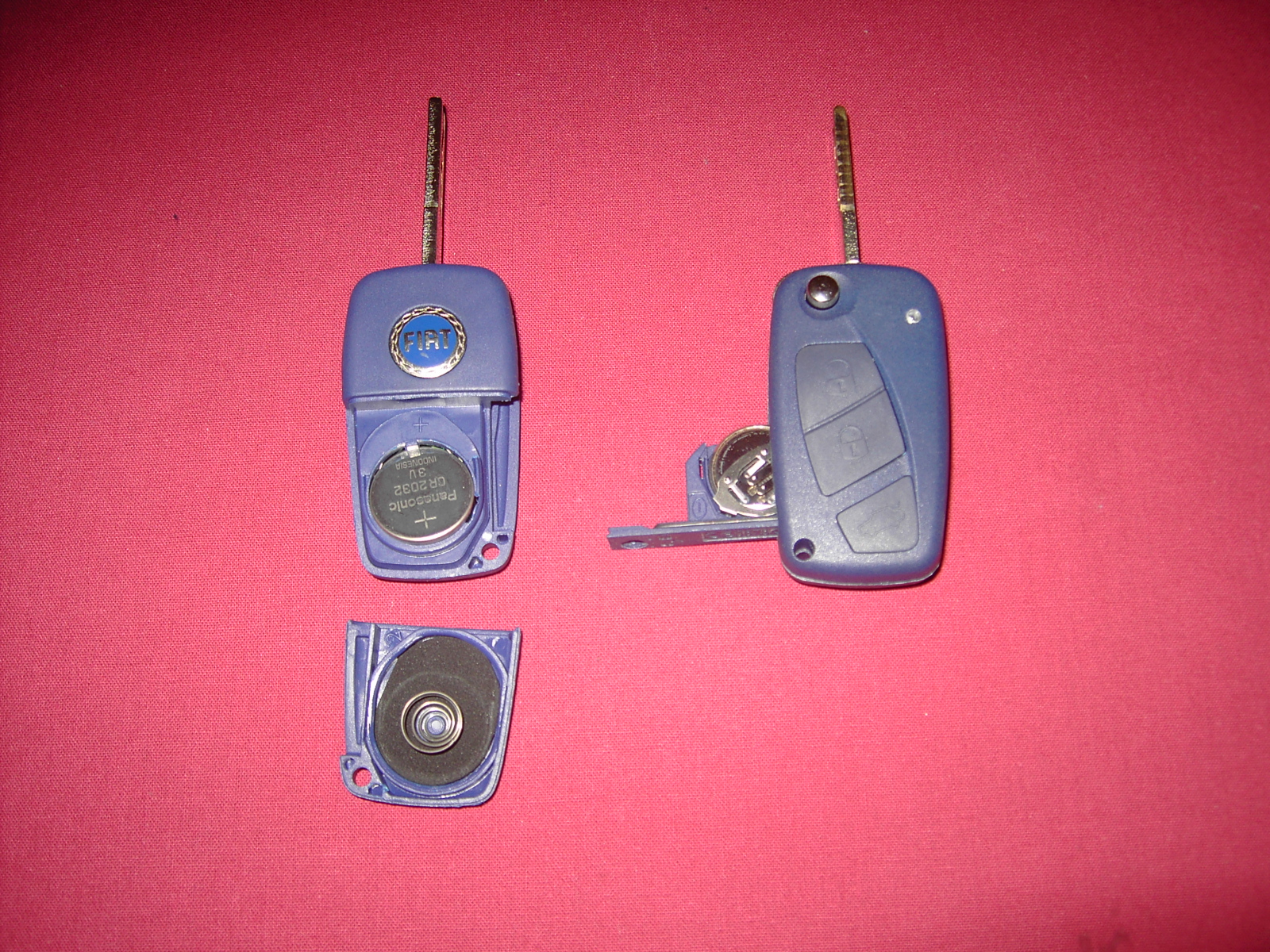

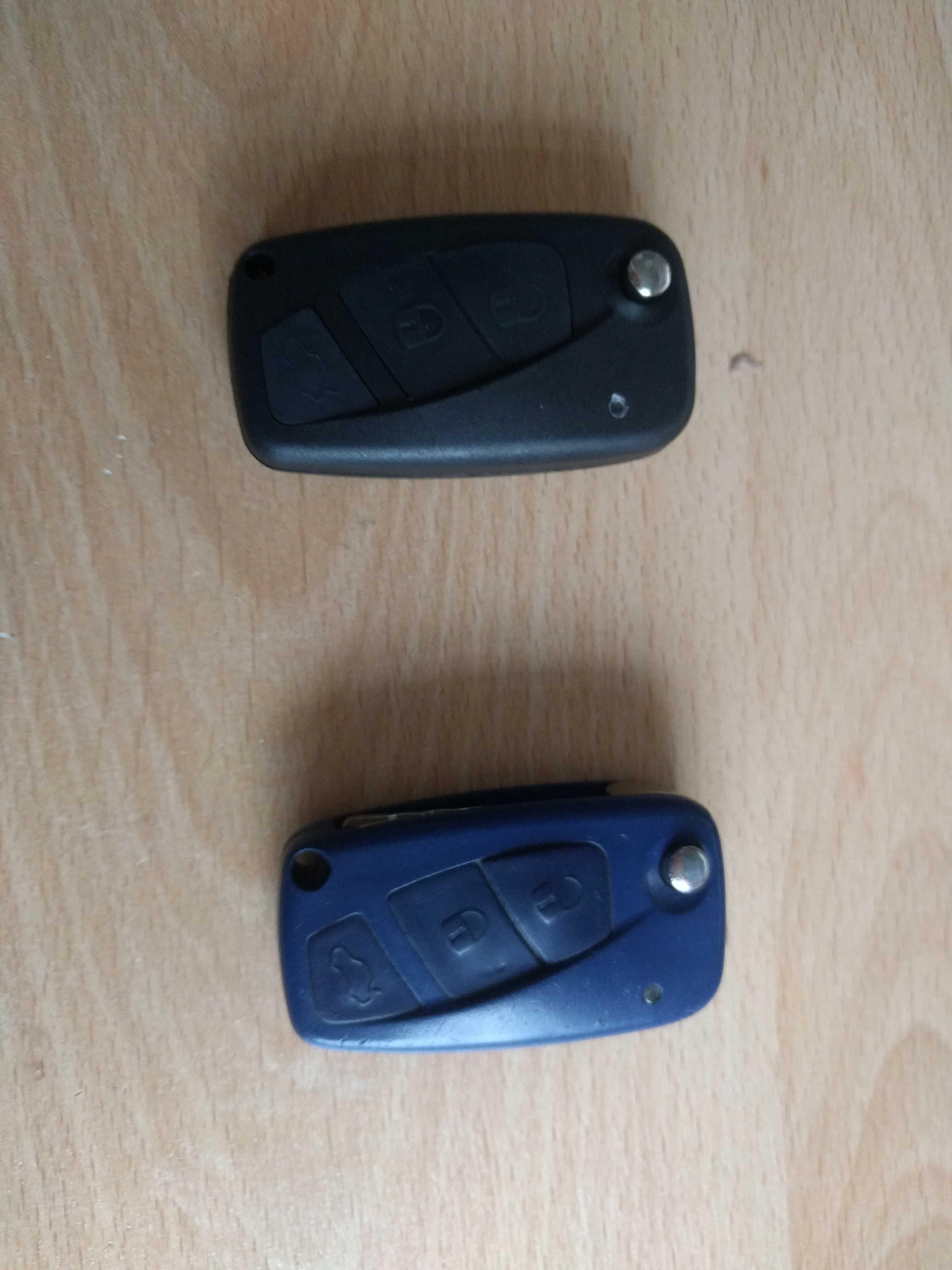

OK, so I like to fiddle and I like little details. As you'll see in my pictures, my original 3 button flip remote is looking a bit grubby and tired. It's also blue. My Abarth isnt blue. My Abarth is black. This simply will not do!
So for about £4 off good old eBay you can have yourself a new key fob case. You can get the normal blue or, because I wanted black to match the car, I ordered a black one. It makes it easier to see what's going on in the pics too.
