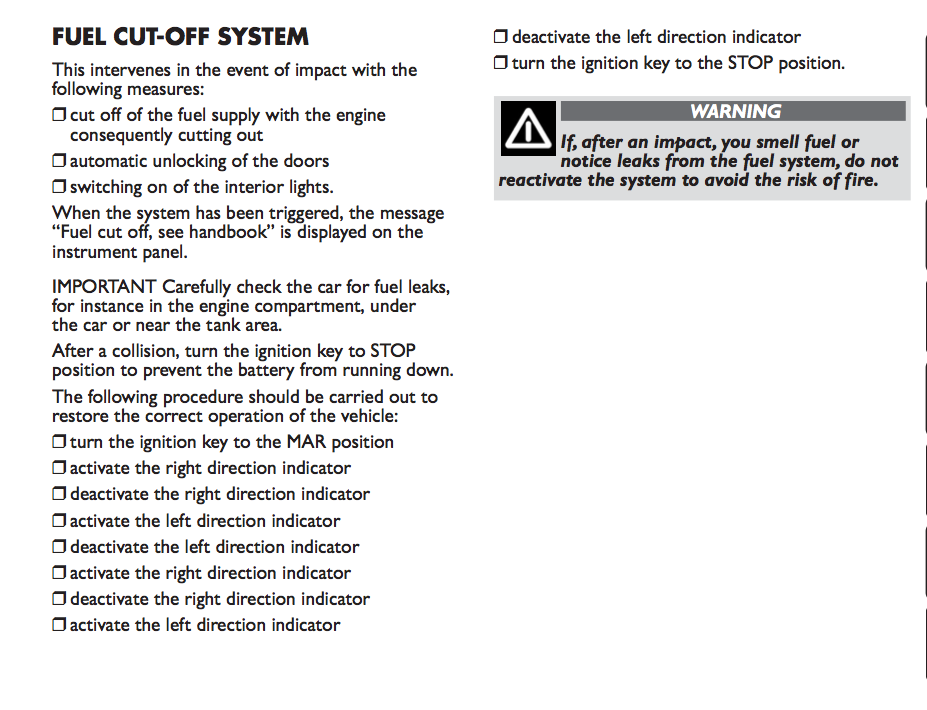

Hi,
I am new to this forum and desperately need help for my abarth 500.
I did a fun race last week (against the Minis) and in the last lap I took a bit too far when turned right so my left front tyre went to gravel for about 3 seconds. After that my car wont start and need to be towed to my home. Further checked with abarth technician he said it is because fuel cut off unavailable. He tried to do his things with the computer but until now he still could not start my car!
I need any help, if maybe some of you have had the same experience in the past and know how to solve it.
My car is Abarth Esseesse european version, 2010. I live in Jakarta Indonesia and now the official Abarth store has been closed for good!
Appreciate any help. Big thanks!
