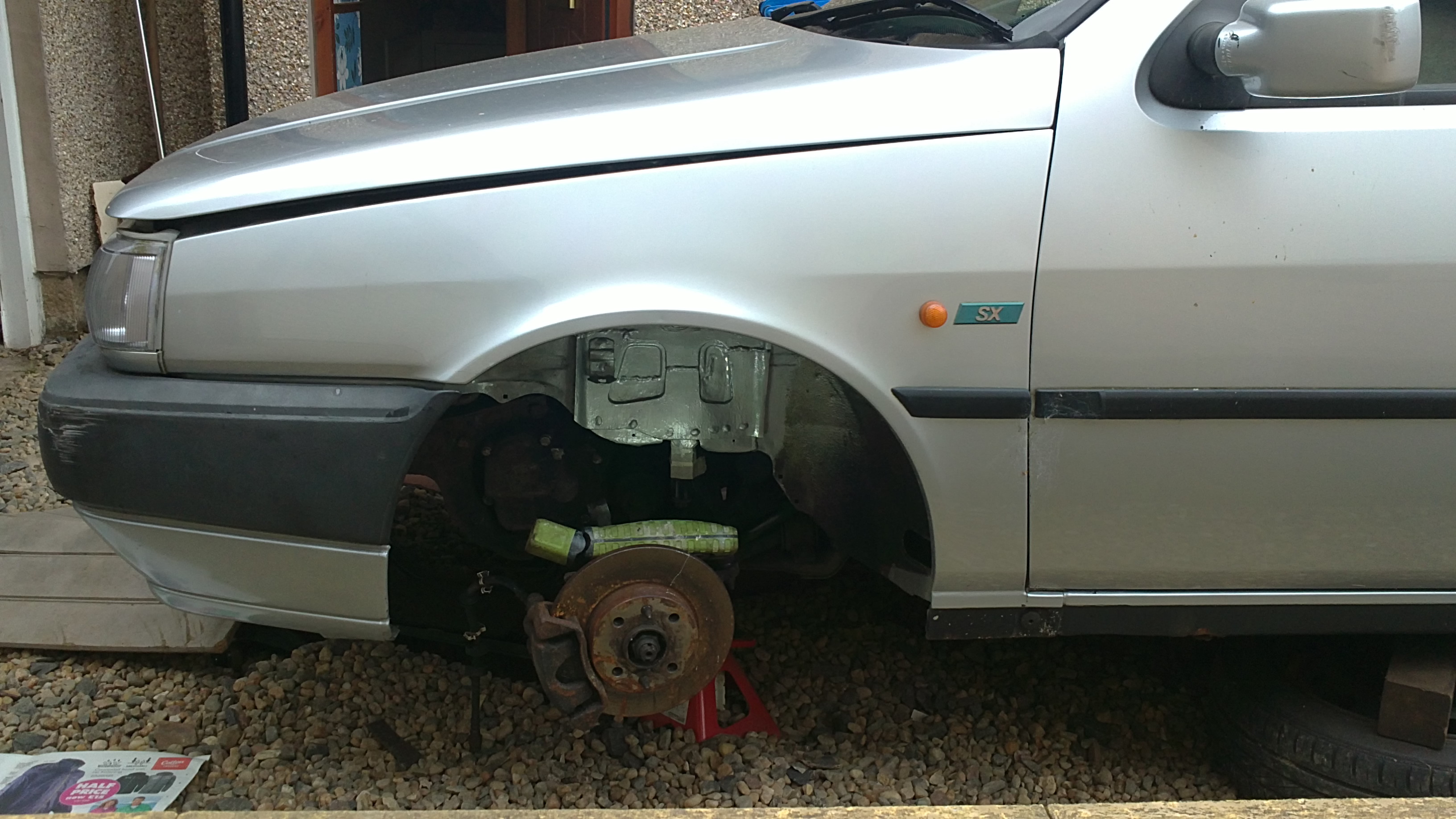

The holes behind the front struts will be the worst to fix, just above the sub-frame mounting bolts. Both my Mk11s suffer this.
Unusually the offside is worse than the nearside.

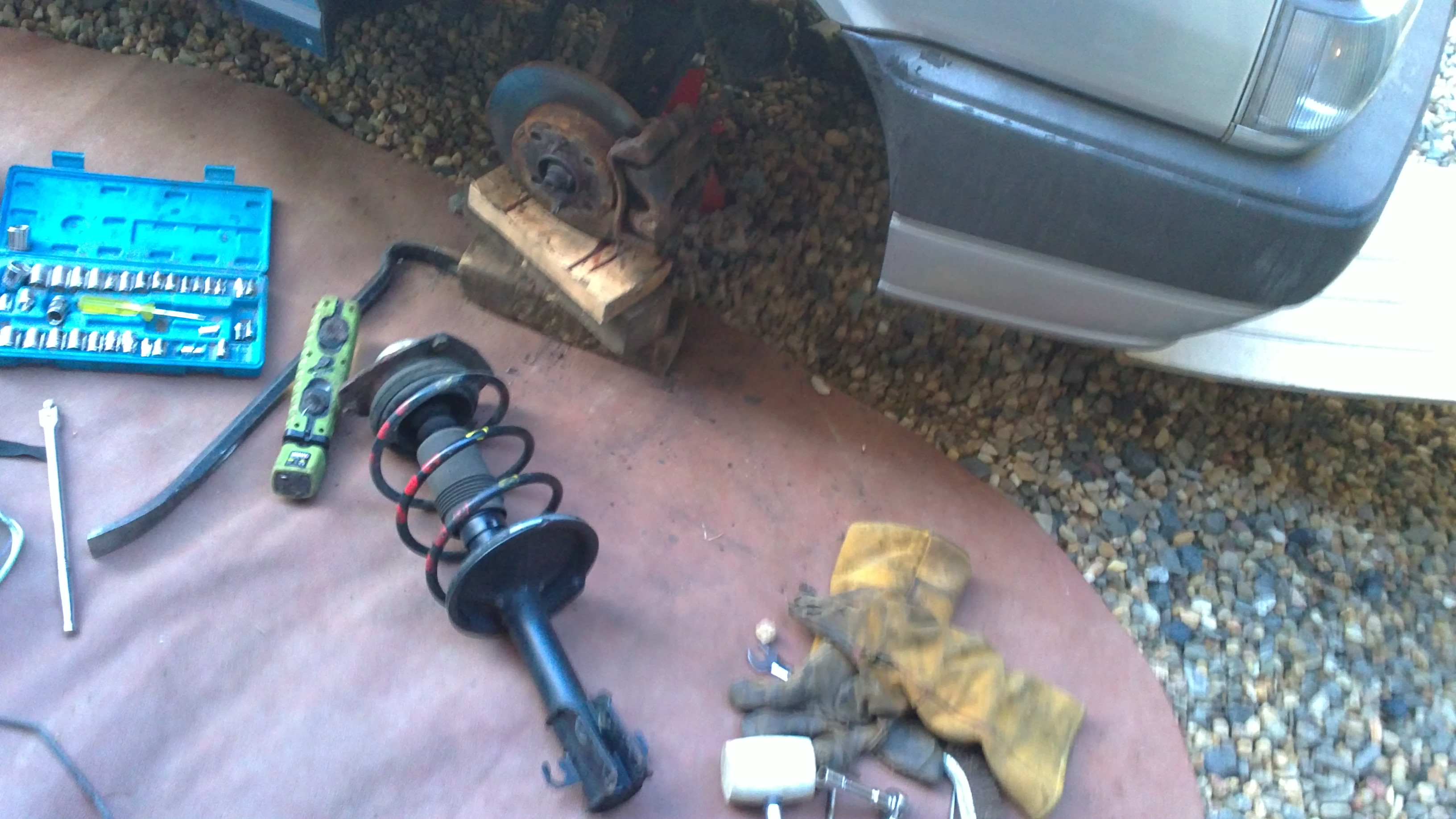

Struts and brake pipes have to come off on both sides to do the front.

The hole was largest on the front offside and it is double skinned in part, so there is an extra 2mm thick sheet on top of the usual 0.9mm sheet, forming the suspension turret, to reinstate. (n) This was the situation behind the strut on the o/side before and once all cleaned up. As usual there's more rust than first appears.

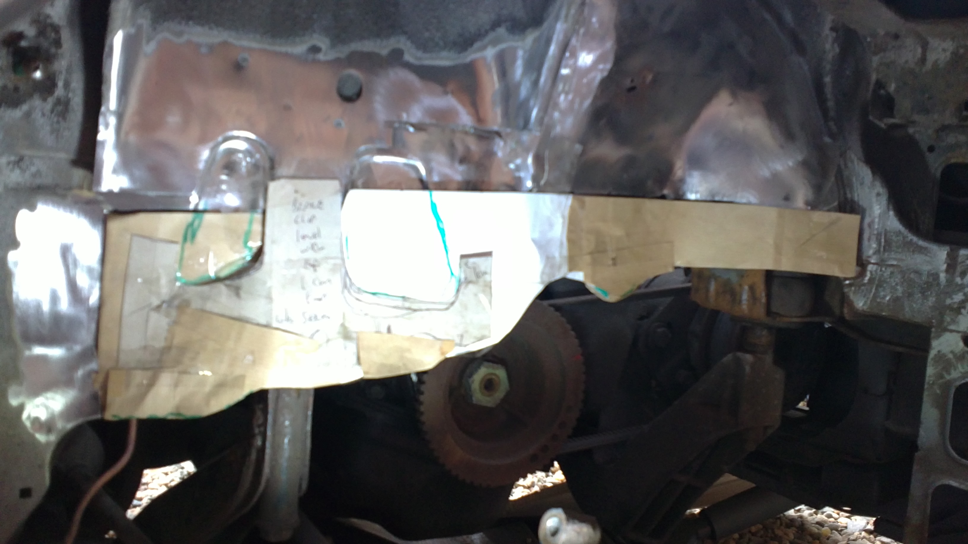

It wasn't initially clear what was going on here. Having cleared the rot out, the 2mm outer sheet has cut-outs revealing the 0.9mm sheet immediately behind. The resulting gap was simply seam-sealed meaning this splendid arrangement was likely to cause problems one day! :nutter:
The water must get in when the seam sealer cracks, or behind the raised edge of the 2mm sheet further up, where there was missing sealant, then run down and fester between the two sheets. The plastic protection in the front arches could have been designed to help overlap the edges but it stops short ! Useless! Time for a cup of tea.

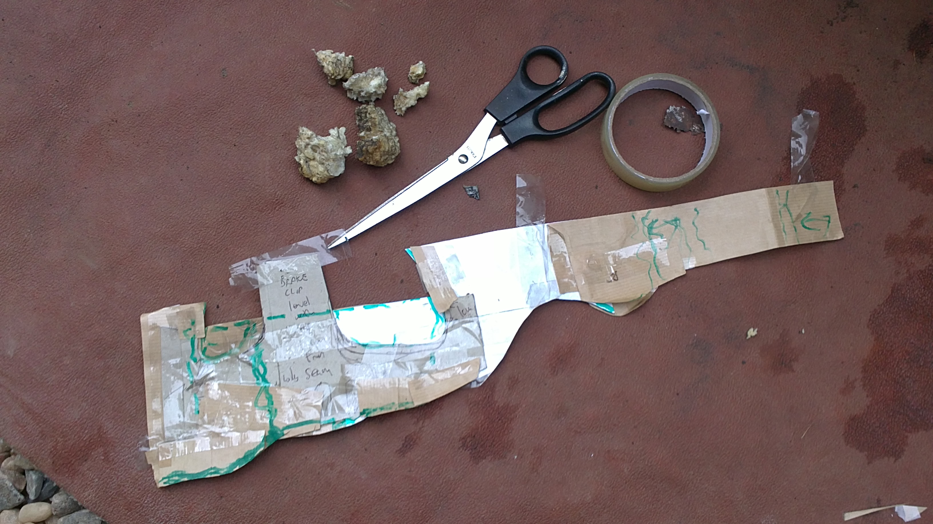

The next stage was to cut cardboard templates for the new sheet to go in.

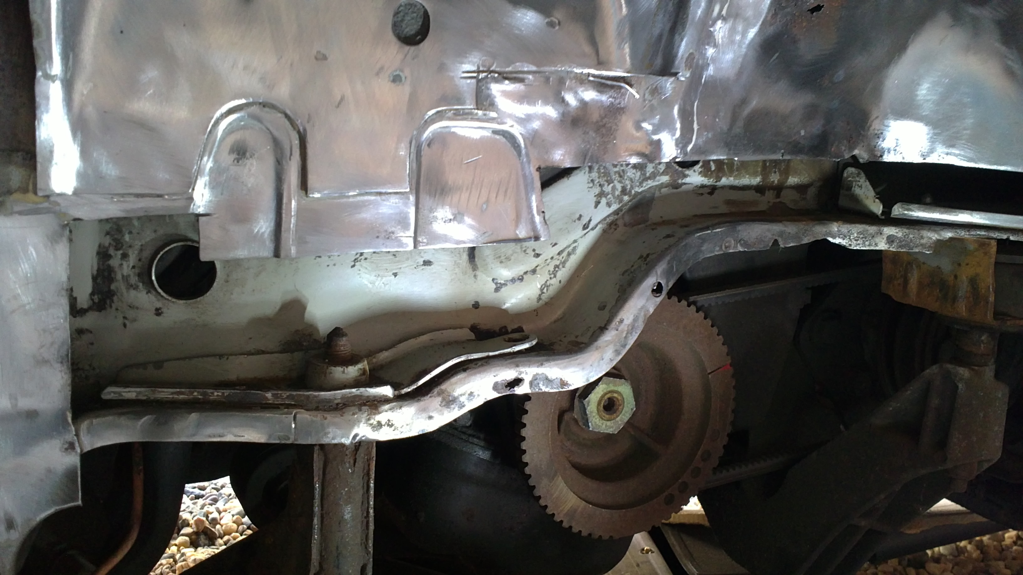

Turning to the other side it didn't look anything like as bad at first but it was a similar rot-fest. I cut the brake hose retainers off, cleaned them up and welded them back on. In place of the original spot welds plug welds were placed.

For paint, the more of a faff it is to apply and use, I take the view the better it might last in the long term! With that in mind, the paint for outer areas is Epoxy Mastic which appears to adhere very well and present a tough finish and by forming the base and top coat avoids issues with paint compatibility between coats. It can also can be mixed thick enough to avoid resort to sealer. Brush painting it is ok where the finish won't be scrutinised too closely. The concealed areas which are not exposed to spray were coated in galvanising spray. Time will tell, any other views welcome !

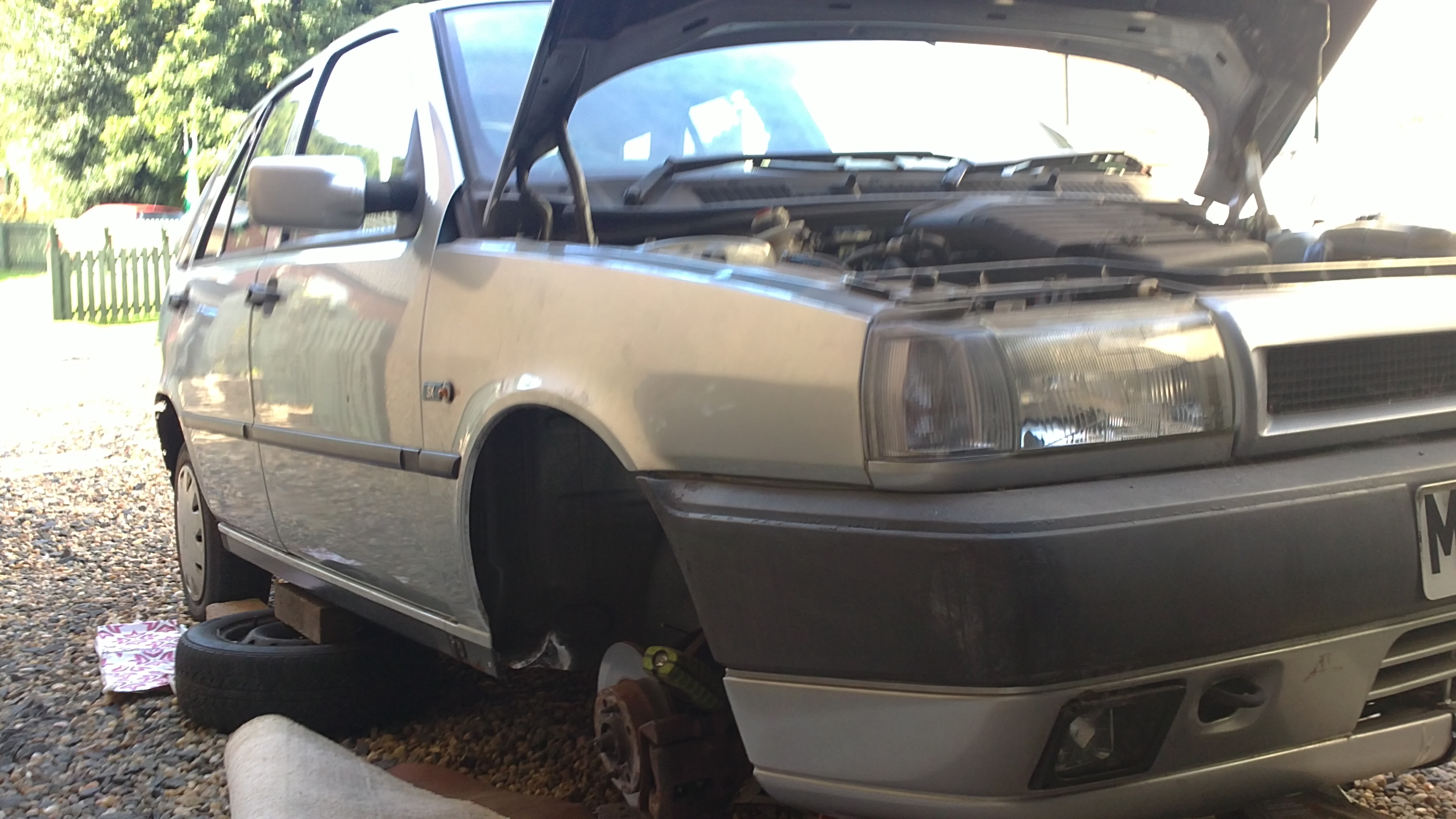

More updates. With the struts off I tidied underneath the strut tops, however, as it is the same piece of 2mm sheet it would seem unlikely to perforate any time soon, and I renewed the strut bearings which were looking a little rusty.
With a sill repair, front brake pipes, new wiper blades and sorting some lighting issues, the Tipo was ready for MOT...
