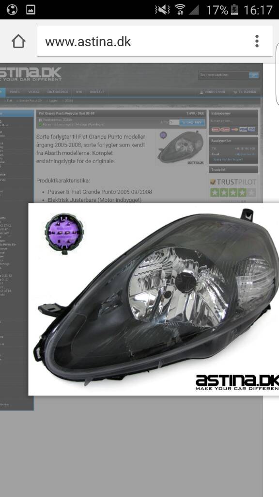

I just bought som new headlights (please see attached picture), and I was about to install them today on my Fiat Grande Punto.
But somehow I could not grt the old headlight out, it felt like it was stucked behind the front grill.
I just want to be sure, do i seriouslt need to take the whole front of my car off to put my new headlight on, or can it be more easily installed somehow else?
Please please please, give me a guide to how to install the lights, or remove the old ones og remove the front (if this needs to be done).
