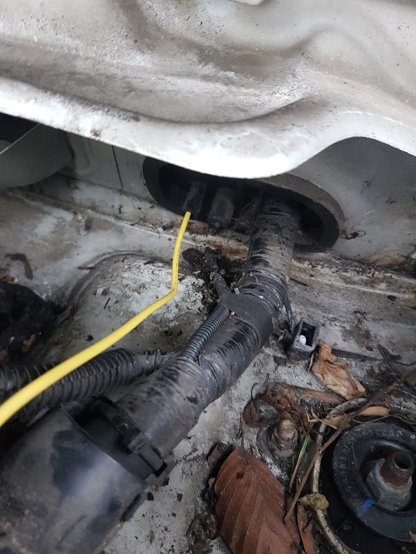

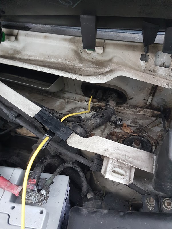

To save you loads of time. If you want to run a cable through the firewall you can on my model at least (2011 maxi cargo). Go through an exisiting grommet in the firewall which will put the cable up and behind the glove box. I've attached some pics that will hopefully help.
