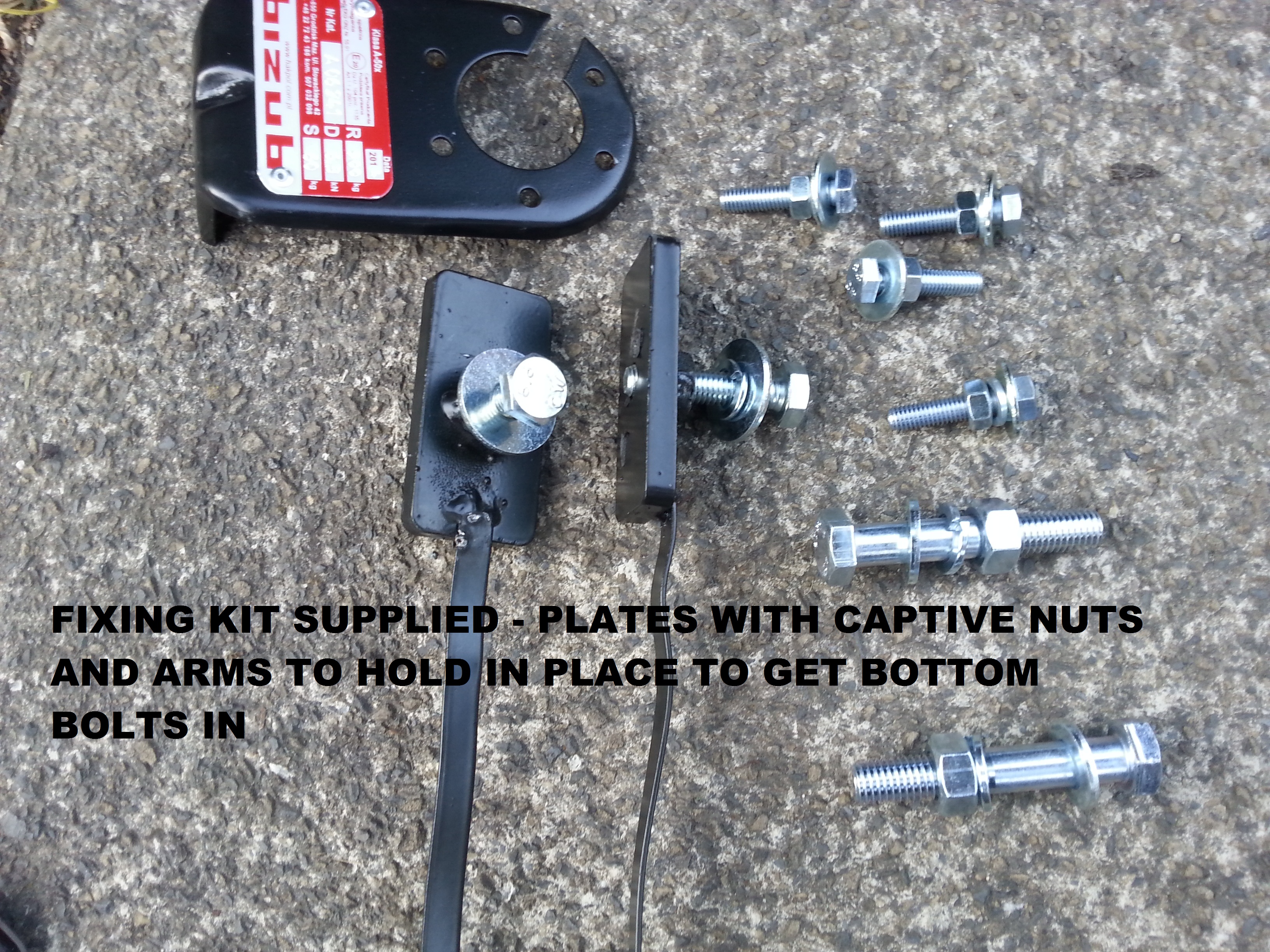

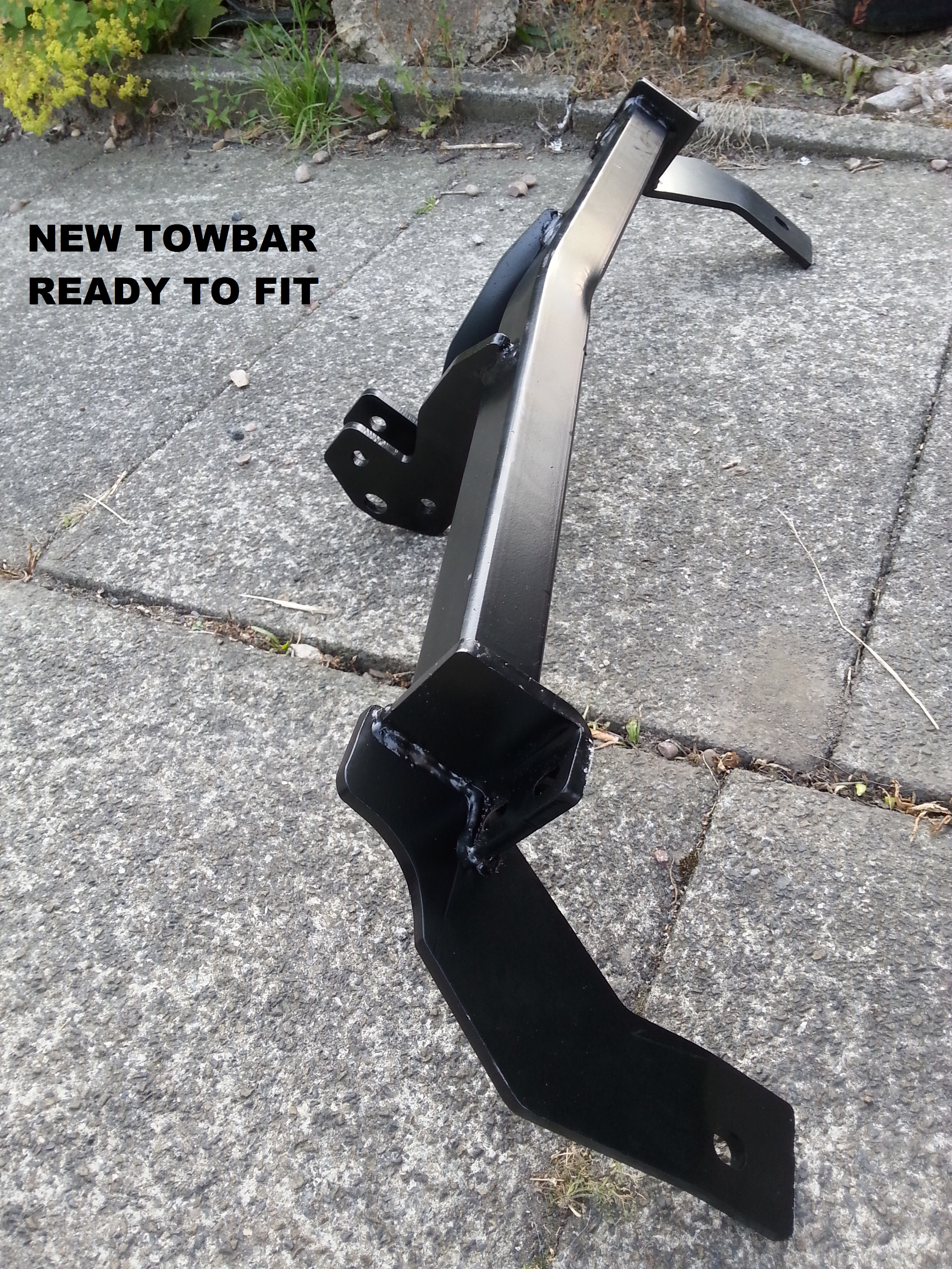

first impressions good solid bar and complete with everything you need to fit it.

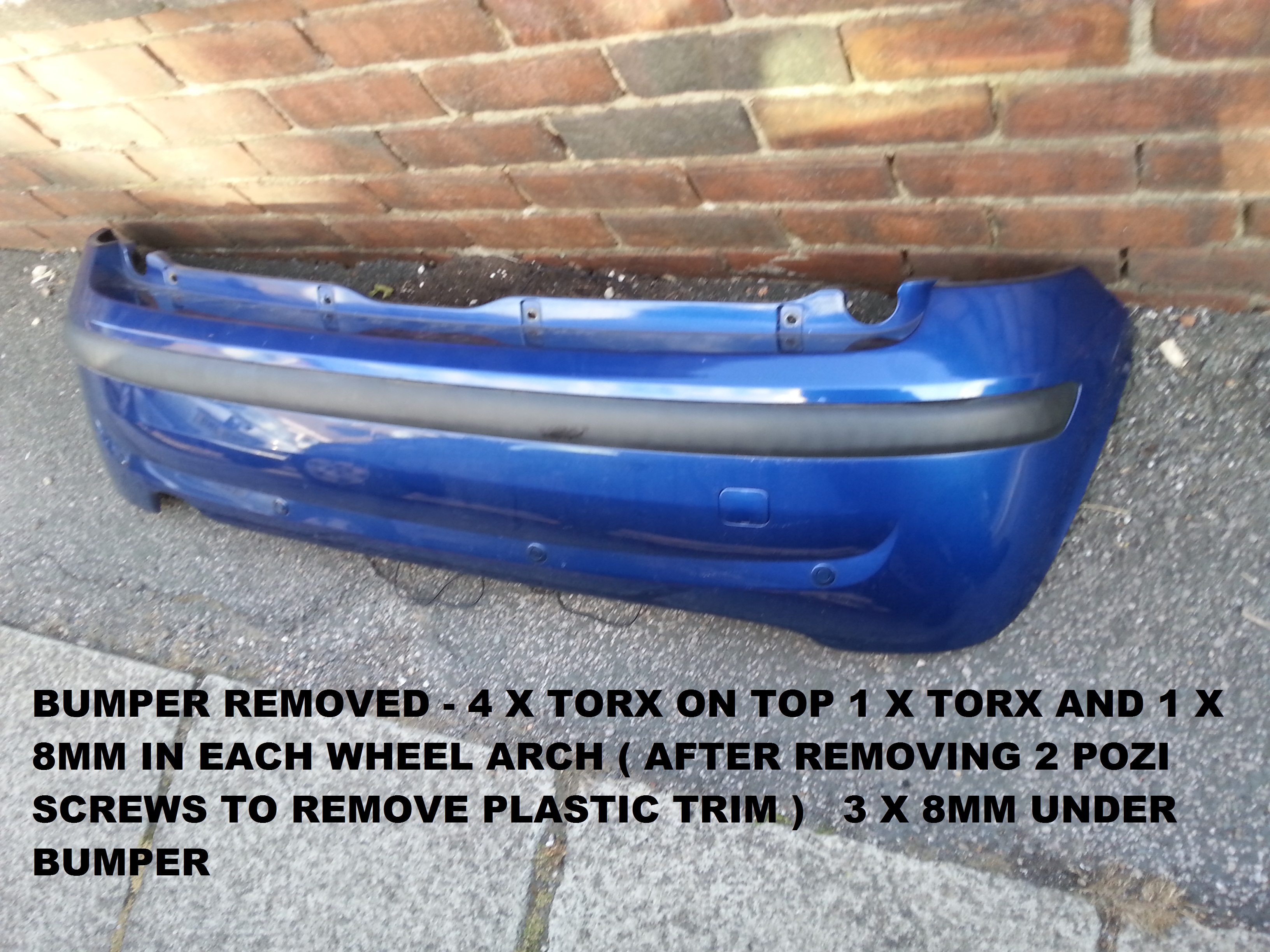

a look in the haynes manual tells you how to get the bumper off which was not as bad as i expected - was going to leave till weekend but thought would see how bad it was.

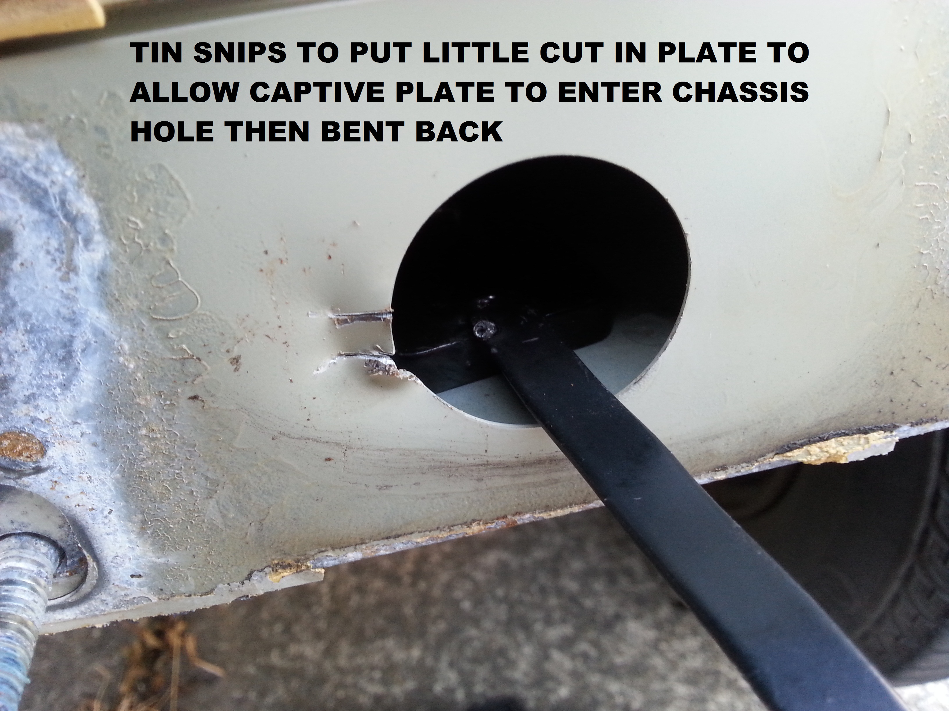

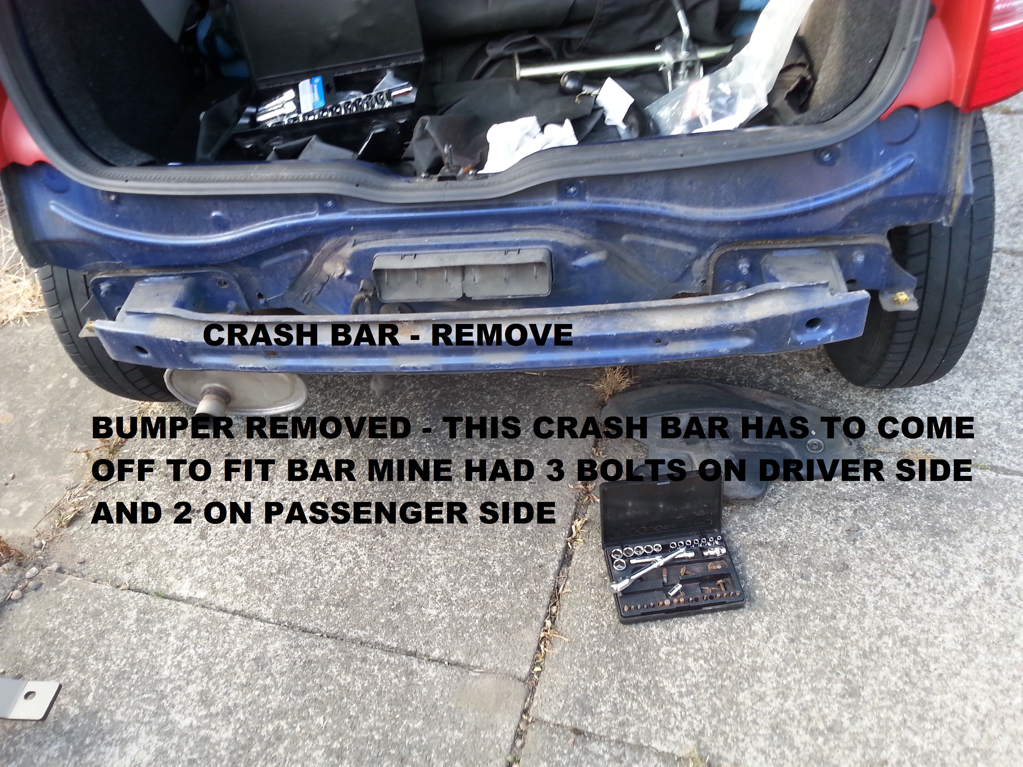

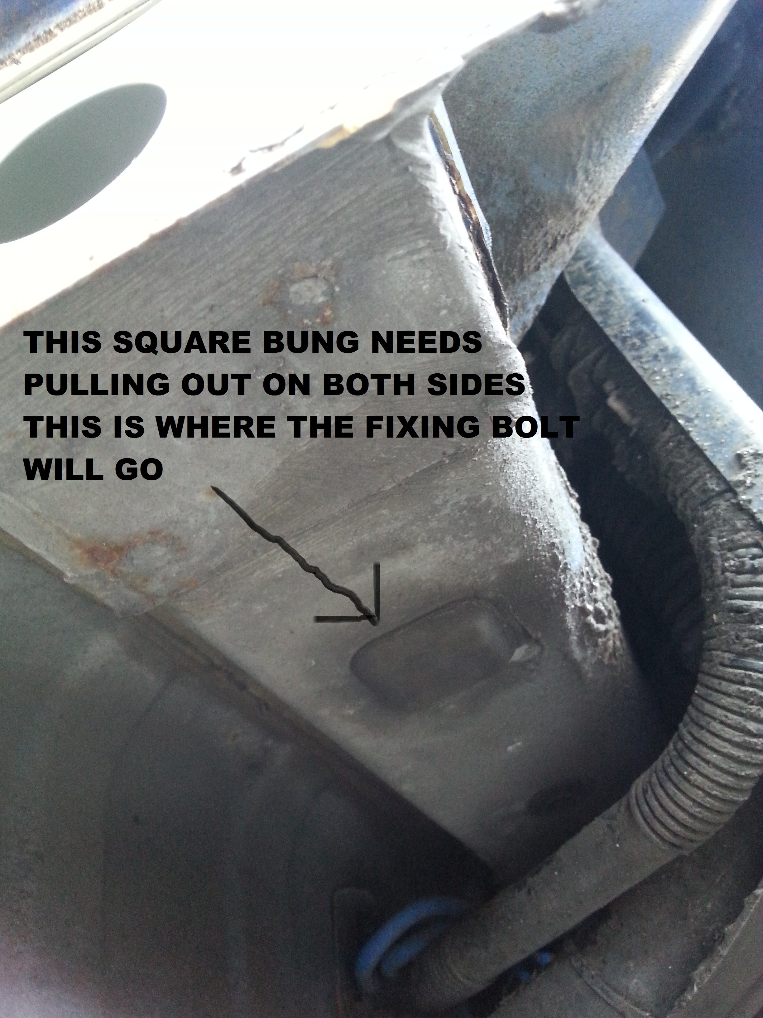

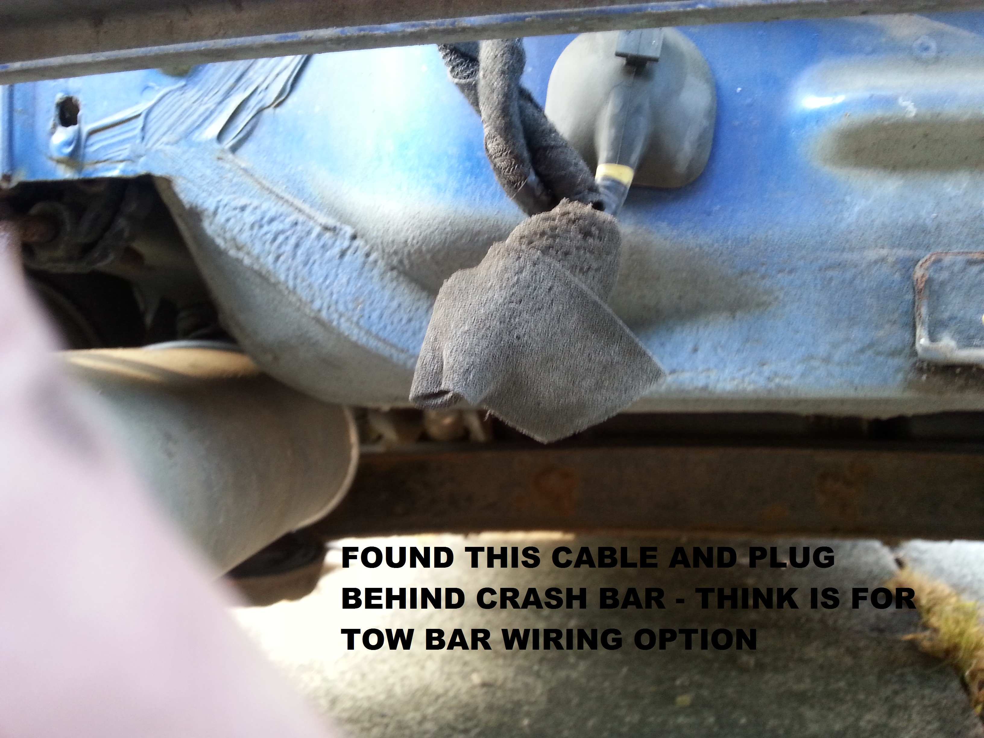

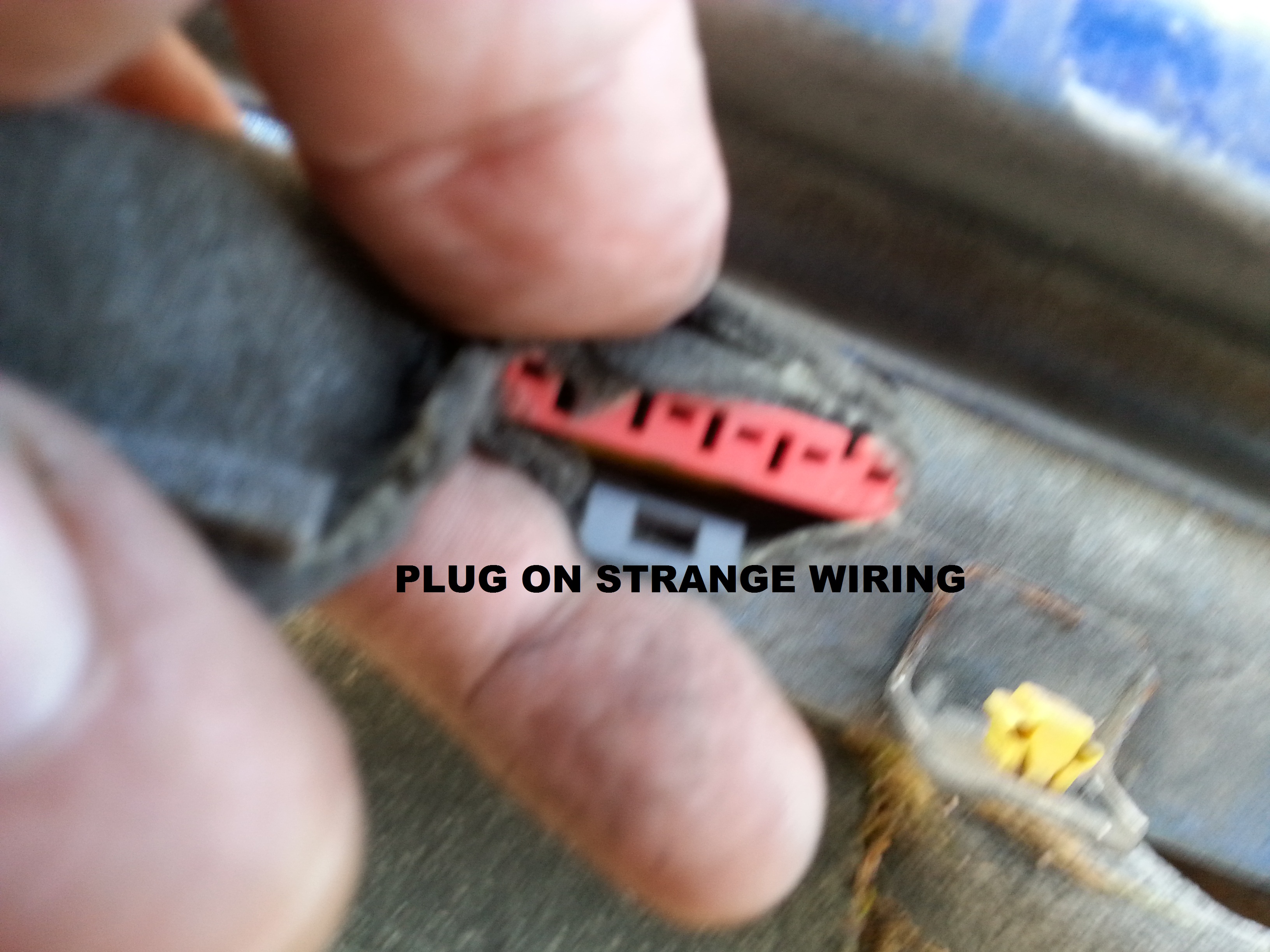

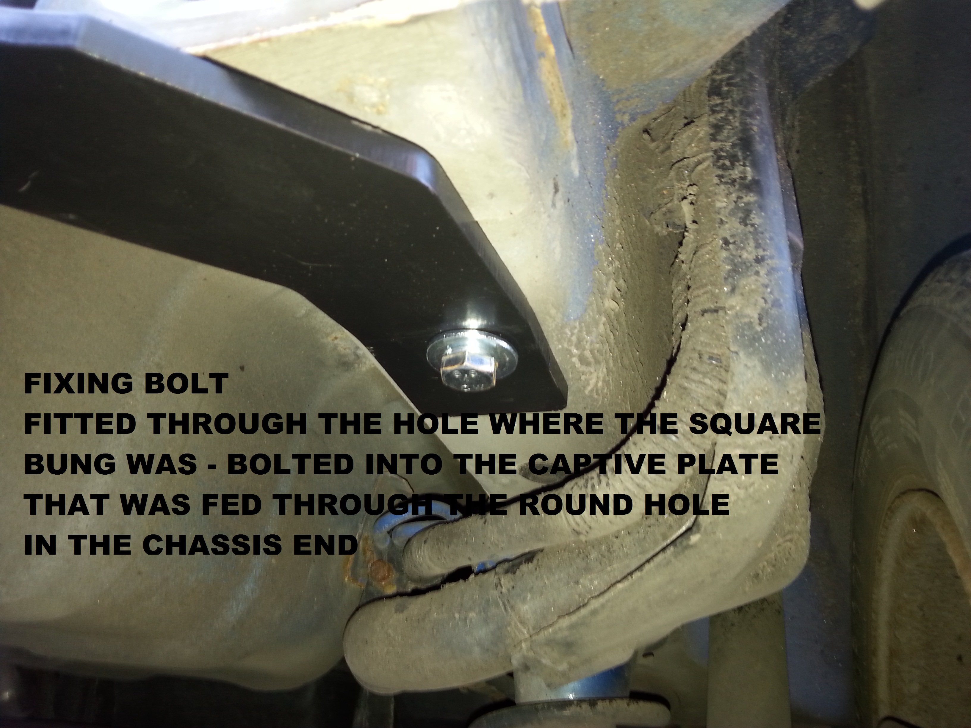

bumper was off in 15 mins, some of the screws in the wheel arch needed a bit of a fiddle but otherwise was ok - only problem i came across was the captive plates needed to bolt the bar through the chassis were too big to fit through the hole in the chassis end cover but 2 mins later and a cut with tin snips soon had it sorted. you are supplied a full set of bolts but didnt need 3 of them as car had captive bolts holding the crash bar in place - so reused them - did find a cable hanging down at the rear of the car which i assume to be wiring for the tow socket but probably needs a expensive module adding somewhere to the body computer so just pushed it back inside car boot and will use the very comprehensive wiring kit that came with the bar. bumper off, bar fitted and bumper back on on my own all done in under 2 hours - have wired the tow socket but not connected inside the car yet.
all pics have comments on for guidance. The bar is rated at 900 kg towing though the gross weight of my trailer is 300 kg.
very pleased with the build of it - only downside is the instructions were in polish but didnt need them as a picture tells a thousand words.
Oh forgot to mention there is NO BUMPER CUT required unlike the Witter and Westfalia bars
