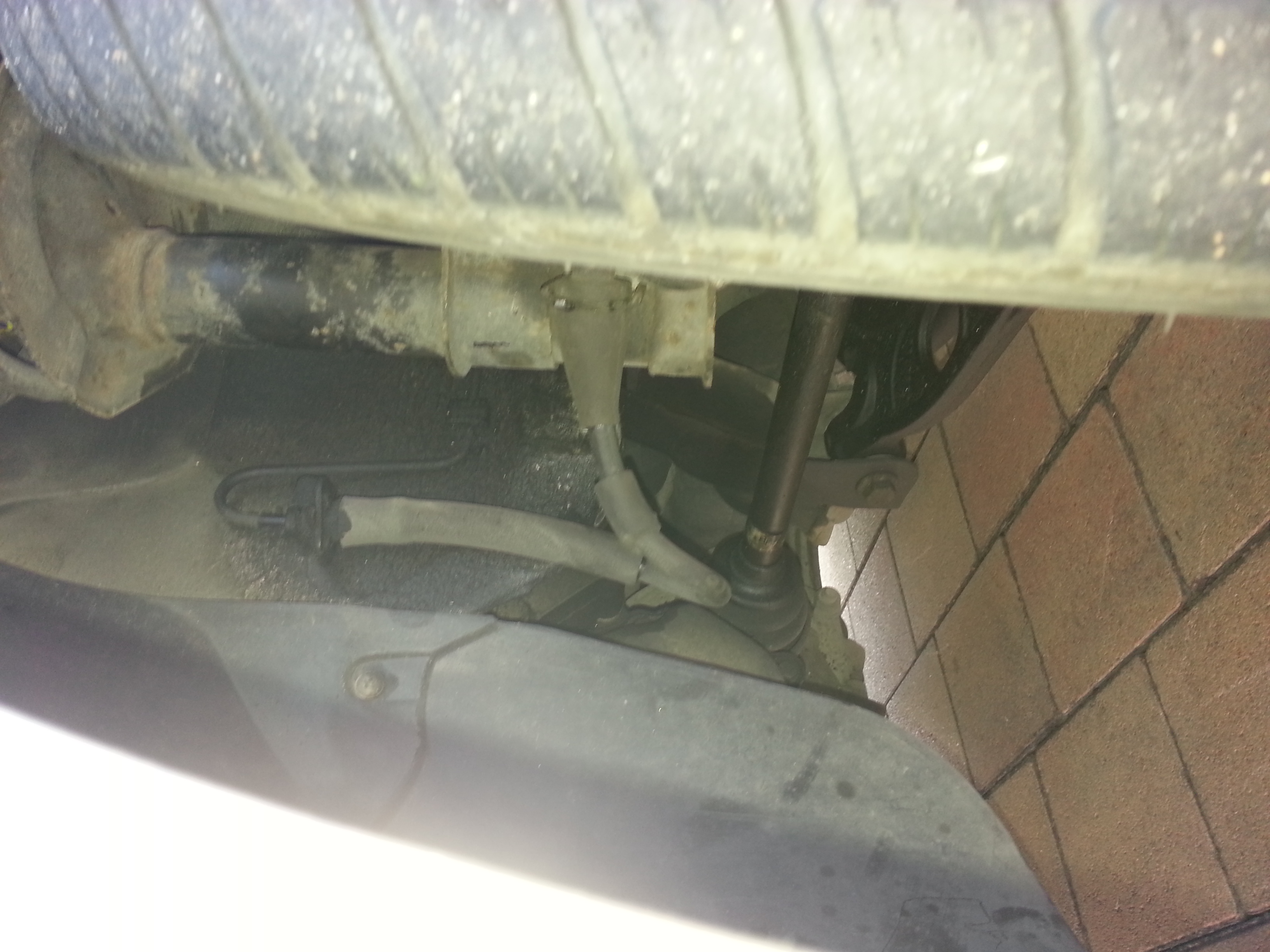

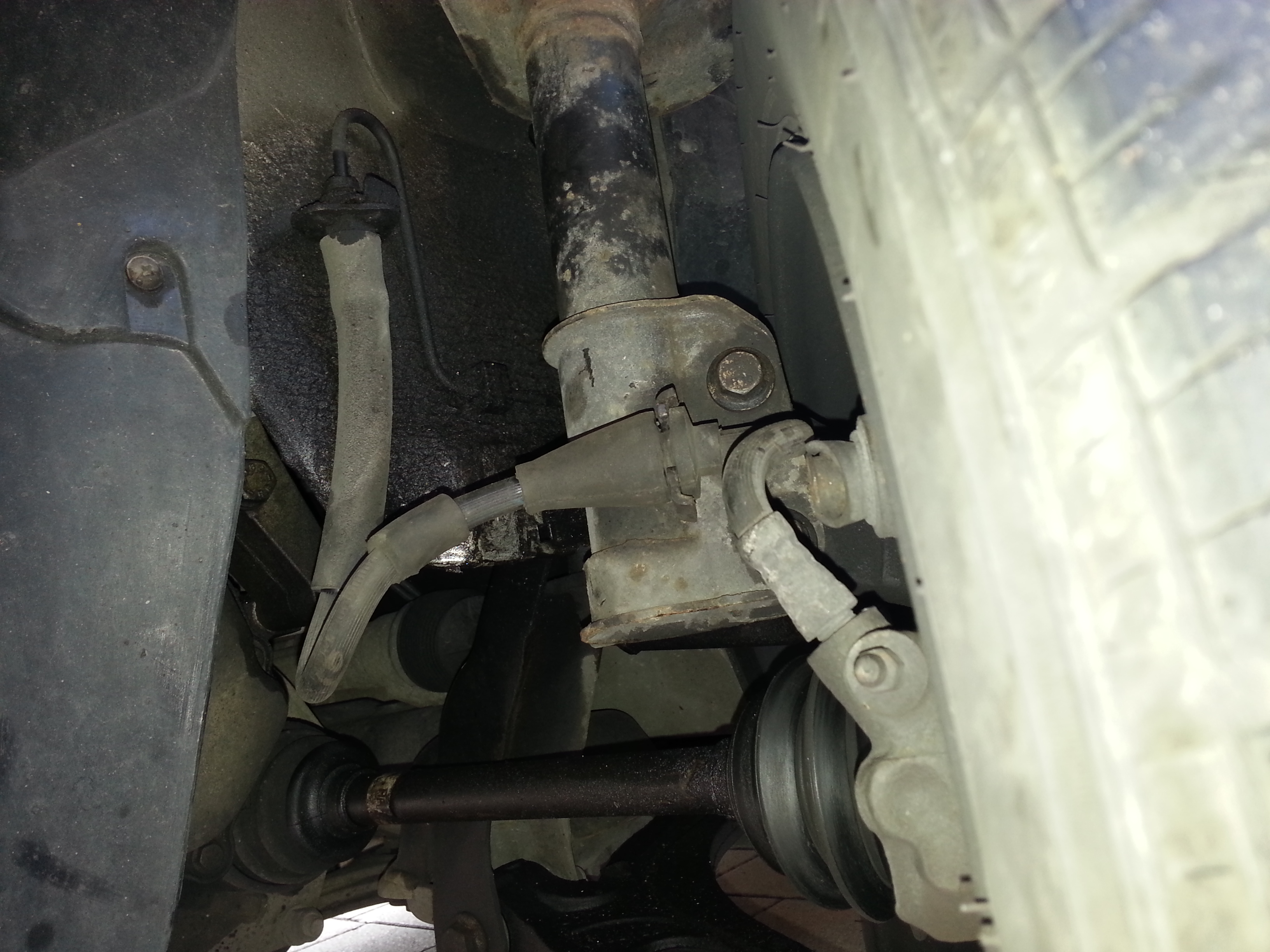

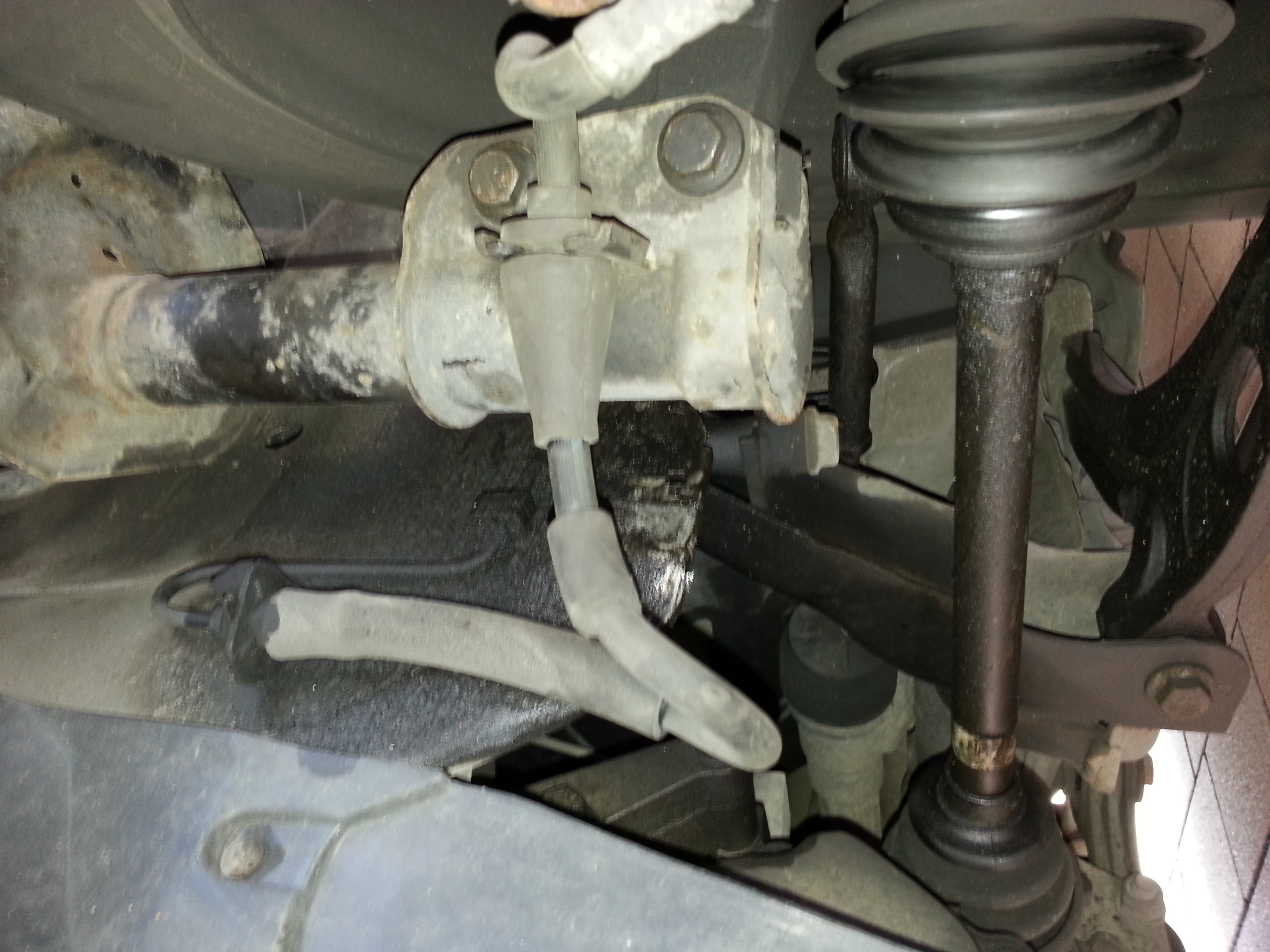

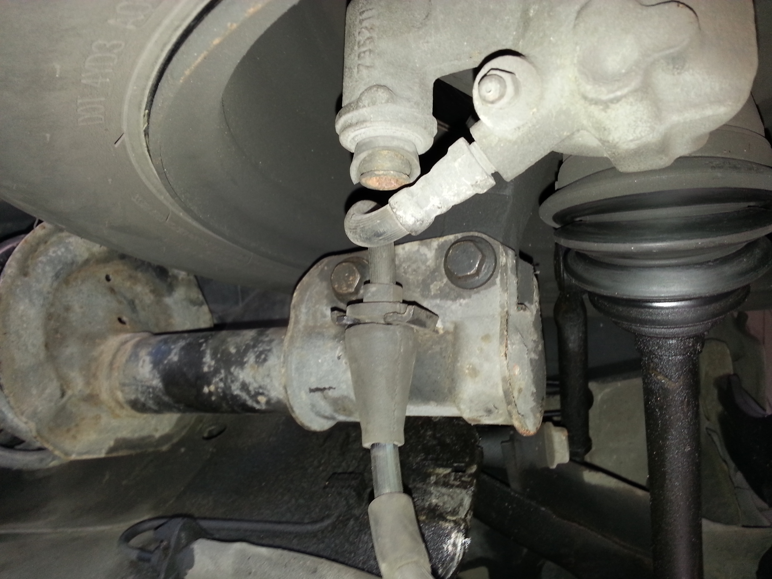

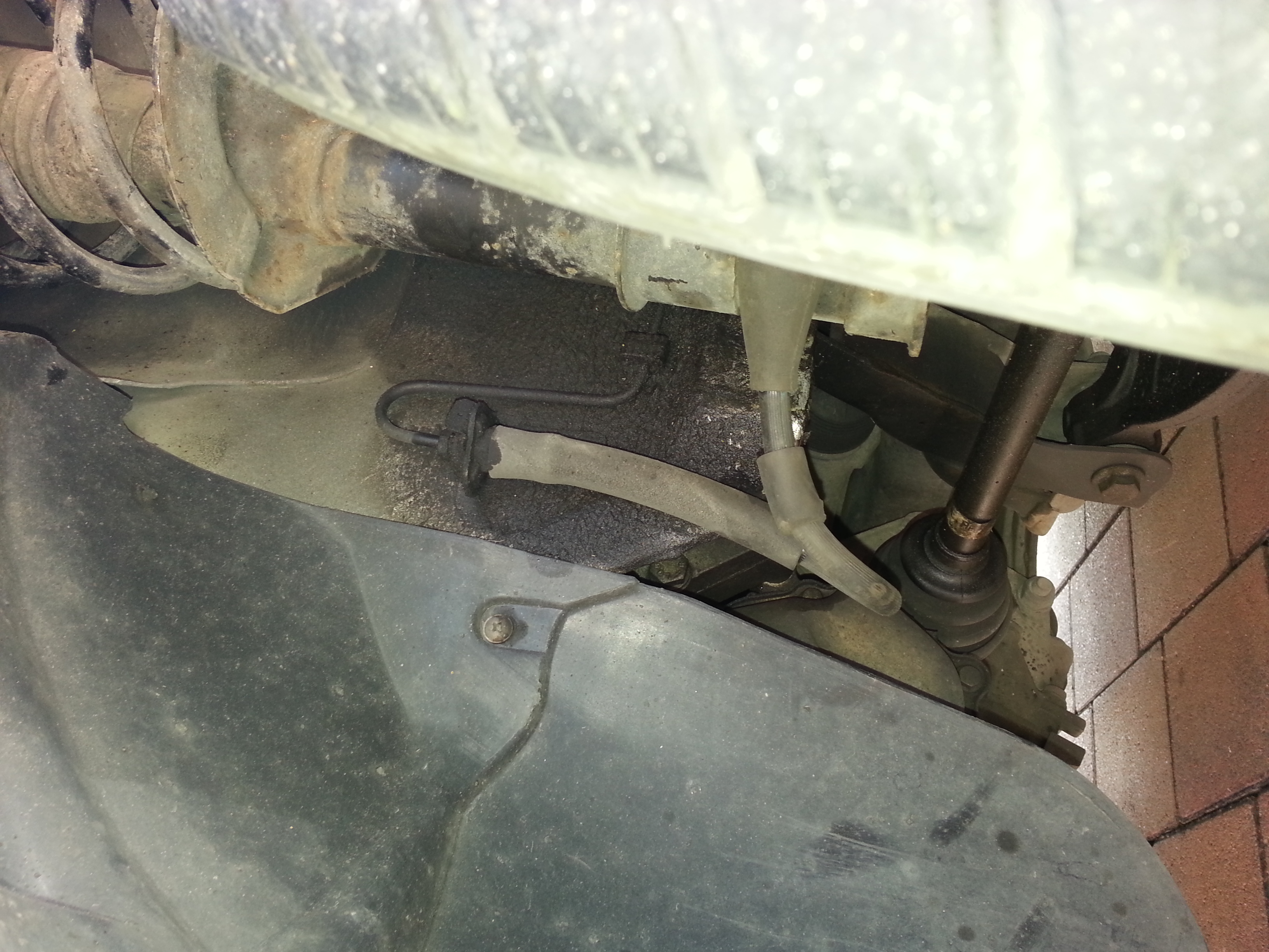

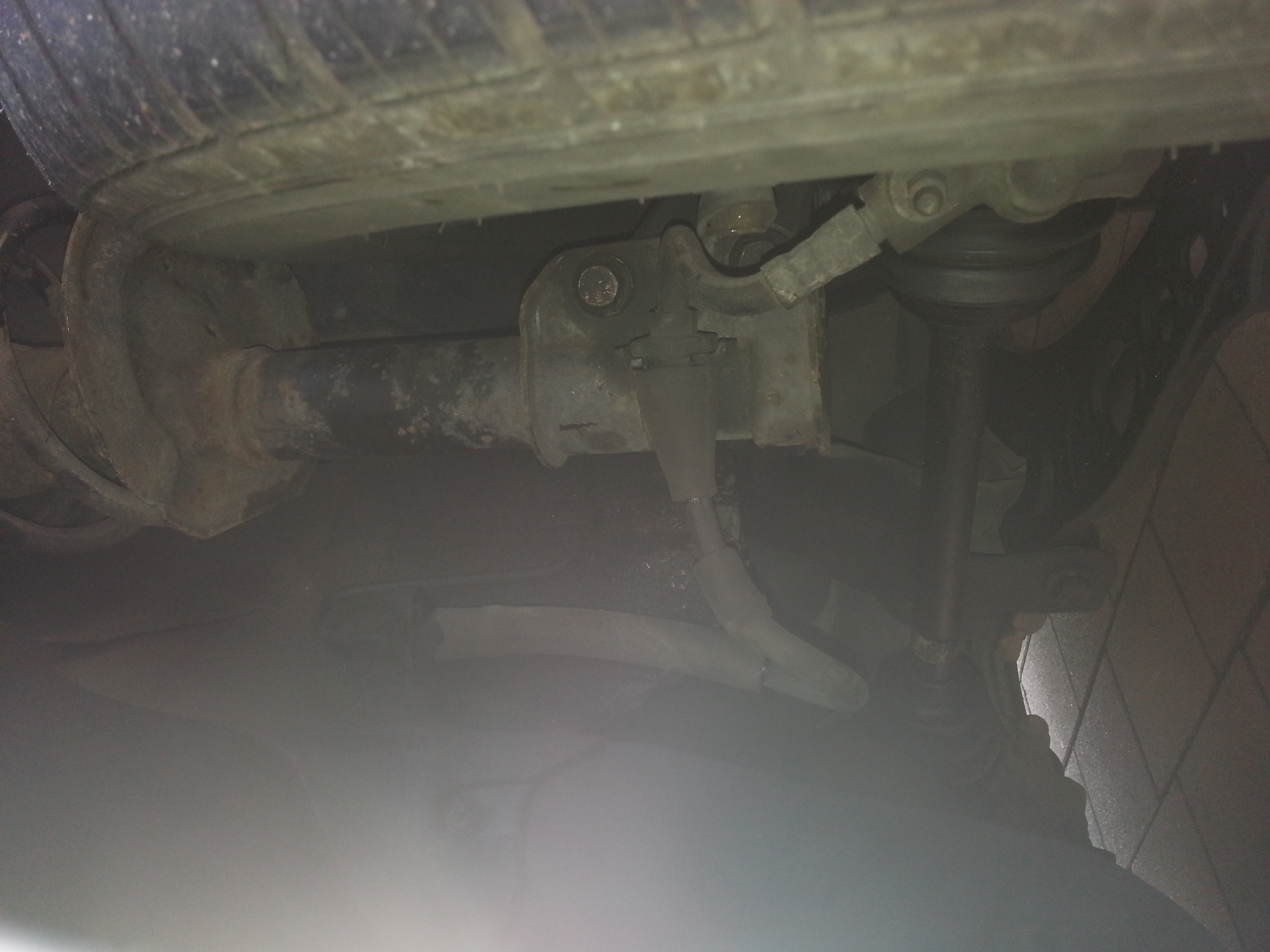

I think thats what they do look like, trying to post pictures i just need 5 posts first
good pic that :D
is this punto on fork lift truck..
car looks like its in mid air.
i downloaded it for threads like this but it looks like a wheel free ramp to me:)
ive looked again yes a forklift
those pictures posted up last one looks wrong but quality is proper crap:p
Fantastic Ill get them switched around ASAP
you'll struggle - your missing 2x brackets which allow for this
You need to visit a scrappy and see if you can pull them off
They seize and rot together - so many people simple snap them off
Dont bother redrilling the brackets bolt hole and sticking a fresh nut and bolt in
As a result - you end up with your problem
Trust Me and S+B you are seriously risking your life
