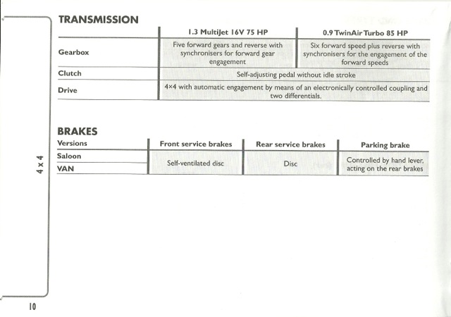

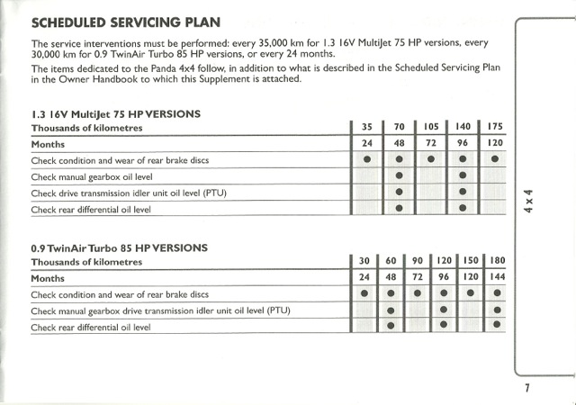

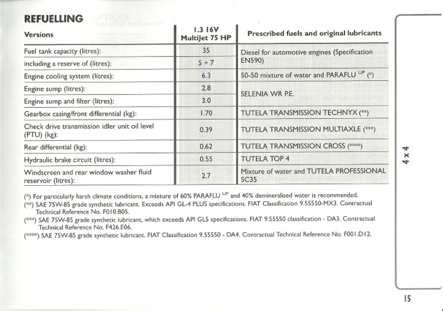

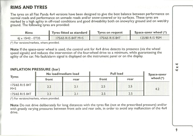

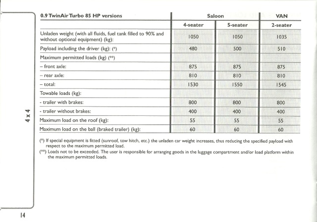

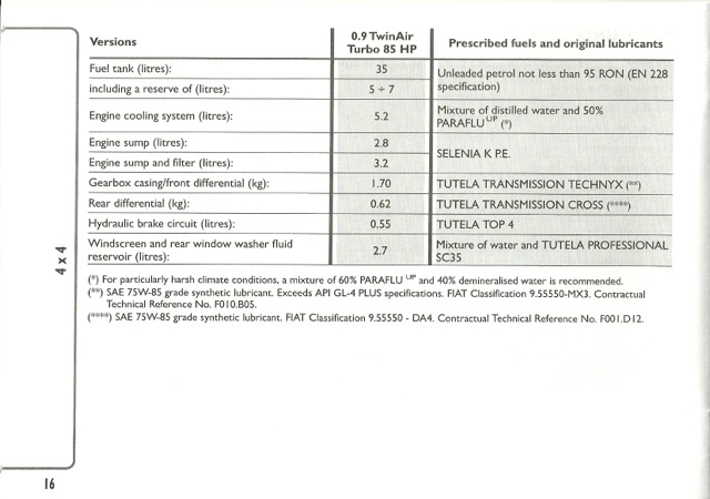

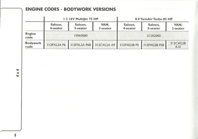

In case others are also missing the correct manual for their 4x4, I hope this is of some use to you. This version appears to have all the variants covered, including the elusive VAN...
Enjoy
Enjoy
