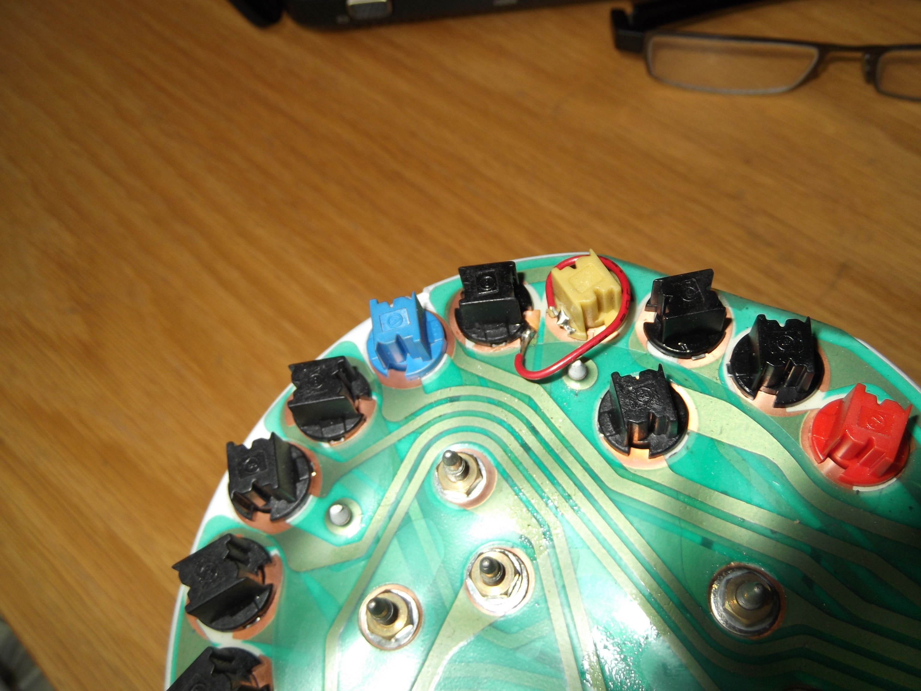

I had to get my Barchetta trough yearly inspection yesterday ... I could not reset the alarm so instead I modified the "meter panel" (sorry s130 ... I do not know the word) . Now the airbag light work together with oil pressure light. This needs one 2cm jumper cable and 30min time. I know, that lamp works fine, but airbags will not safe my life. I got my B trough inspection and now I need to reset the alarm before accident.

Well pekval no apology required. The word/words you were looking for are "instrument panel" or "instrument cluster".
About the Finnish translation ...... blame Google Translate!!!!!!!
Your modification to the light wiring certainly fooled your testers. You were lucky :) but well worth doing. I would have chosen the ABS light (if you have ABS) as then the engine does not need to be started to turn off the oil/airbag light.
