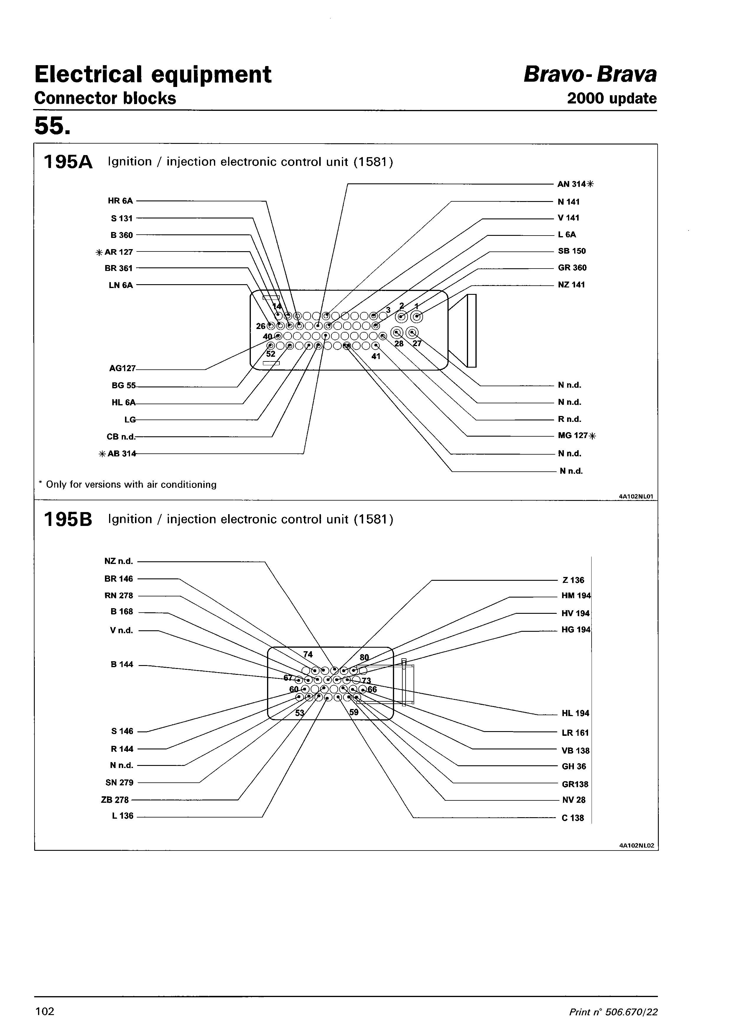

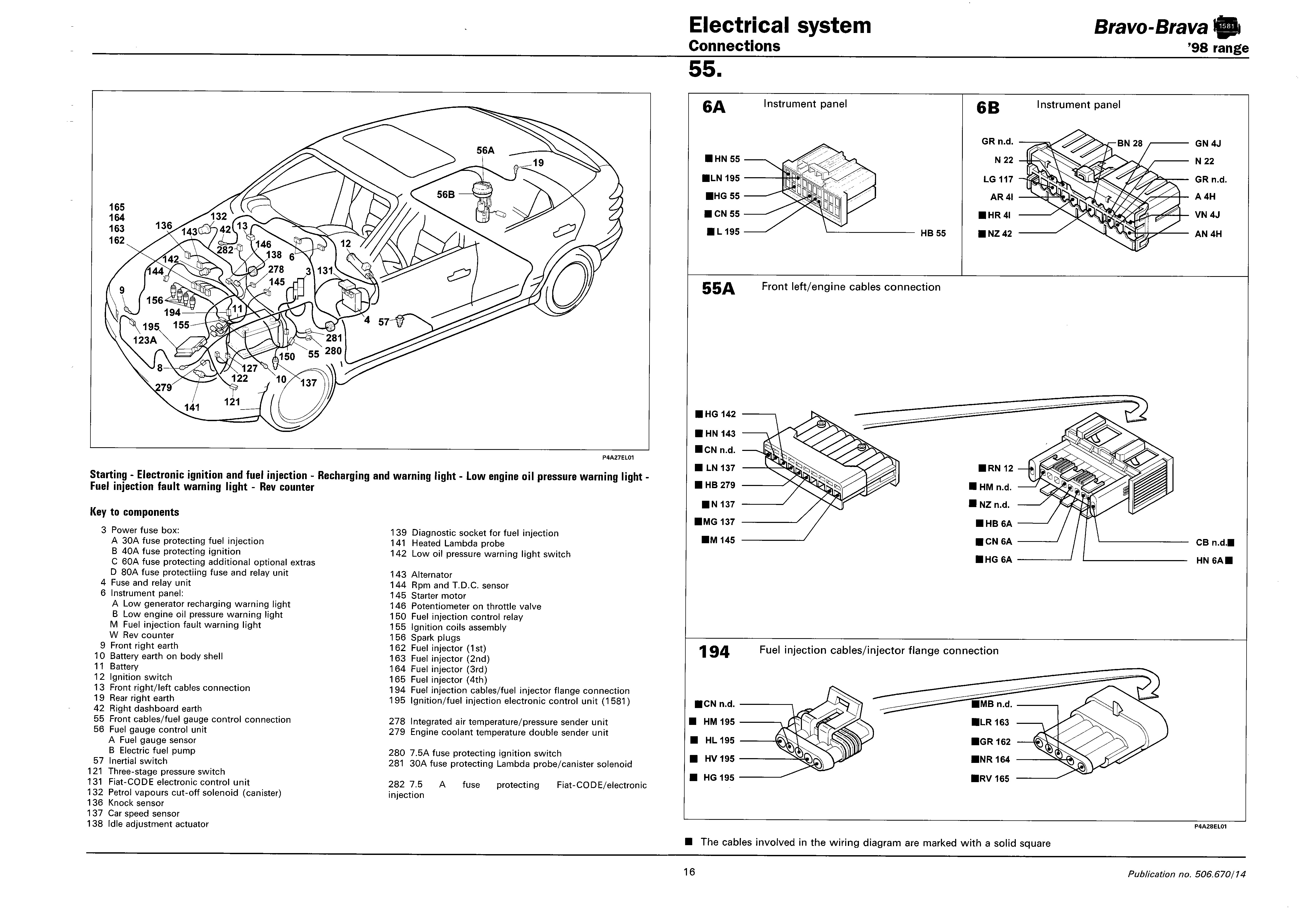

C cragterharris New member Joined Sep 2, 2009 Messages 2 Points 1 Location Leeds Nov 12, 2012 #1 Hi I'm looking for a ecu/engine wiring diagram for a 1.6 16v brava. Cheers
Adrian Bravo Speedbump grimacer Parked in the garage Written 5 guides Joined Mar 13, 2008 Messages 5,542 Points 1,015 Location North West Nov 12, 2012 #2 Hey welcome to the forum, What year are you looking for? Mk1 1995-1997 Mk2 1998-2001
Adrian Bravo Speedbump grimacer Parked in the garage Written 5 guides Joined Mar 13, 2008 Messages 5,542 Points 1,015 Location North West Nov 12, 2012 #3 My manual gives this for both Mk's on the 1.6; https://www.fiatforum.com/gallery/data/2312/radio-pins-02.jpghttps://www.fiatforum.com/gallery/data/2312/1242-late-ecu-plug-01.jpg EDIT: added colour code chart; Last edited: Nov 12, 2012
OP OP C cragterharris New member Joined Sep 2, 2009 Messages 2 Points 1 Location Leeds Nov 12, 2012 #4 Absolutely brilliant Thank you
