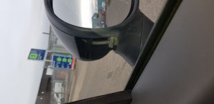

Step 1: Remove the mirror glass
If dirty you may wish to clean the mirror glass before removal as it is very easy to scratch mirror glass if handling when gritty.
Use the electric/manual mirror adjuster in the car to dip the mirror glass down (so the top of the mirror glass is poiting downwards).
Use your trip removal tool (preferably) or flat head to gently pry off the mirror glass. The mirror glass is held in place with tabs (not adhesive).
Electric/heated mirror owners beware!
There are wires connected up to the mirror glass. Do not try to snatch the mirror glass to far as the wiring is very delicate. You should be able to rest the mirror glass just under the mirror on the window ledge, or better still ask a friend/girlfriend/wife to hold it for you!
