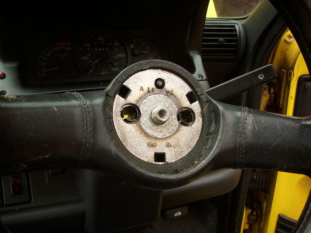

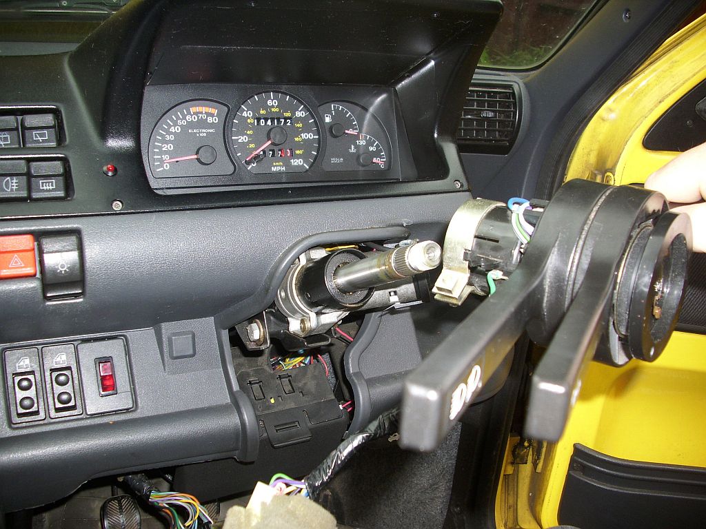

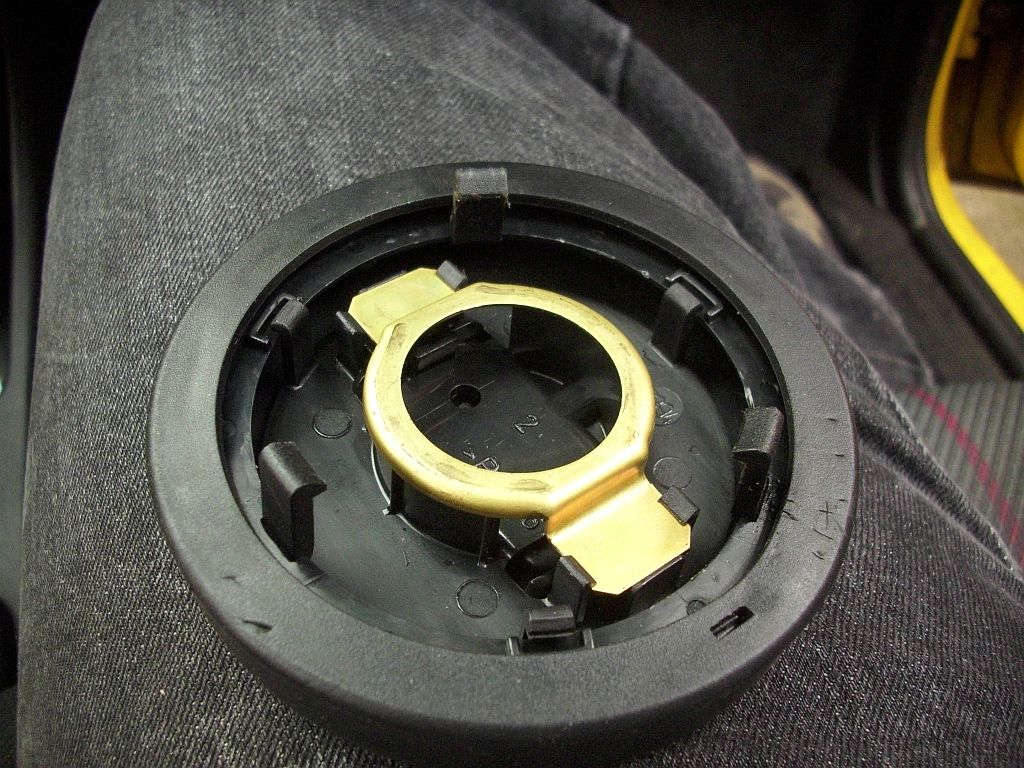

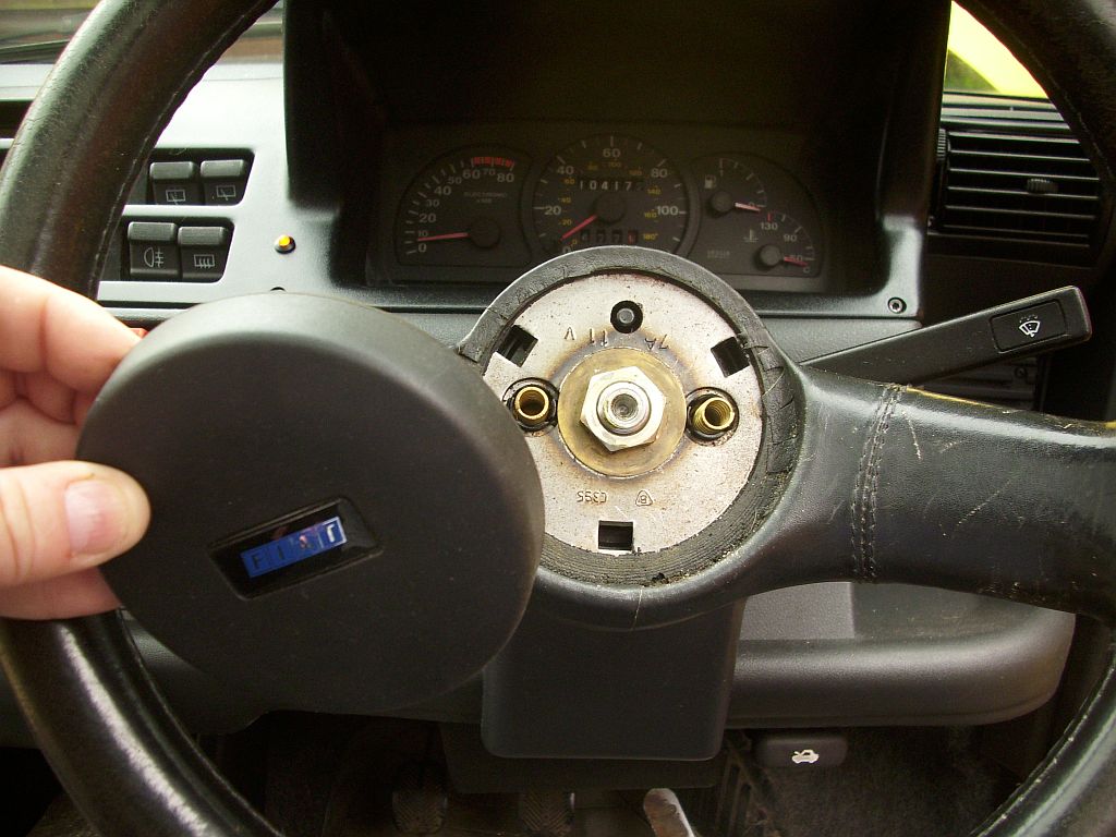

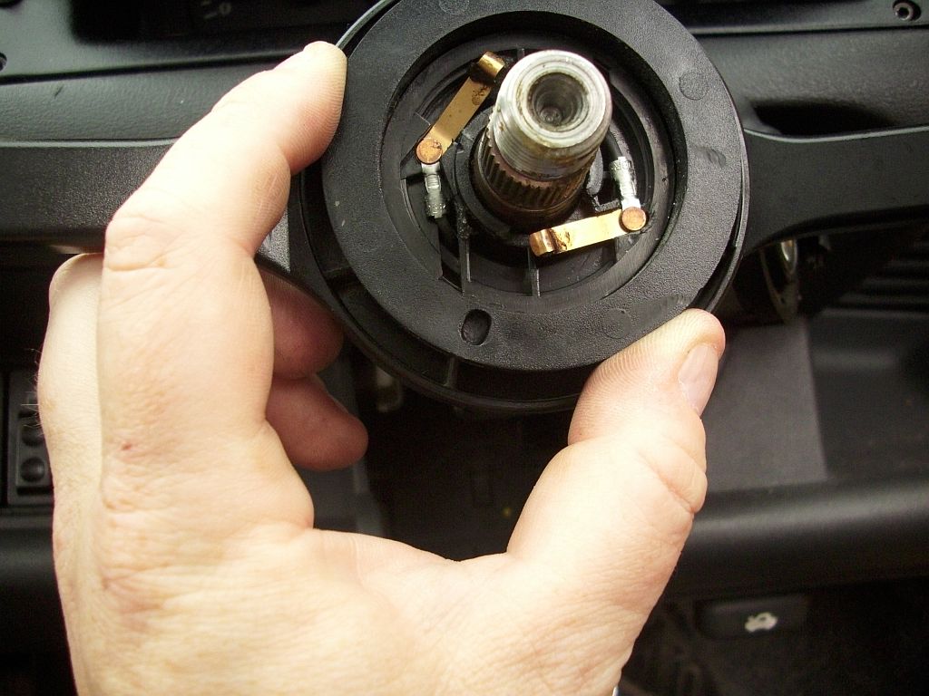

Lever off the steering wheel centre/horn push with a flat blade screwdriver, theres 3 clips that hold it in place

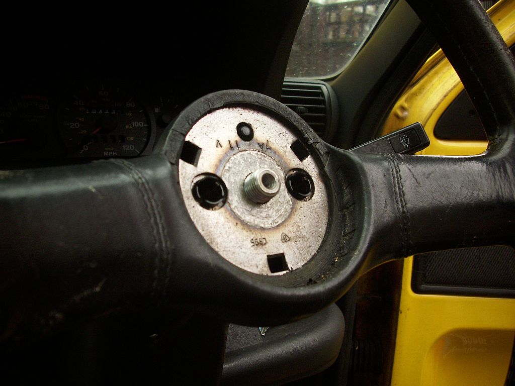

Remove the two springs, and undo the nut holding the steering wheel, I used a torque wrench for leverage but it came off really easy, unscrew the nut to the end of the thread, then tap the nut/centre column with a hammer and this will shock the steering wheel free, remove the nut and washer and pull off the steering wheel, a little wiggle and pull up, not too much force or it might hit you in the face.

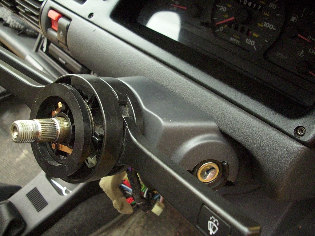

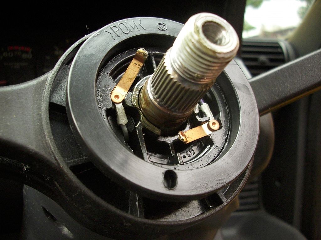

Make a note of the position of the "hole" in the indicator cancel ring for refitting

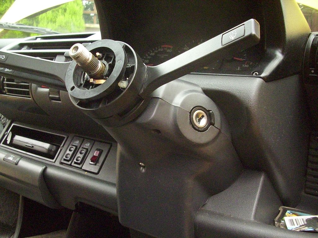

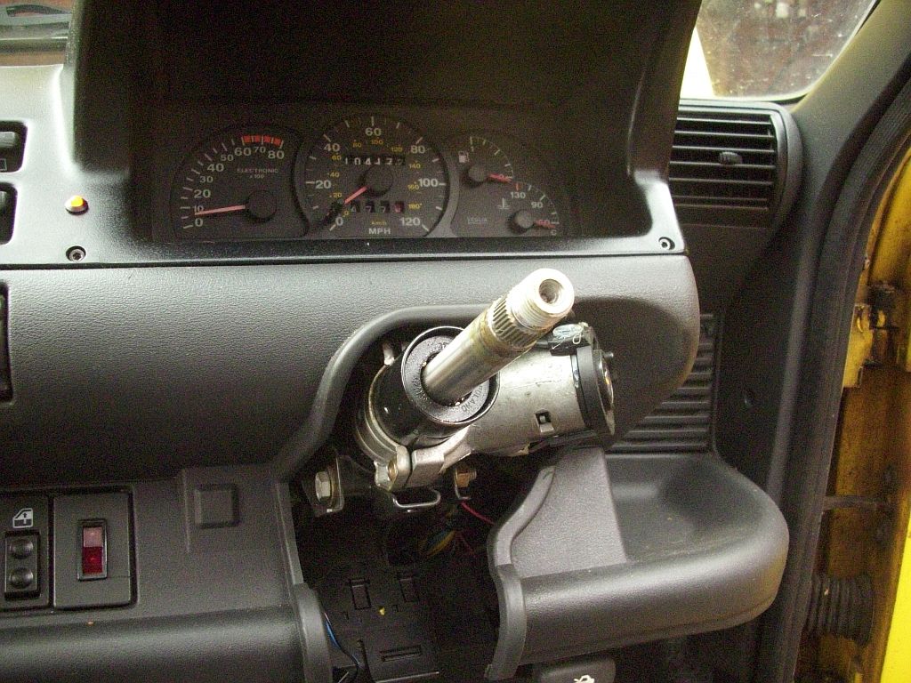

Undo the column covers, 3 screws underneath, then seperate the two halves to reveal the wiring etc

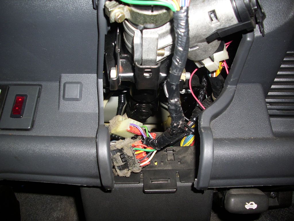

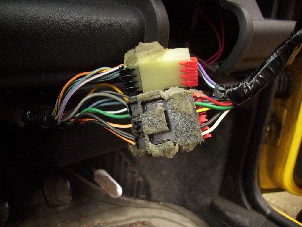

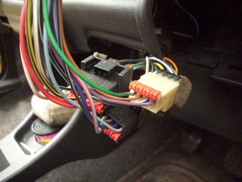

Pull out the wiring plugs from the dash
And undo them, you dont need to make a note how they go, each one is unique so you cant get them the wrong way putting them back

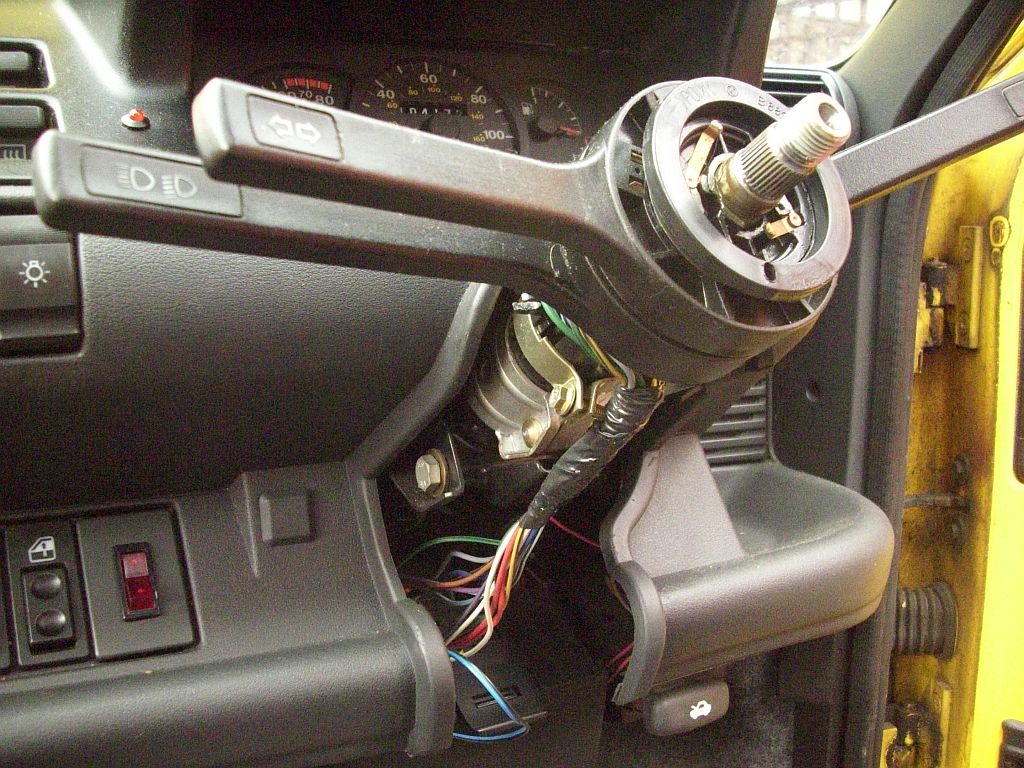

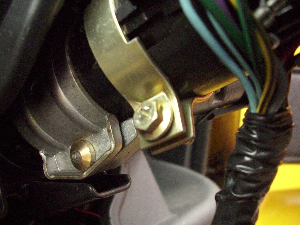

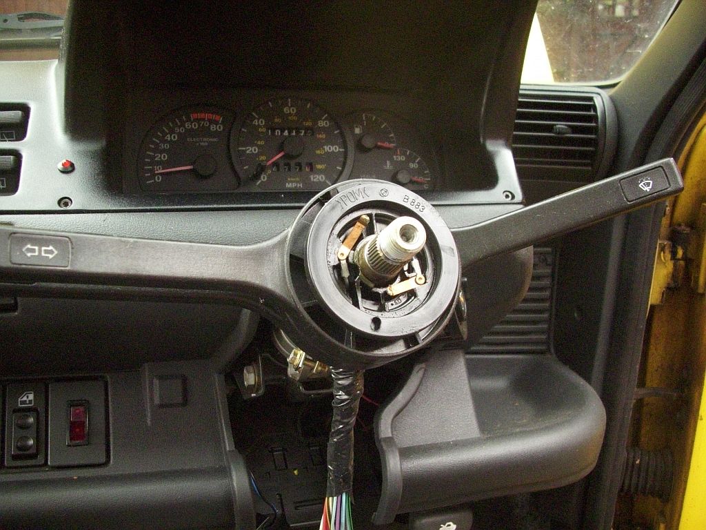

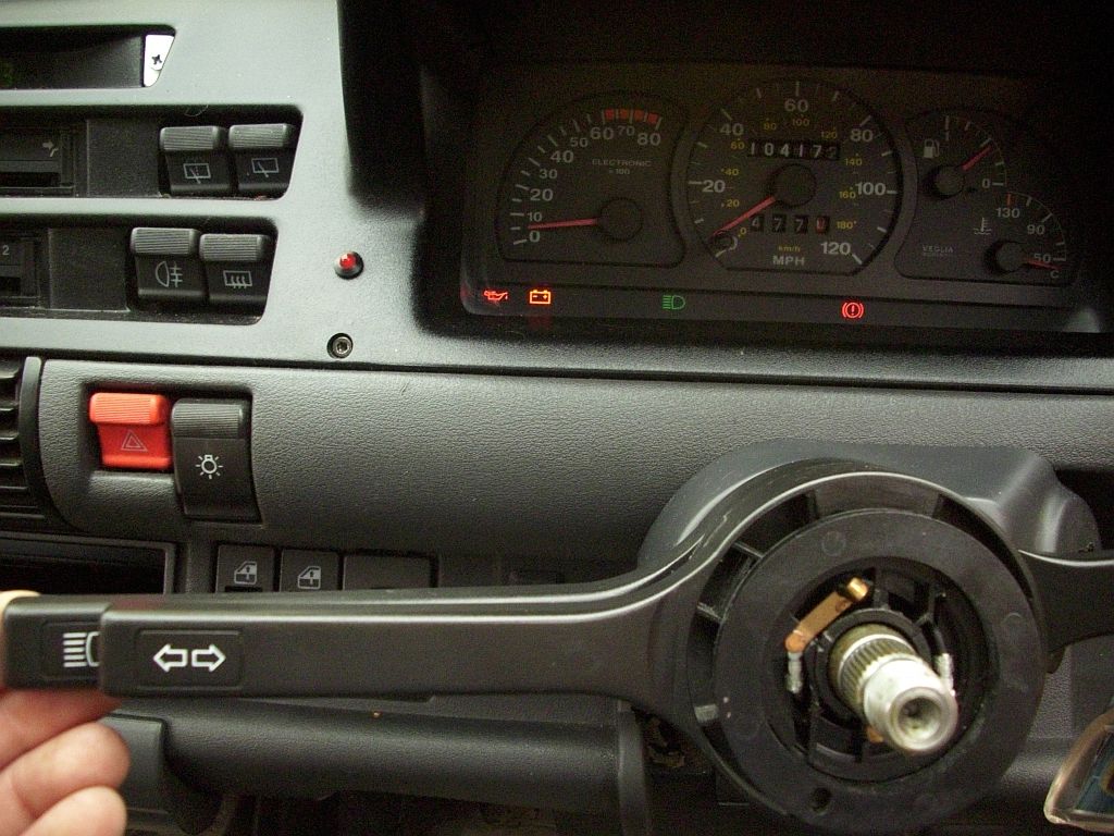

Now to undo the stalks, undo the 8mm bolt which clamps the stalks to the column, then pull them up over and off the top of the column

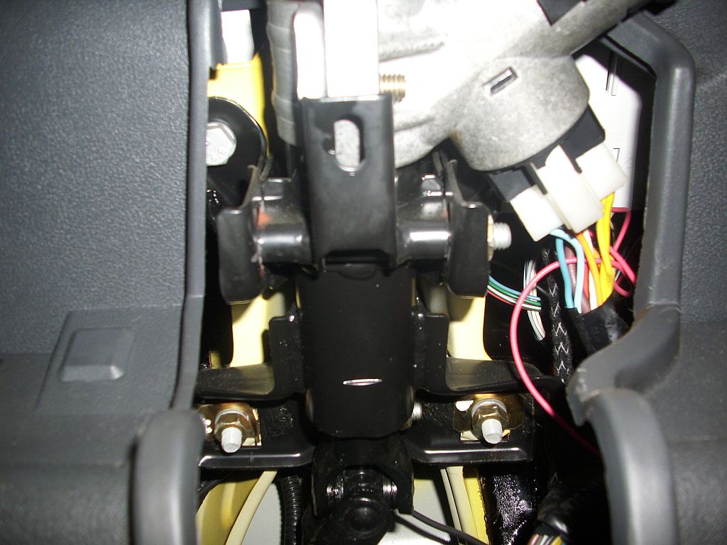

At this point, I thought I would check the tightness of the main column bolts, seeing as they are accessible, I just nipped them up slightly tighter.

Now set the indicator cancel ring
Reconnect the wiring
Push wiring back into the dash

Carefully refit the steering wheel making sure that the nipple behind it fits into the cancel ring
Refit the washer and nut, tighten to 50NM - or TIGHT if you dont have a torque wrench, I held the steering wheel with one had and tightened to 50NM with the other with ease
