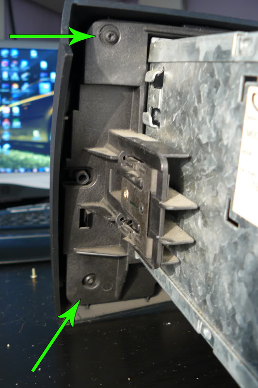

Having the HU out, you'll finde 4 Torx screws on the back face. 2 on each side.
After undoing the screws, the front face will be released BUT beware on the data cable still connected with the main HU.
Gently pull back to unlock.

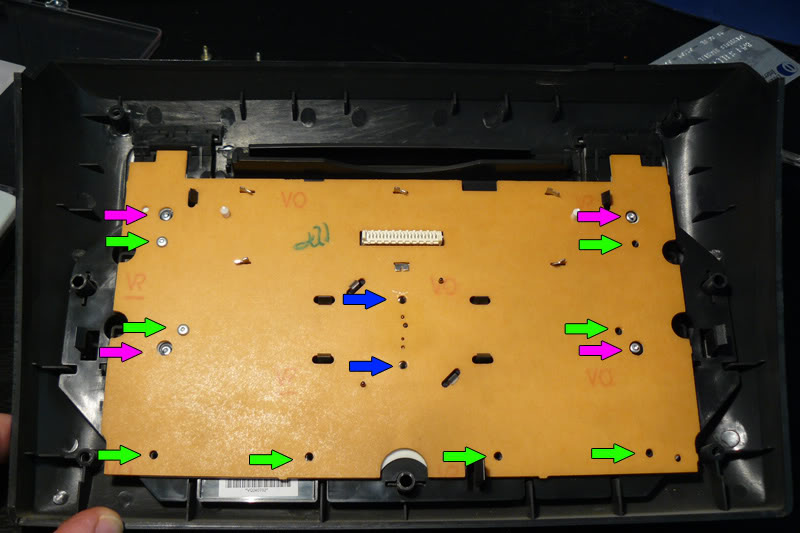

Now you can see the screws need to be undone on the back of the front face. :confused:
Attention: Each color is different type of screw! Don't mix them up!
Once all are undone, you get the circuit board off.

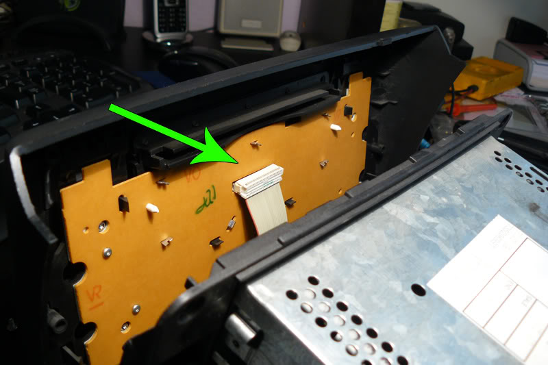

Back to the face plate you'll see this:
I suggest not to touch the little graphite buttons marked with the green arrow above. These are the "switches" that the buttons use and need to be clean and moisture free. If you wish, clean them with pure alcohol. (No! Not whiskey!):D.

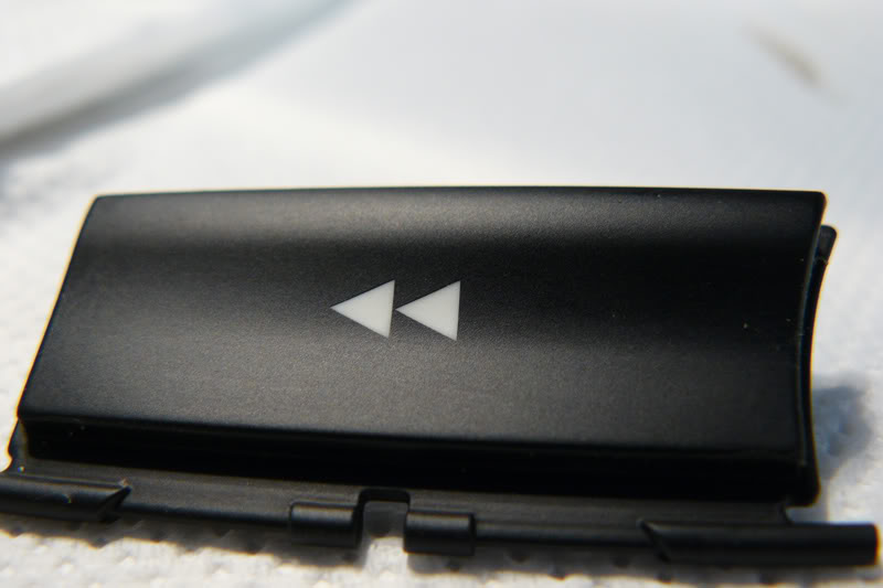

After having our buttons soaked, we take each one of them and start rubbing them with cleaning tissues and more window cleaner.
Needs patience and persistence.
If you are growing nails for any reason (i'm note here to judge :p) it's time to use them.
BUT try not TOO much cause you might rip off the black paint (see my 4 button)
Results:
Be patience, be persistent and you'll be rewarder!
