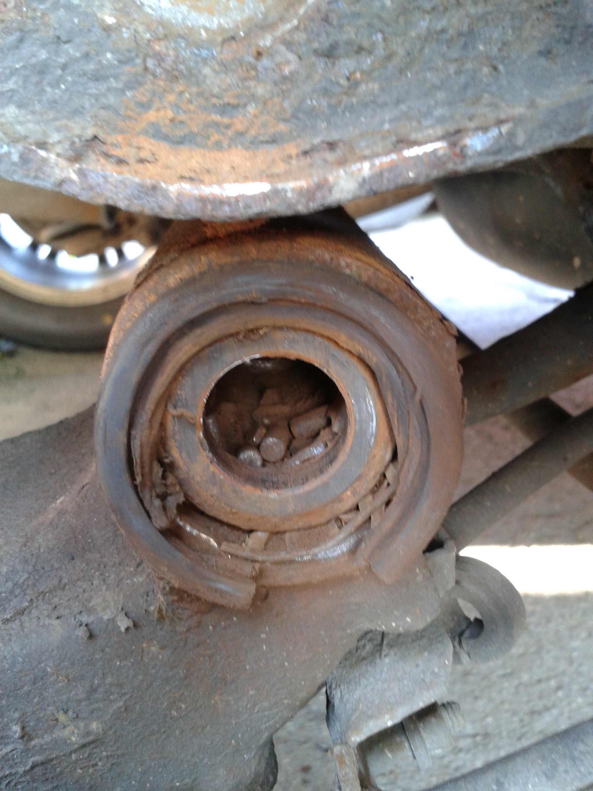

I only noticed that I’d got worn bearings by chance, I didn’t have the tyres touching the arches or anything and hadn’t noticed any clunks or any strange handling. Being Mr Stingy, I was just swapping the tyres front to rear after worn track rod ends had allowed the inner edges of the front tyres to scrub slightly.
I just happened to pull on the rear hub and noted an alarming clunk. About 5 mm of play on the arm. The other side wasn’t quite so bad but still showed some movement.

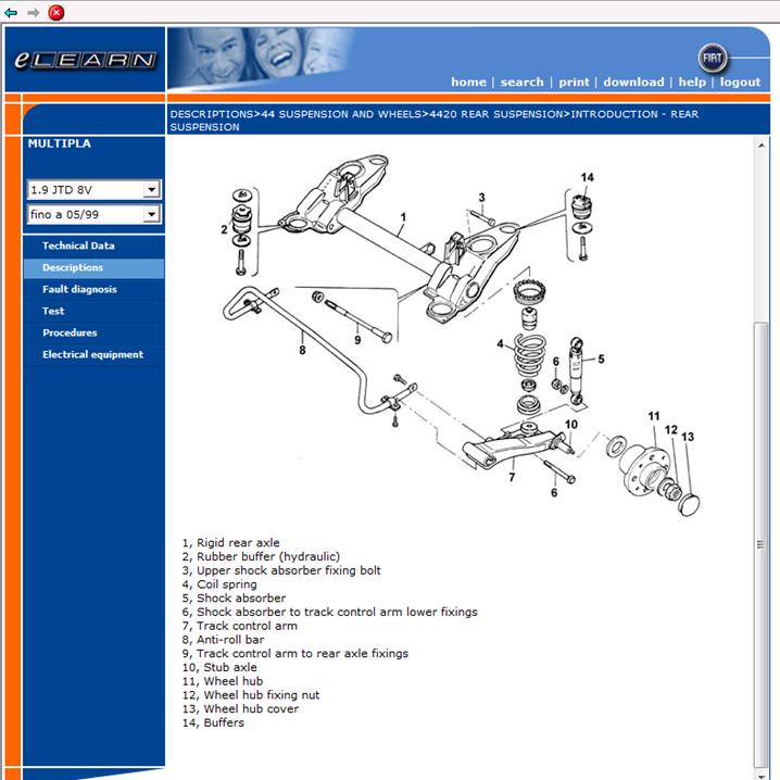

I did both of mine easily in the day – around 2-3 hours each, but now I know how, could maybe do them a bit quicker.
I had the car on the drive and was able to drop the arms far enough without disconnecting the brake pipes, handbrake cables and ABS and used the old pivot bolts to pull the new bearings, caps, seals and sleeve spacers into the arm. Reassembly was trouble free fortunately.
If you aren’t confident after reading these instructions, then don’t try it, especially if you have no one to turn to if you get stuck. A car with a worn trailing arm bearing is at least mobile and will get to a garage, but a car without the arm is expensive. Post queries if I’ve missed out anything obvious and good luck !

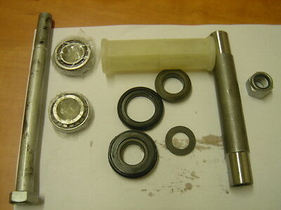

2 No. Bearing kits – mine were £ 40 each, and in stock at the local motor-factors.

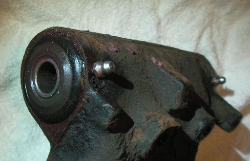

7. Examine the parts in the new bearing kit, in particular the steel sleeve tube so you can recognise it in the old assembly. Spray the exposed outer face of the old bearing seal, clean up with a rag and identify the end of the steel sleeve. Using a drift – I used the old pivot bolt and the lump hammer – carefully positioned against just the sleeve edge/end, a couple of sharp blows were sufficient to drive the inner seal out of the housing and the sleeve could then be withdrawn from under the car. The outer seal then virtually falls out on it’s own or with a small tap with the drift from under the car.

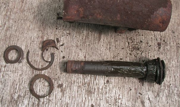

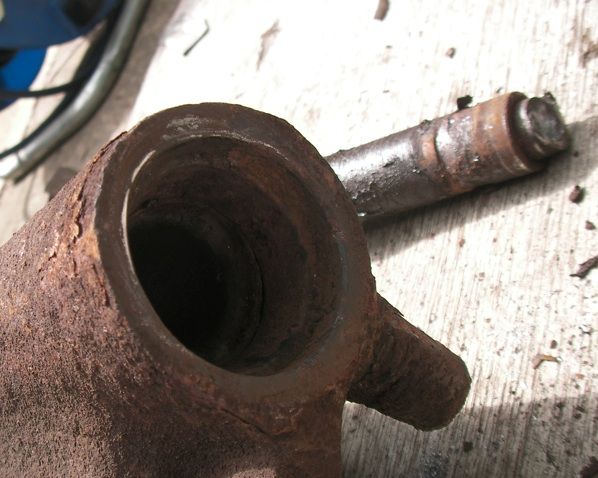

8. All that is left in the arm then are the outer bearing races and the white plastic lubrication sleeve between them. With the flat bladed screwdriver and the small hammer, I gradually worked round the sleeve end, smashing it off, then using the long nosed pliers, push the jaws into the arm, one inside, one outside the sleeve, and then twist the pliers to make it collapse enough to be pulled out of the housing. Clean up the bearing housing with WD40 and a rag and identify the small step between the bearing housing and bearing shell – this is where you’ll need the drift to strike, avoid running your finger over the sharp edges, they could slice a neat cut into your finger end as they did to me. At this stage a black plastic bump-stop cap from inside the lower end of the coil spring popped out – save it to re-fit later.
9. My initial reaction was – ‘S**t – how am I going to drive those shells out of there – this is where I’m going to have to call in help’. Then the ‘Keep calm – this can work out OK’ took hold. So, using the 25mm diam steel drift positioned at say 3 o’ clock on the shell, I took a couple of firm blows with the lump hammer, moved the drift over 9 o’clock and did the same again. Then I ran my finger around the housing (carefully this time) and was delighted to find the shell had moved a couple of mm. Repeating the process a couple more times pushed it right out and there was a pleasing plink as it dropped to the floor. The outer shell came out just as easily too. More WD40 and a rub with rags cleaned the old grease from the housings then I was ready for re-assembly. I always think at this stage, well I’ve done the hard bit now, the rest should be easier – fingers crossed, touch wood and the like.
