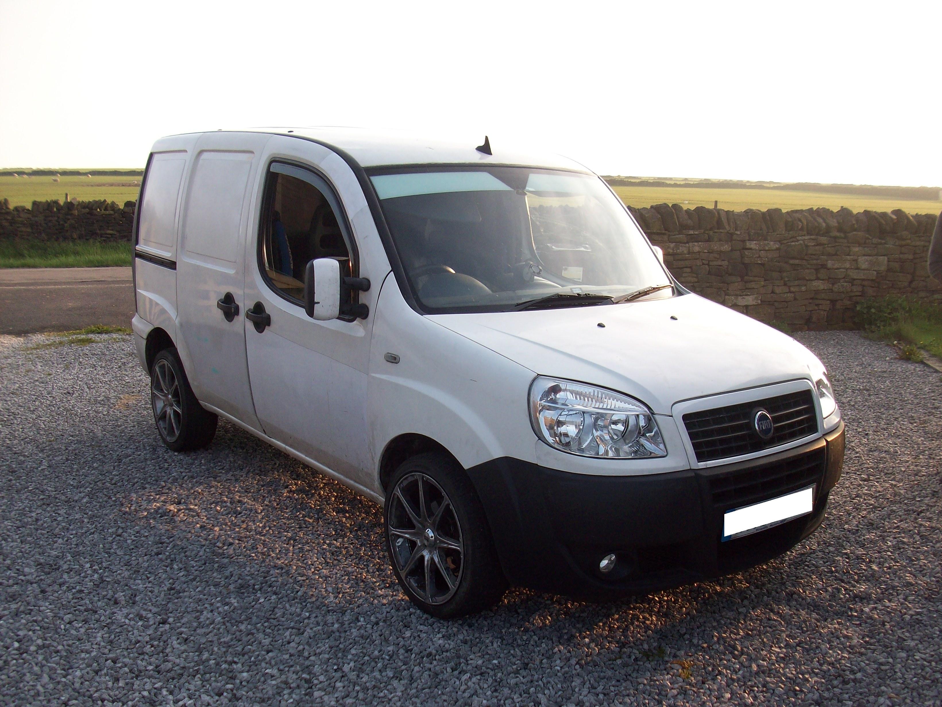

Well ive got the entire front end of a Mk2 Dobbin. i pick it all up at some point today, not a bad price really seen as though i bought it all together, i missed out on a Mk2 van the other day on ebay for 3hundred. engine block had cracked, just couldnt pick it up. spent a little more on just the front bits.
i think i need plenty of luck!!
:slayer:
5 and half hours later....
easy as 1 2 three really, well worth the effort, still needs a bit of alignment but overall WELL HAPPY!!
WOOHOOO!!! :slayer:
