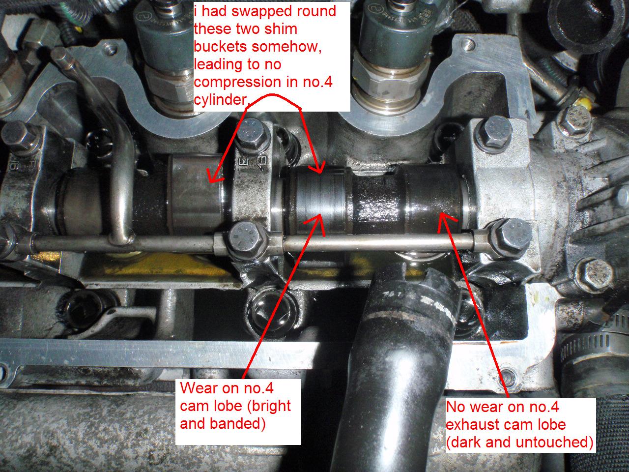

aha !aha ! aha !, :woot:
by the grace of God i found it !
sorry, calm down, :D
first, thank you Grahame, your help and advice is appreciated.
thanks for taking the time to reply :)
but there is another, more sneaky and trixy thing that can cause no compression...
yes, yes, my precious, we are talking .... shim buckets !
(if that is what you call them ? :confused:)
picture the scene, and sing
(to the tune of 'ten green bottles')
8 little shim buckets all in a line,
put one in the head,
and then there were 9, erm, 7,
7 little shim buckets all in a line,
and then there were....
you get the idea !
yes, i somehow swapped the exhaust shim bucket on cylinder no. 3 and the inlet shim bucket on no. 4 ...
resulting in a +1mm gap for no.3 exhaust valve,
and a -0.5mm gap (ie no gap, a constantly open valve) on inlet
which = no compression in no 4 cylinder !
(y)
the clue to this was in the wear on the low or 'back' part of the cam lobe.
as i checked for the valves operating correctly, i noticed that only one lobe had wear marks on the 'low' part of the cam (opposite the high lobe).
so, i did not have to strip down the whole engine,
i didn't need to send off the ECU just in case it was faulty,
etc etc...
horay !
i'll let you know if it runs when i get it all sorted... :D

so, i removed the cam cover etc,
swapped the buckets and shims,
rebuilt again,
and...
ta da !
10 psi compression... really, 10 psi !
ah, what can this be ....? hmmmm..
ok, check clearances again...
ah, no clearance on inlet cyl no. 4.
but all the other 7 valve gaps are ok.
double checked.
so why the lack of a gap?
quick review of what i've done...
ah !
i lapped the valves in, and one of them was worse than the others, this one!
so, lapping the valves in reduced the clearance, and the 4.05 mm shim is now too thick.
simple.
should have thought of it earlier, but i haven't rebuilt an engine for about 15 years,
so i'll cut myself some slack, just a bit
and hey, it makes it more interesting for you guys reading, sniggering along with me
so, just been and bought a 3.50 mm shim to enable me to gauge the gap and calculate the correct size i need.
made a shim bucket tool out of an old allen key so that the cam can stay installed, saves time - well probably takes the same time as making the tool, but hey, it's more fun making stuff...
i'm working over the weekend 'til tuesday, so i'll get stuck in then, and update here when i've progressed.
austin

Easily done swapping shim buckets round.. or was it just the re-cut of the valve that caused the problem? ;)
it was both! :)
i had swapped the shim buckets round and i had lapped in the valve on the no.4 cylinder.

hi there,
all those of you who have been reading this mini epic (for me at least!)
a 3.60mm shim finally sorted out the problem.
the engine now runs smoothly, has lots more power and smokes much less.
i hope that the economy will be improved now too, because i found the valve timing to be out by one tooth.
very pleased.
