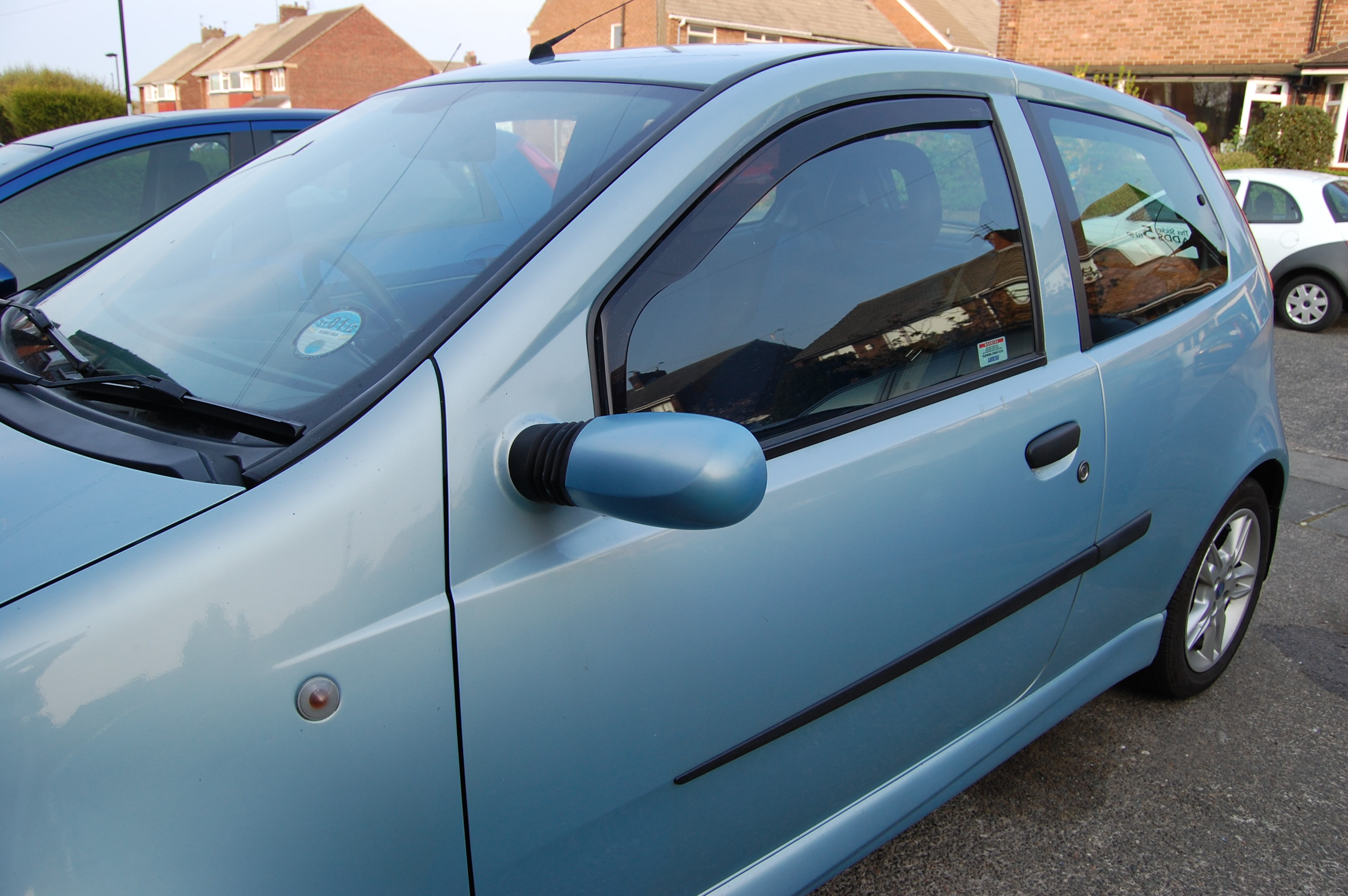

I've got some (pics attached to this post)

EDIT: Pics later, neither gallery nor attachments are working for me. And god forbid that I upload to an external host
Uploader now working. Image attached. Click for larger

It's just taken me less than ten minutes to fit mine (from Towequipe, through Amazon); including the really difficult bit... -- which for me, was peeling the blasted backing paper off...! (If you're going to be fitting wind deflectors, please don't trim your fingernails the night before.) :(
Other than that -- as others have said -- really simple! And I think they actually look quite subtle: especially as they aren't that much proud of the doors. Even the tint doesn't jar -- probably because of the amount of black (window seals; rubbing strips; tyres, etc.) that's there already.
