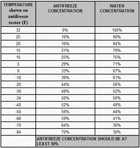

It's advisable to use Distilled water when changing coolant as tap water will create 'furring' in the cooling system, possibly blocking up smaller coolant galleries over time.
Concentrations vary depending on manufacturer and application but are generally between a 40%-60% mix. Altho Some coolants for colder climates may have a stronger mix of 70%-30% which can offer protection down to -64*C (-84*F) Make sure you check the bottle to ensure correct concentration for that particular coolant in your climate.
this is a rough guide to coolant concentrates and should be used for information only every coolant differs so make sure to read the bottle before starting.
