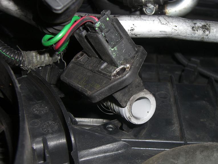

The fan slow speed is achieved by the car putting this 1ohm resistor in the circuit to the fan motor. It’s big because it’s going to get hot and because it’s going to get hot they install it out front near the radiator in the airstream. There a two relays T6 and T7 which switch on the rad fan slow or fast speed setting
OK so I think the fan slow speed isn’t working and I want to check the resistor.

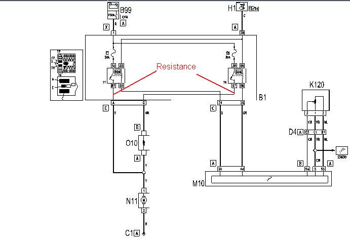

It’s a pain to get access to the connectors and I can’t pull off the connectors with the restricted space so I look for an easier way to test the resistor from the wiring diagram
I can check for the 1ohm resistance at the engine bay fusepanel by checking across both the pin 87 on relay positions T6 and T7. Crafty eh!

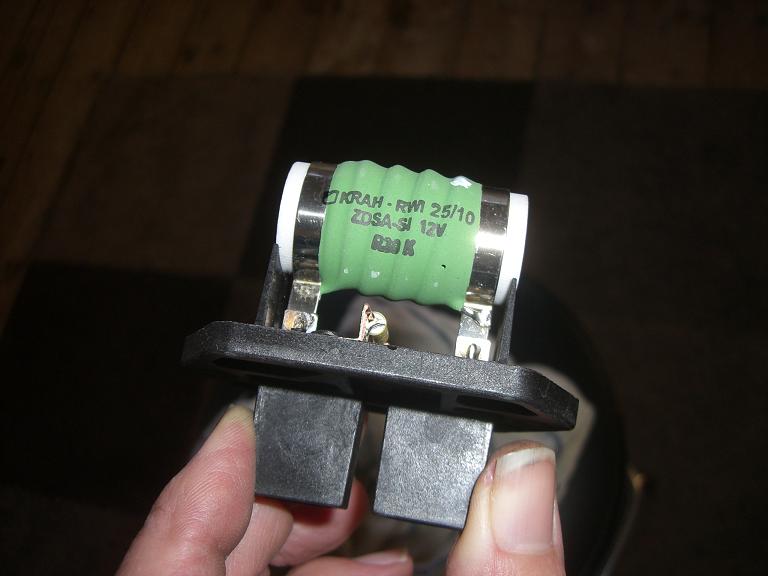

Then lever back the plastic clips to release it and the resistor is out. I left the wires attached as it would be easier to remove them now.
We can see the problem of a broken resistance wire.
