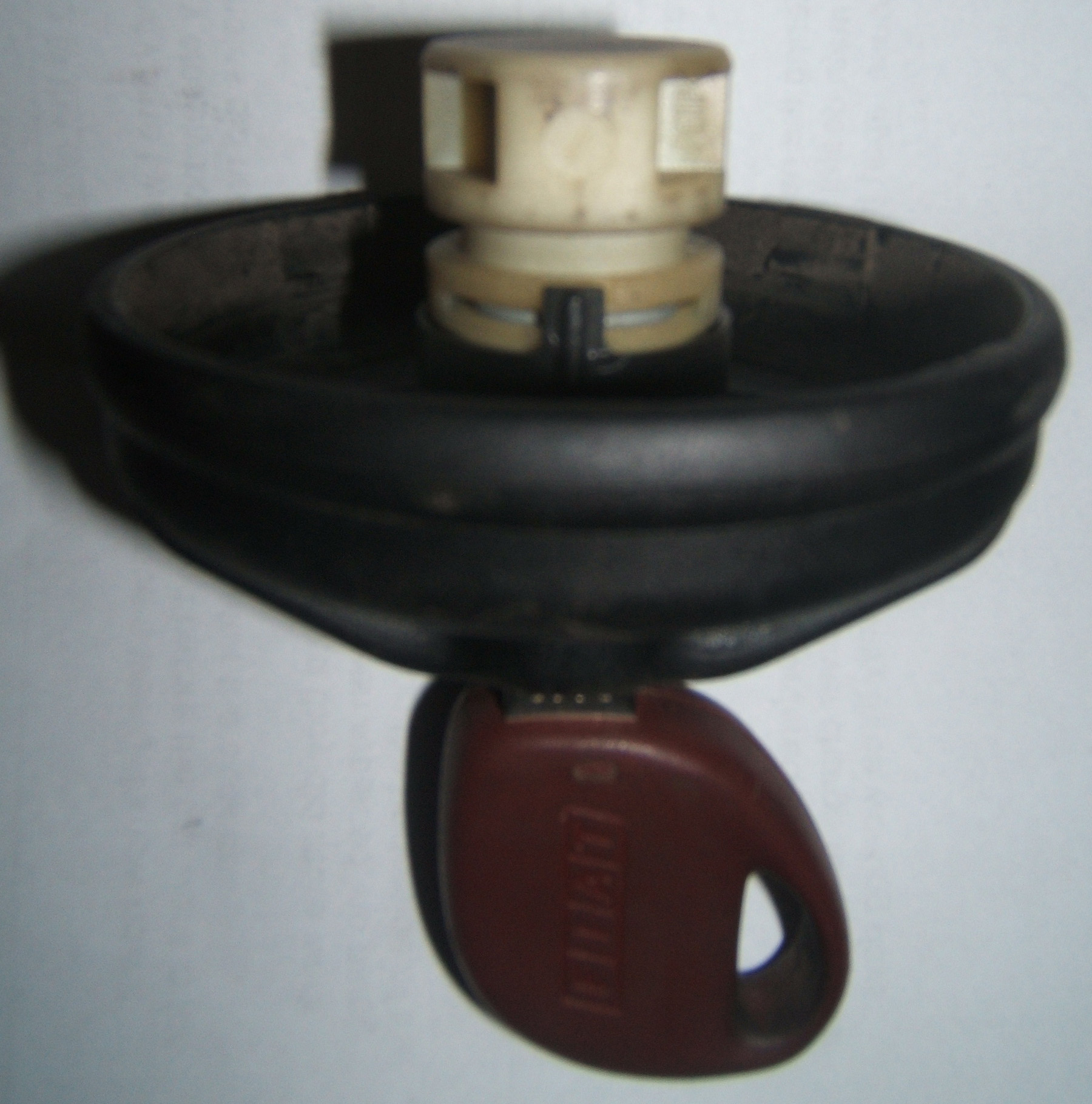

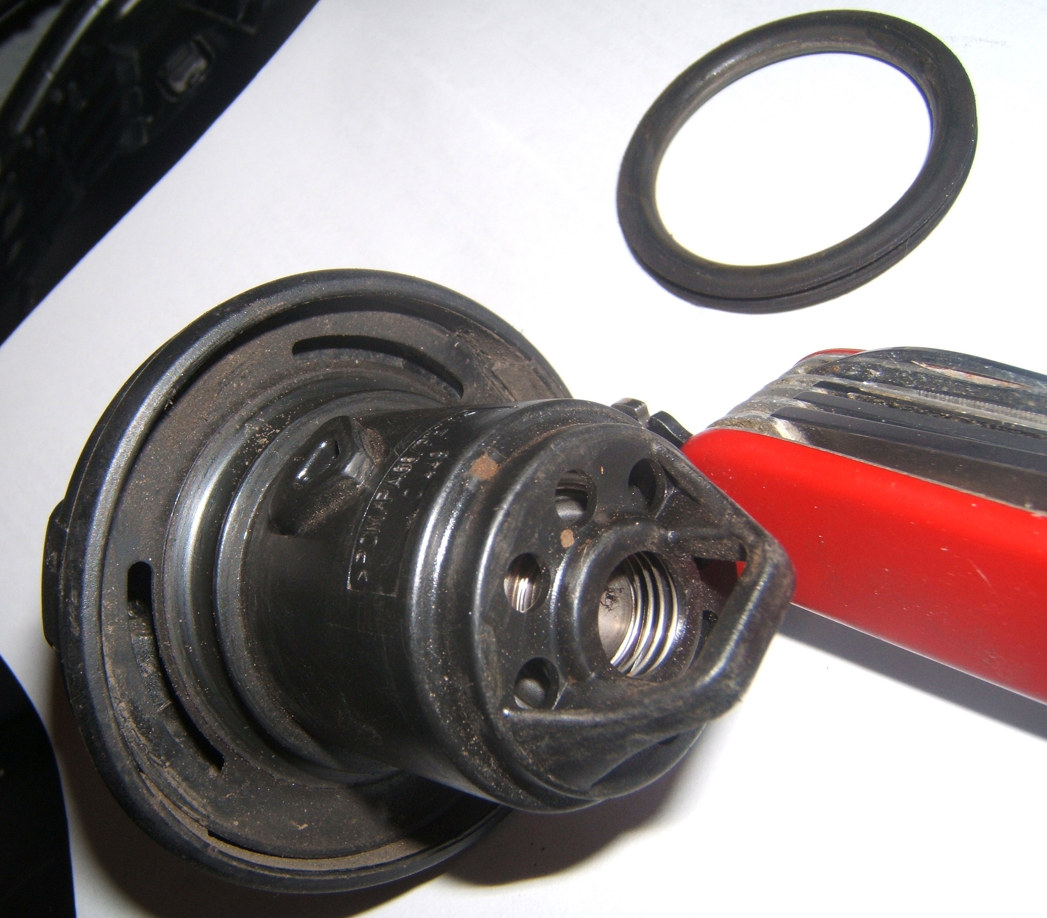

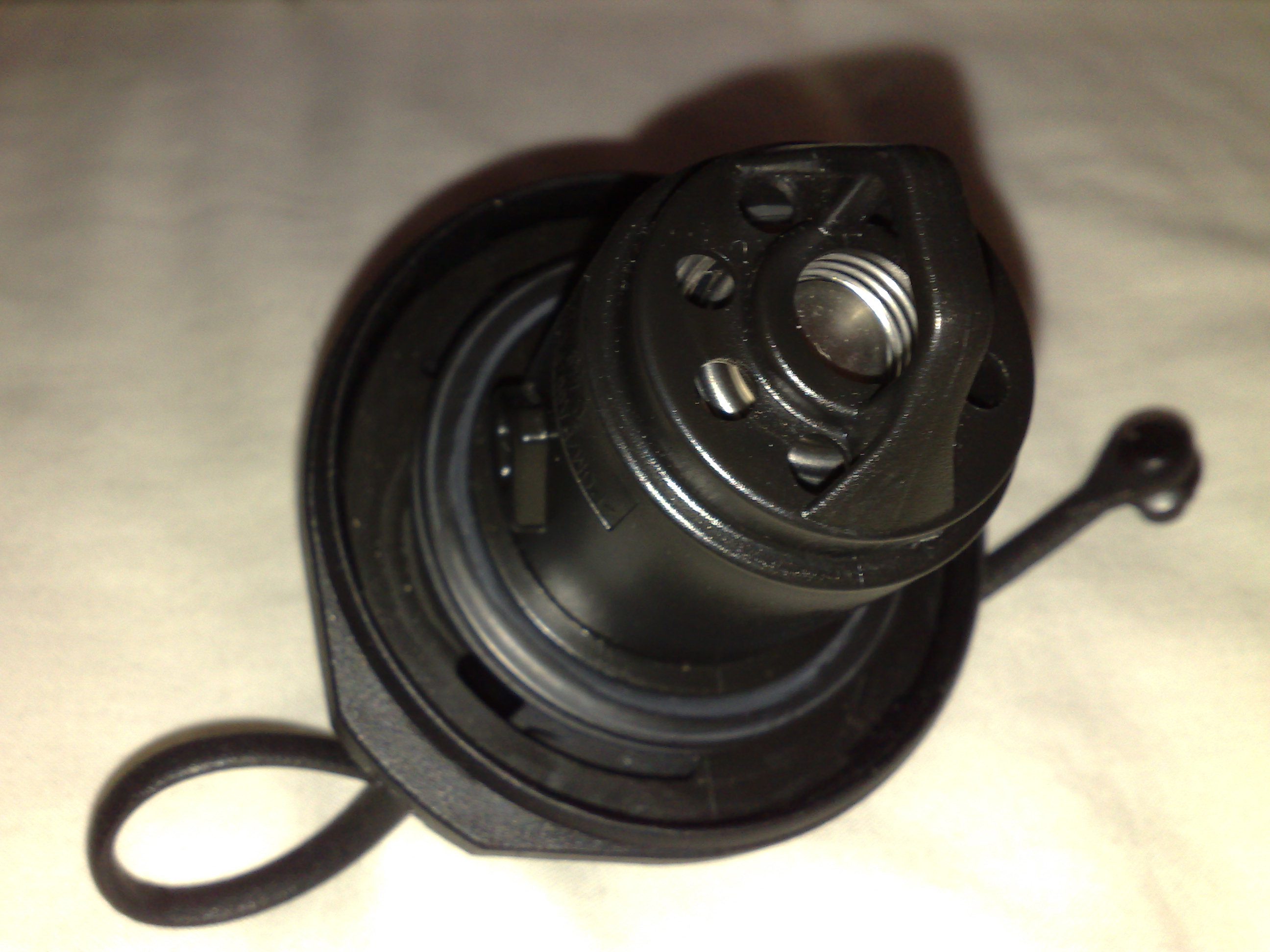

I ended up with one of these filler caps. It is extreamly easy to dismatle, I only used a swiss army knife. Basicaly if you look at the back of the cap at north, south, east, and west there are four clips holding the back of the cap onto the front. If you zoom in on joske's photo and my pictures you can make them out.
Carefully prise each clip off the back of the cap and its seperates.

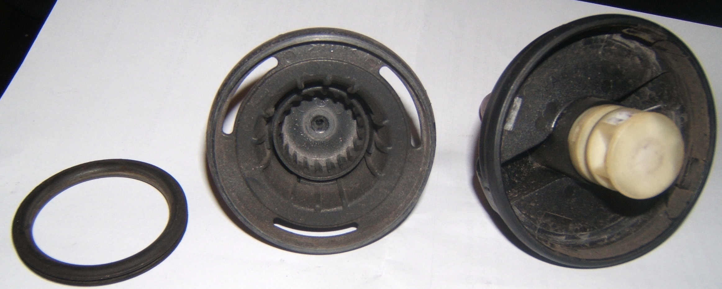

At this point you can pull the white barrel retainer out. It is held in with a single plastic clip and is stiff but pulls right out. Again leaver the clip off and pull.
Pull the lock barrel retaining pin out, and ever part is now sat on your desk
As I guessed in my previous post you can just push a replacement lock barrel into the housing.
